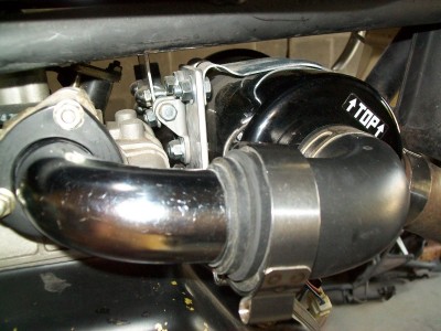

Chrome sink drain pipe into the supercharger accumulator. Total cost $.50. It would also accommodate a K&N filter mounted directly onto the pipe and facing forward.

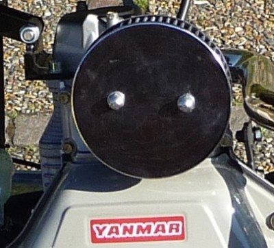

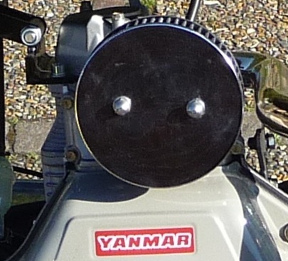

Many for the suggestions, ended up going with a k&n su filter, its a lot louder, but at higher rpms it sounds great!
Needed a bit of modifications for the screw mounts and the cork gasket, all good otherwise.
Bit more poke too, all good!

Is it a 1 and 1/2" or 1 and 1/4" dia. SU filter that fits the intake? Thanks for further info.
Re: L100 air intake
http://www.knfilters.com/search/product ... od=56-9155
This is the one I have. I managed to use the gaskget it came with but I did need to widen a few holes and cover some holes with glue that wasn't covered by the filter.
