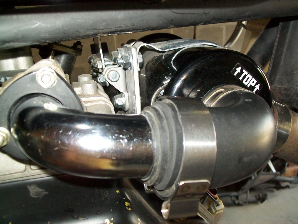

Re: L100 air intake
Chrome sink drain pipe into the supercharger accumulator. Total cost $.50. It would also accommodate a K&N filter mounted directly onto the pipe and facing forward.
