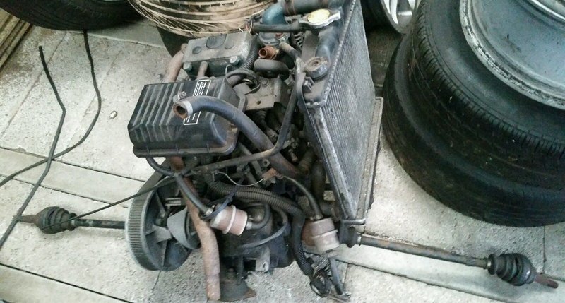

That engine model appears to have a gearbox driven by the CVT. Gearbox probably also has a reverse.

It has indeed and that is exactly the same as the French microcars.coachgeo wrote:That engine model appears to have a gearbox driven by the CVT. Gearbox probably also has a reverse.
It's a simple forward/reverse and houses a diff.
You can just see the gearbox on this Aixam example below the centre fuel filter and the shafts either side.
http://www.ebay.co.uk/itm/COMPLETE-ENGI ... Swf-VWbuv7
Possibly the diff could be locked up and a chain run from either side or with the engine turned sideways shaft drive could be employrd?
Useful on a heavy bike for reverse or a sidecar??
Re: Lombardini CT Move engine
for future reference. Here is pic from ebay ad mentioned above
