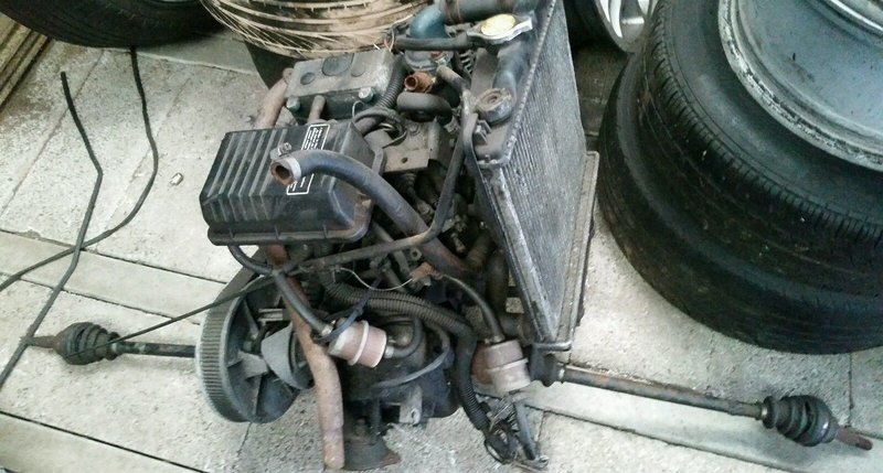

You can just see the gearbox on this Aixam example below the centre fuel filter and the shafts either side.
http://www.ebay.co.uk/itm/COMPLETE-ENGI ... Swf-VWbuv7
Possibly the diff could be locked up and a chain run from either side or with the engine turned sideways shaft drive could be employrd?
Useful on a heavy bike for reverse or a sidecar??
Re: Lombardini CT Move engine
for future reference. Here is pic from ebay ad mentioned above
