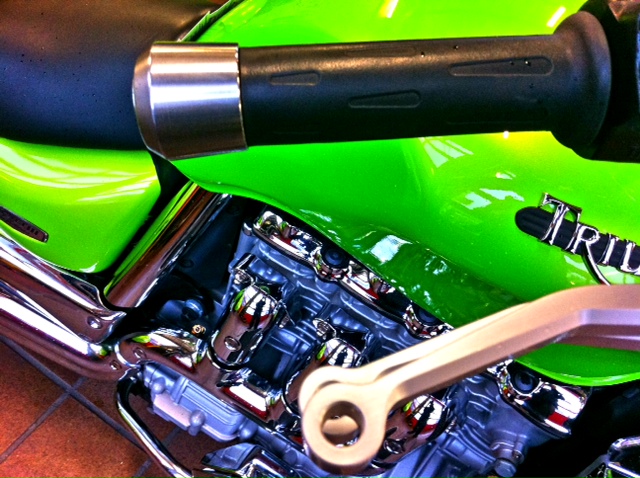

I spotted these on a Rocket 3 the other day. Slightly different shape so maybe different weight? Whatever, Triumph seem to like these :wink:

A bit late to the game, but I;ve filled andle bars with lead shot to dampen the vibration, works better the more shot you put in. It increase the mass thereby lowering the frequency to a level that wont give you white fingers.

I may still look out for Rocket 3 bar ends though as their heavier construction maybe just the thing for low frequency vibes.
