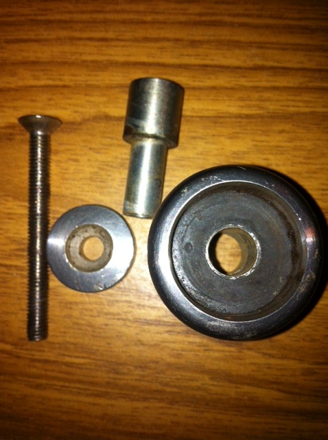

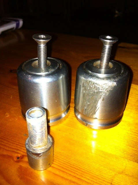

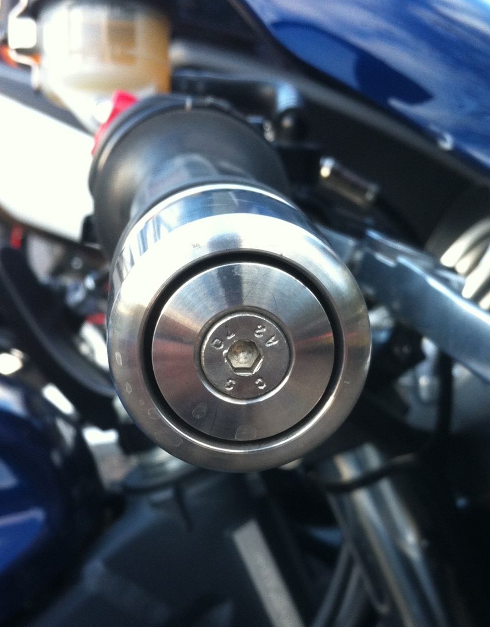

I've done the following...
Luckily I now ride a triple and so not much of a problem but I have managed to wipe it out almost completely and at little cost. Here's how...

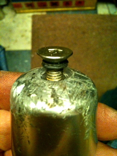

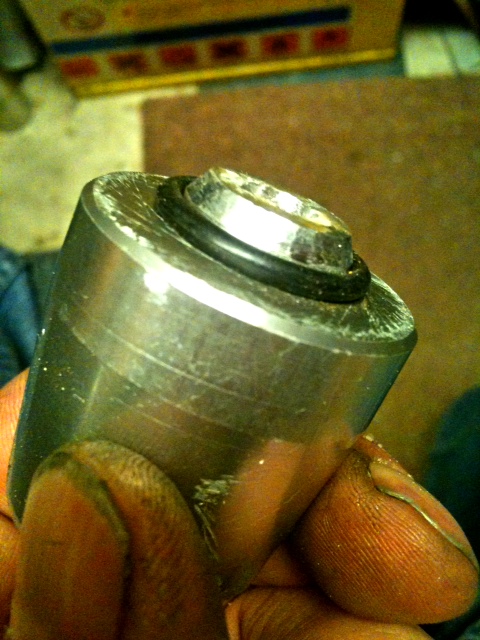

Basically I used the (quite) heavy bar ends as a counter weight to the vibration. I enlarged the centre screw hole by about .3mm (but screw was already quite loose in there) then I put a chamfer on only half the end that fits into the bar, covering the other half with an O ring.
At the (countersunk) screw head end I inserted a 9mm drill (that was the diameter of the small O ring once it was over the screw) and lightly touched it to create a seating bed for said O ring.
When I assembled to whole thing I tightened the screw almost but not quite, all the way in thus leaving the bar end with both front & back movement against the two O rings. This alters the dynamic at the end of the handlebars meaning the bar end can move and dampen the vibration. It works better than I thought
And the bonus is, of course, that it can be put back as was by simply removing the O rings

Hey Stuart, you re-invented the dynamic absorber!
This is a standard vibration control technique, where a system with a resonance at a given freq is controlled by the addition of a sub-system with resonance designed to occur at the same frequency. If you do it right, the new sub-system generates large reaction forces against excitation at the frequency of interest, effectively stiffening the whole thing up. You can think of it as presenting a high mechanical impedance (Force/velocity) at the design frequency; this puts a big dip in the velocity response of the main system, right at the original system resonance - effectively splitting it into two subsidiary resonances, both of lower amplitude.
Some bike footrests and bars come with this stuff installed. As part of my job I once tried to design an impact drill on the same basis, but frequency turned out to be much too high for an effective solution.
Getting the frequency right is tricky without access to accelerometers and frequency analysis equipment...

Stuart , what would you estimate the weight of those bar ends at ? 50 gms each ? I'm assuming no more than .5 mm movement ?
Stuart wrote:I've been reading some other forums out there lately and seeing how many riders of big petrol powered bikes suffer from vibration. My old Ducati gives me a tingle as wellI've done the following...
When I assembled to whole thing I tightened the screw almost but not quite, all the way in thus leaving the bar end with both front & back movement against the two O rings. This alters the dynamic at the end of the handlebars meaning the bar end can move and dampen the vibration. It works better than I thought![]()

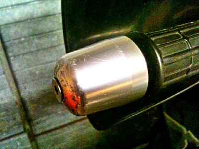

Re: A cure for vibration white finger
It's taken a while but I talked to a guy today who told me his Triumph Sprint has these 'isolator' style bar ends as standard. He said they were 'well flexible'. I can only presume Triumph fitted these for a reason
Anyway, next time you're in the bike park somewhere and see a Sprint, home in on it to confirm

Actually got my hands on a Sprint barend today and yes, they are exactly just what we thought
Owner tells me Triumph did have a vibration problem with that bike. I may try and get a pair from the breakers.

These just turned up from eBay (minus one insert
). They weigh 250g each and have a 22mm dia recess handlebar side. The rubber inserts look in good condition and up to the job. A little something to play with anyway
