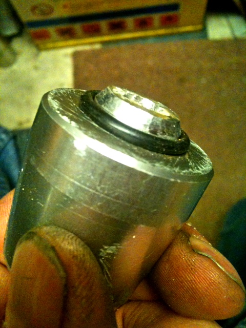

Basically I used the (quite) heavy bar ends as a counter weight to the vibration. I enlarged the centre screw hole by about .3mm (but screw was already quite loose in there) then I put a chamfer on only half the end that fits into the bar, covering the other half with an O ring.

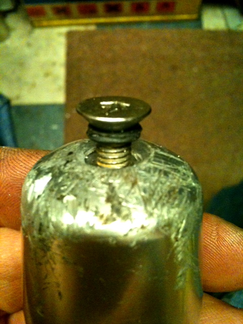

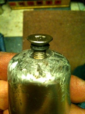

At the (countersunk) screw head end I inserted a 9mm drill (that was the diameter of the small O ring once it was over the screw) and lightly touched it to create a seating bed for said O ring.
When I assembled to whole thing I tightened the screw almost but not quite, all the way in thus leaving the bar end with both front & back movement against the two O rings. This alters the dynamic at the end of the handlebars meaning the bar end can move and dampen the vibration. It works better than I thought :!:
And the bonus is, of course, that it can be put back as was by simply removing the O rings 8)
The Mod at the bar mating end.

The Mod at the Screw head end.

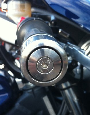

Finished article
Finished article

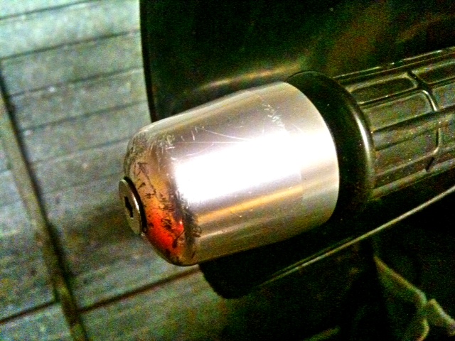

Here's a closeup of a Sprint Bar-end. Looks promising :D
Looks different from the usual bar ends you see. The telltale circle says all methinks.

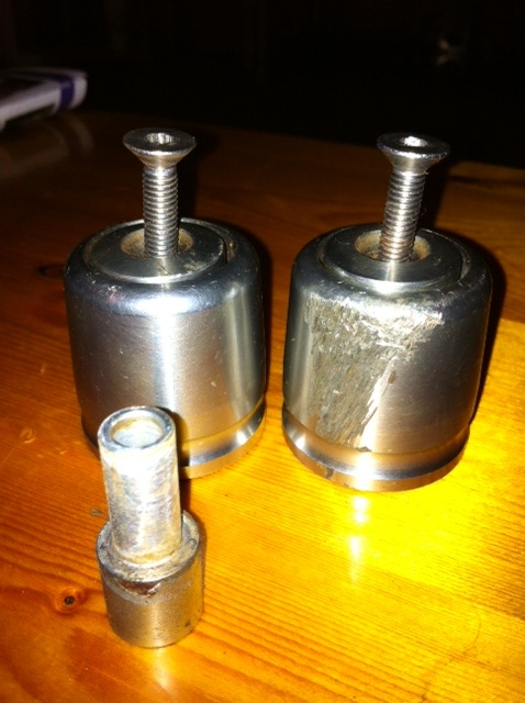

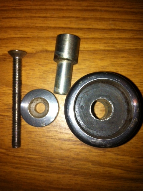

These just turned up from eBay (minus one insert :? ). They weigh 250g each and have a 22mm dia recess handlebar side. The rubber inserts look in good condition and up to the job. A little something to play with anyway :D
broken down.
broken down.
As they arrived.
As they arrived.
