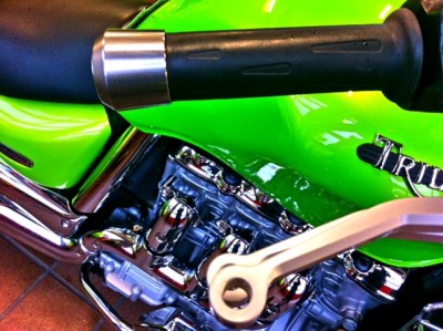

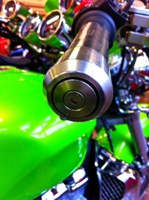

I spotted these on a Rocket 3 the other day. Slightly different shape so maybe different weight? Whatever, Triumph seem to like these

I may still look out for Rocket 3 bar ends though as their heavier construction maybe just the thing for low frequency vibes.
