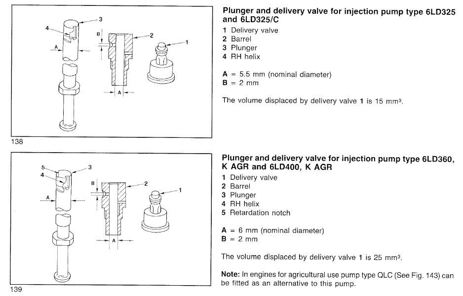

Some time back we had a discussion about adding variable injection timing to the simple jump pumps used on static diesels.
To my surprise I saw the follwing when reading through the Lombardini manual for the 6LD series engines:
Now note on the second type of pump there is a 'retardation notch' on the pump!
The AGR denoted engines this was fitted to were the Agricultural type motors.
Interesting post Dave, well picked up on mate. I'll have to try and find a whole exploded view of the complete assembly to see exactly how they retard the plunger etc.
It would be good to have some sort of variable timing on these one cylinder engines. My ole thing is timed for top end speed, so its really rattly and knocky low in the RPM's.

I might see if the pump with the retard notch and matching injector are still listed as spares - might prove a useful upgrade.

The retardation notch is shown on:
Page 44 - Diag No. 139
Page 45 - Diag No. 142
Page 46 - Diag No. 144
After speaking with Lombardini suppliers in the UK the AGR type pump was only specified for the 325cc model.
It's not a sophisticated system, it just allows half timing for the first half if the rack movement. Reading through the manual is was specified for some of the engines required to pass EEC noise regulations so I'm guessing it will quieten the idle.

You may have the automotive type springs/plunger assembly as there will only be 2 speeds required in the application you describe, idle and 3000 rpm, I doubt very much if the injector pump will have the retard notch as it would never have needed the extra low rpm torque and smoother idle that this would provide.
I had a long think about rigging a manual adv/retard unit a while back and could only come up with a huge screw thread into which the injector pump could be mounted and raised/lowerd to alter the timing. Other thoughts about applying variable cam timing seemed hugely complicated too. - hence the retard notch on the plunger seems too good to be true but this operates more simply, anything below 1/4 fueling is retarded and above this full advance - it's not RPM dependent.
