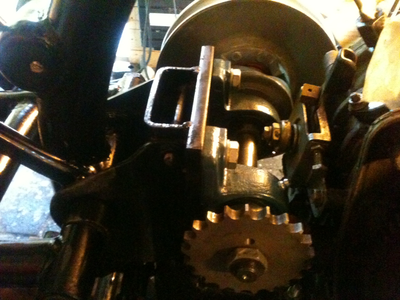

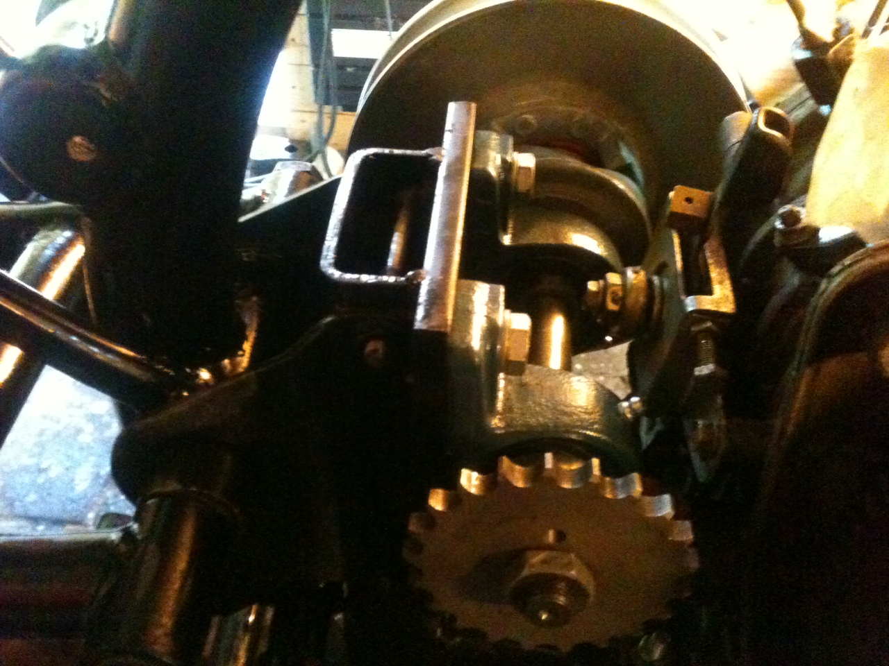

There is nothing against flexible mounting in the MZ frame. you do however have to be very stringent about how close you build it together as the space between front of engine and front mudguard will be minimal.
bottom mounting in TS frame
As you can see the mounting is quite a snug fit, allowing to use a standard TS frame, only frame mod is to cut off the part holding the footrests, placing them under the new motor mount
