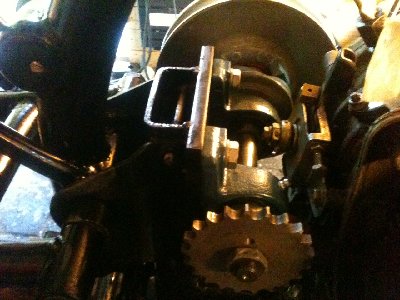

There is nothing against flexible mounting in the MZ frame. you do however have to be very stringent about how close you build it together as the space between front of engine and front mudguard will be minimal.
As you can see the mounting is quite a snug fit, allowing to use a standard TS frame, only frame mod is to cut off the part holding the footrests, placing them under the new motor mount

I've now been on the Road for a wole season, covering in exces of 5000 km, no frame isses what soever, might have something to dó with the rubber mountings

Hmm quite a bit longer than originally stated. However, must say, there should be no ruptures in tha frame at all
