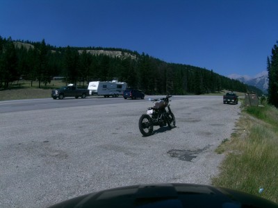

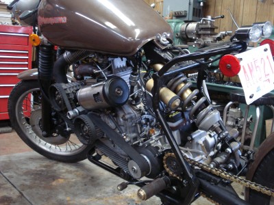

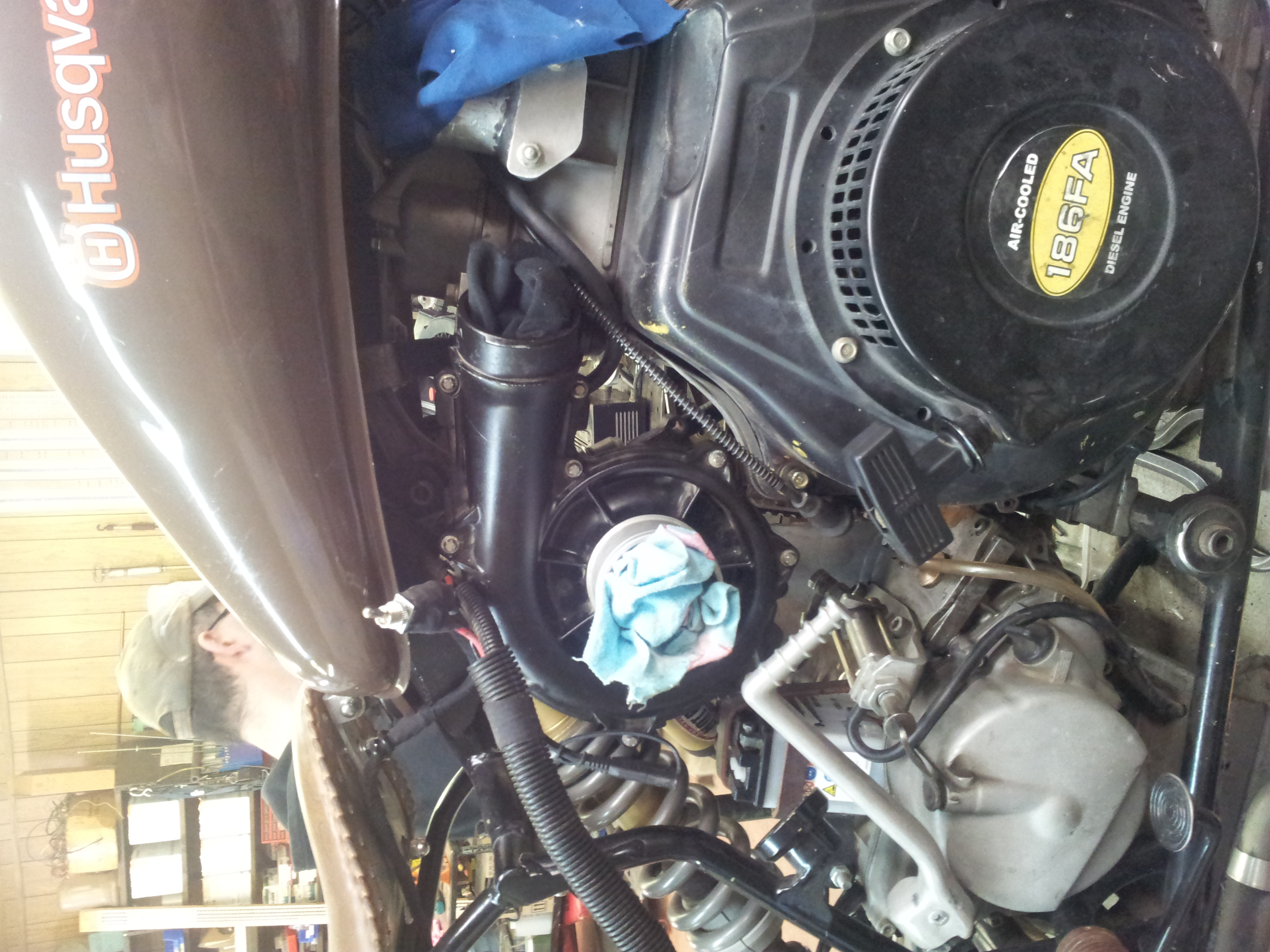

well, here it is finally. it works and seems to be reliable enough and its very fun to ride." miles with smiles " right. the building was fun and challenging but the riding is way funner.

Nice bike you've got there.
What gearbox did you use?

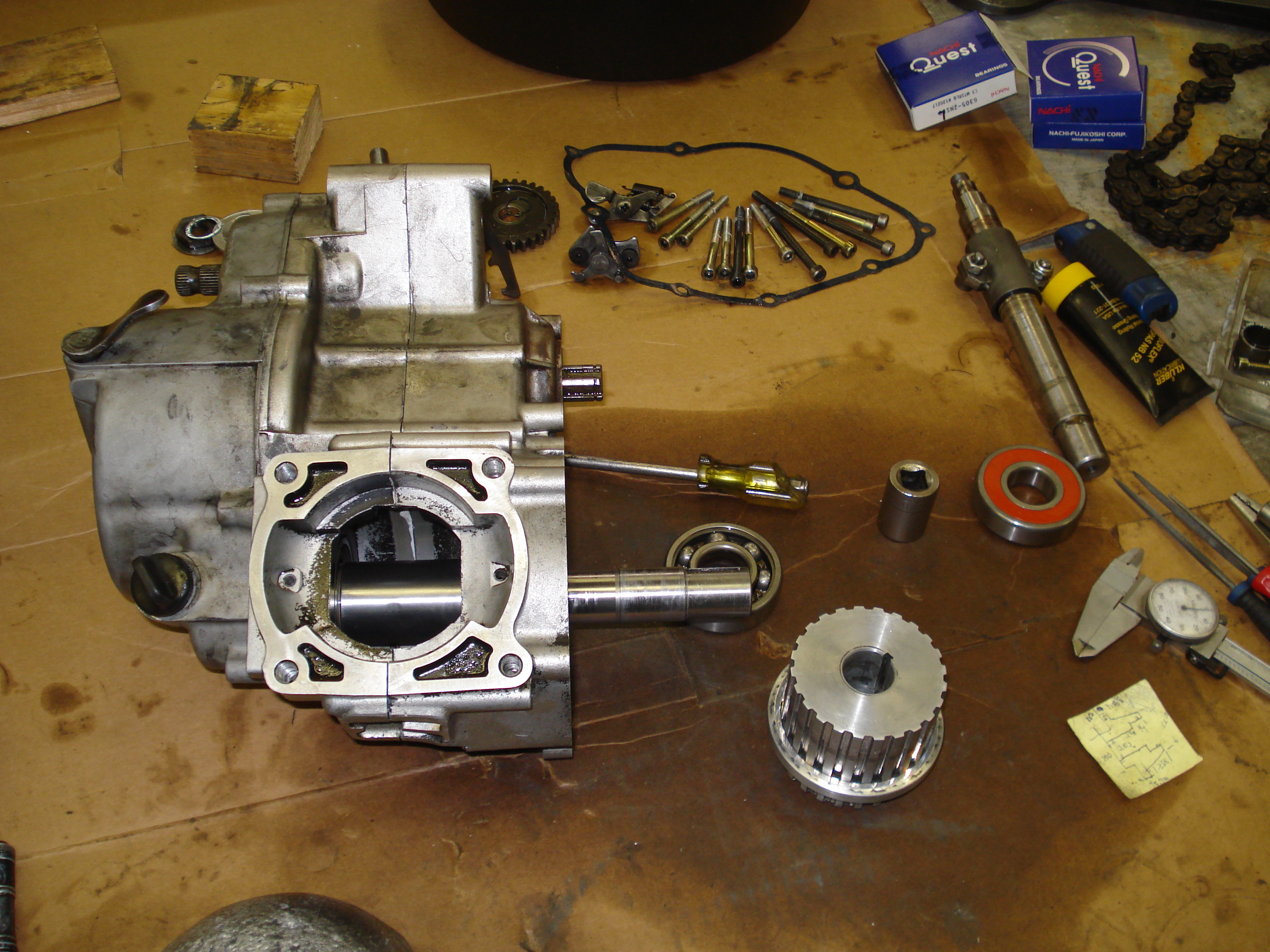

Re: Husqvarna supercharged 418 build

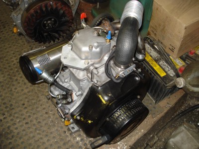

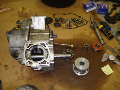

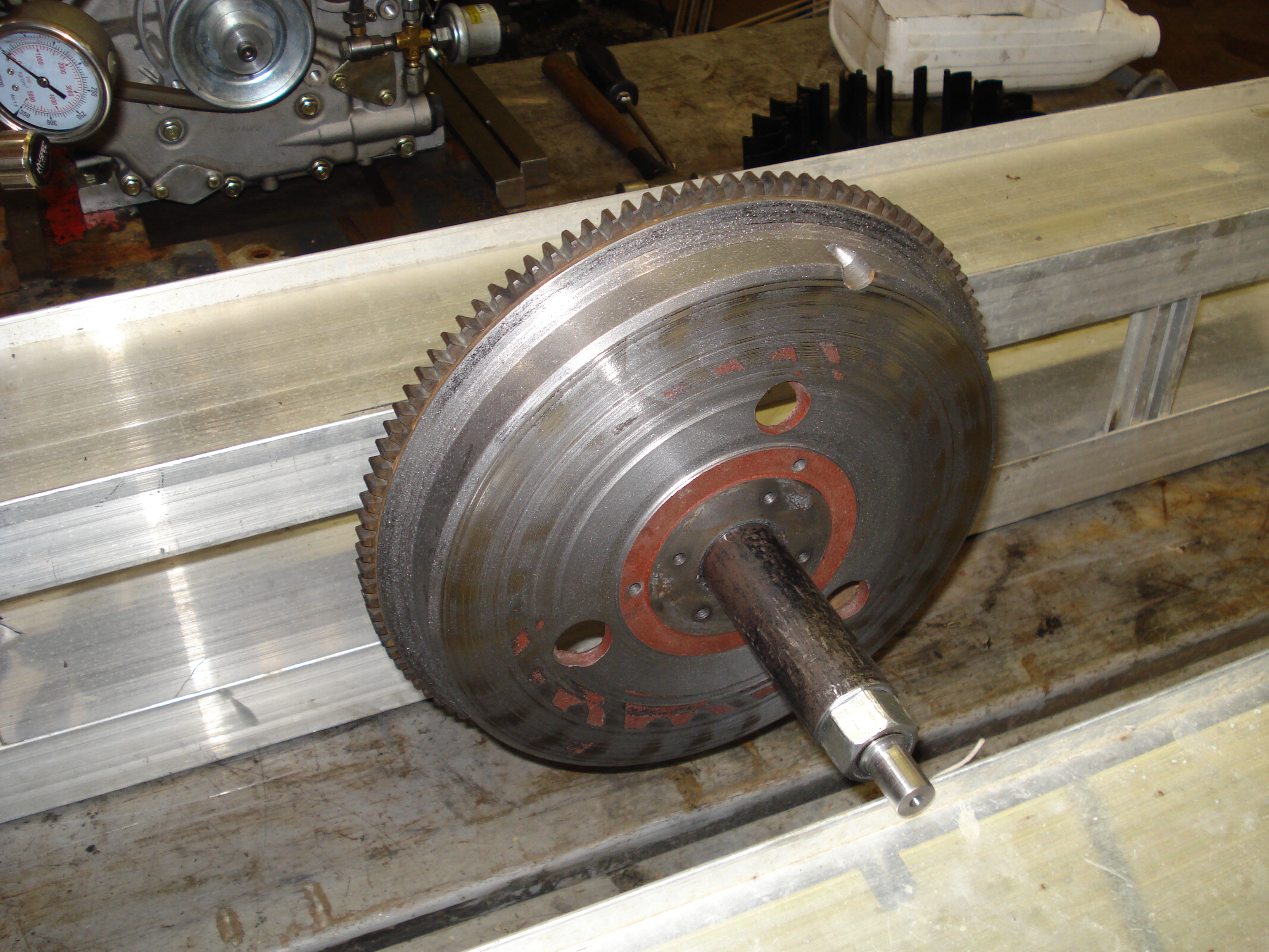

1982 kawasaki kdx 175 engine. crank removed,strait shaft instead.

Nicely done... Explains why I didn't recognize it.
But is that little 175cc's transmission and clutch strong enough for your diesel in the long run?

well the bike has about 6000 km total recorded on speedometer and about 1000 to 1500 unrecorded before speedometer riden hard in the dirt and this passed off season i dissmanteled the complete trans to inspect and there were no signs of trauma so i'm going to keep running it.

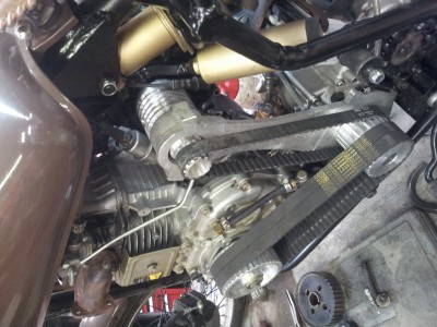

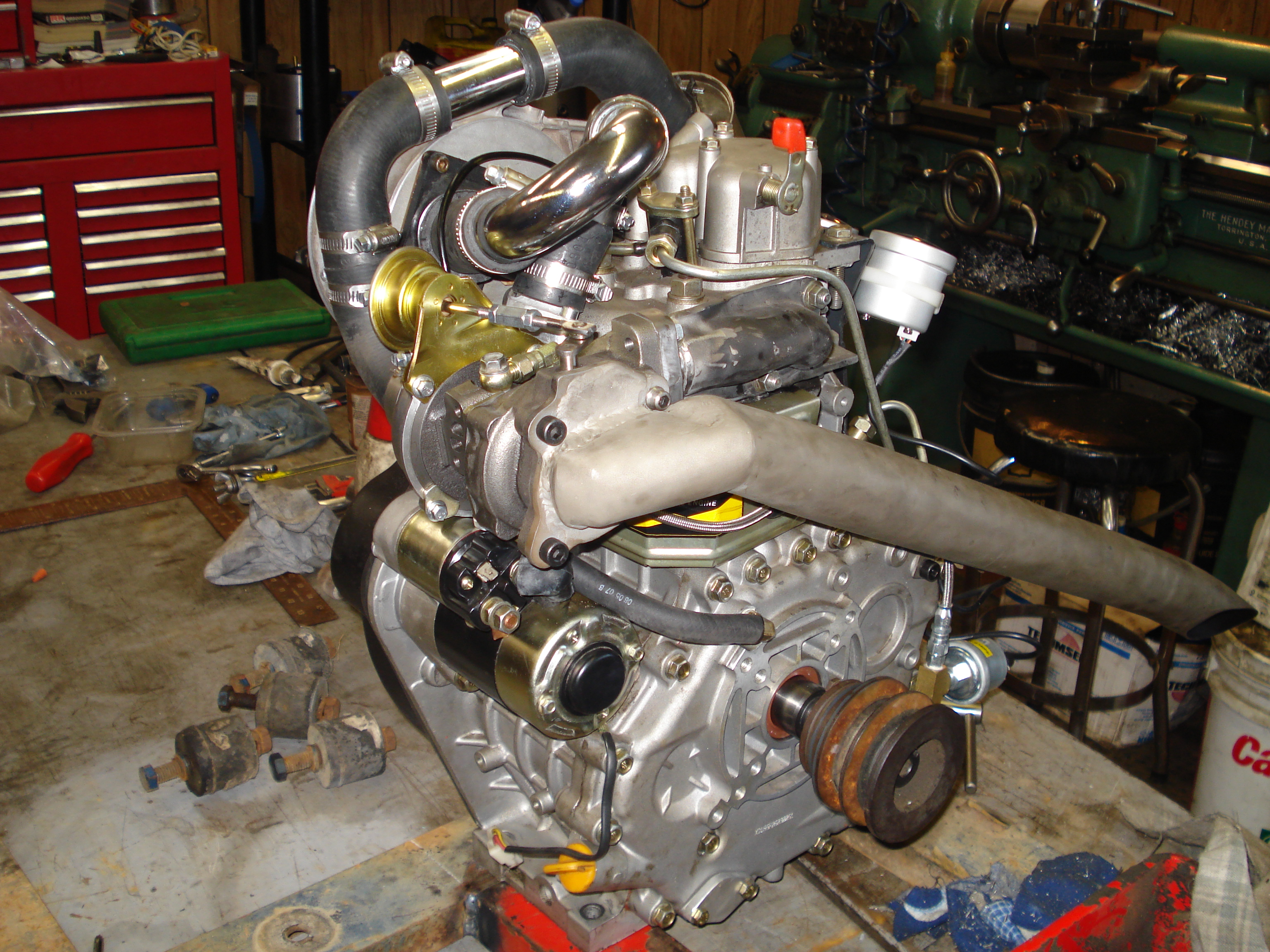

Very well done! Respect! Did you lower the compression ratio of the enginge? And how much bost do you run?
Alex
Alex
BoxerOtto
- Posts: 91
- Joined: Tue Jun 10, 2008 3:05 am
- Location: sexsmith,alberta,canada
yes i lowered the comp ratio to 17 to 1. idling boost is about 5psi 3600 to 3800 rpm is about 10 to 12 psi. 3200km's used 77l of fuel.

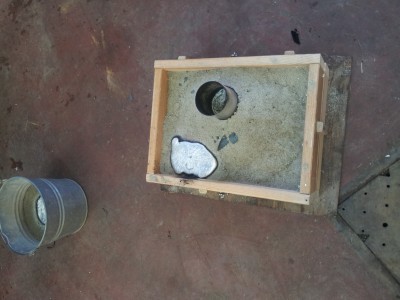

- Posts: 320

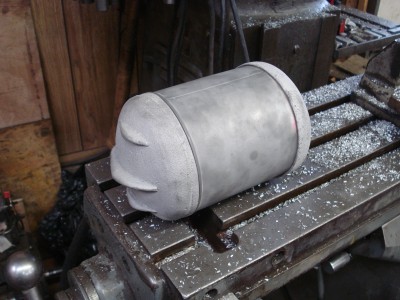

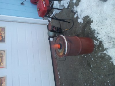

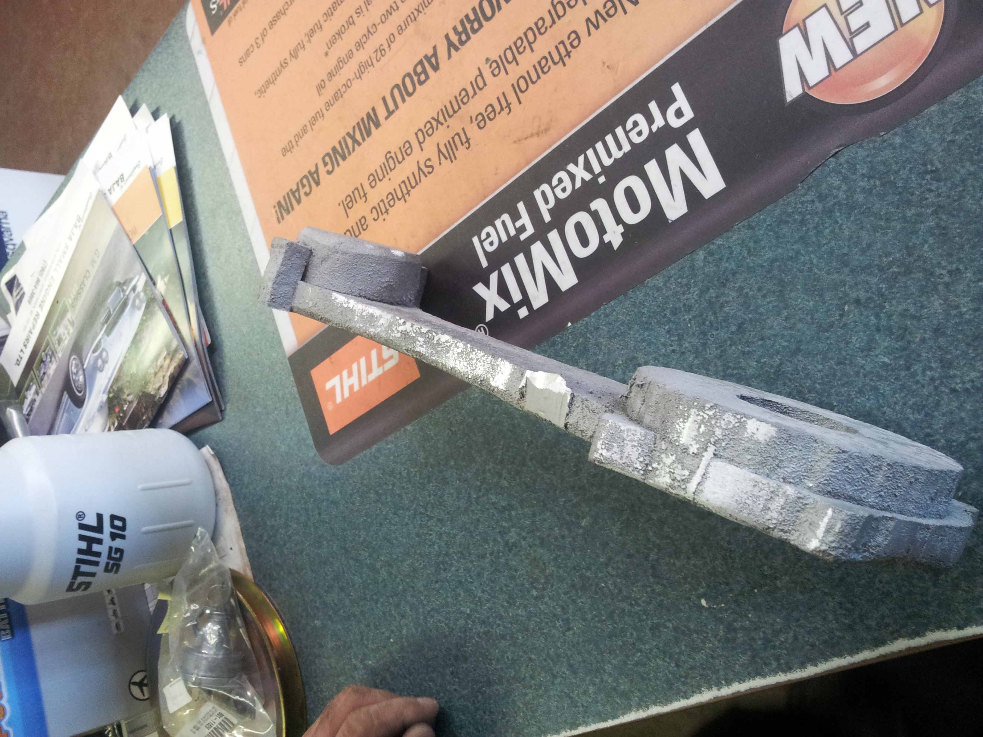

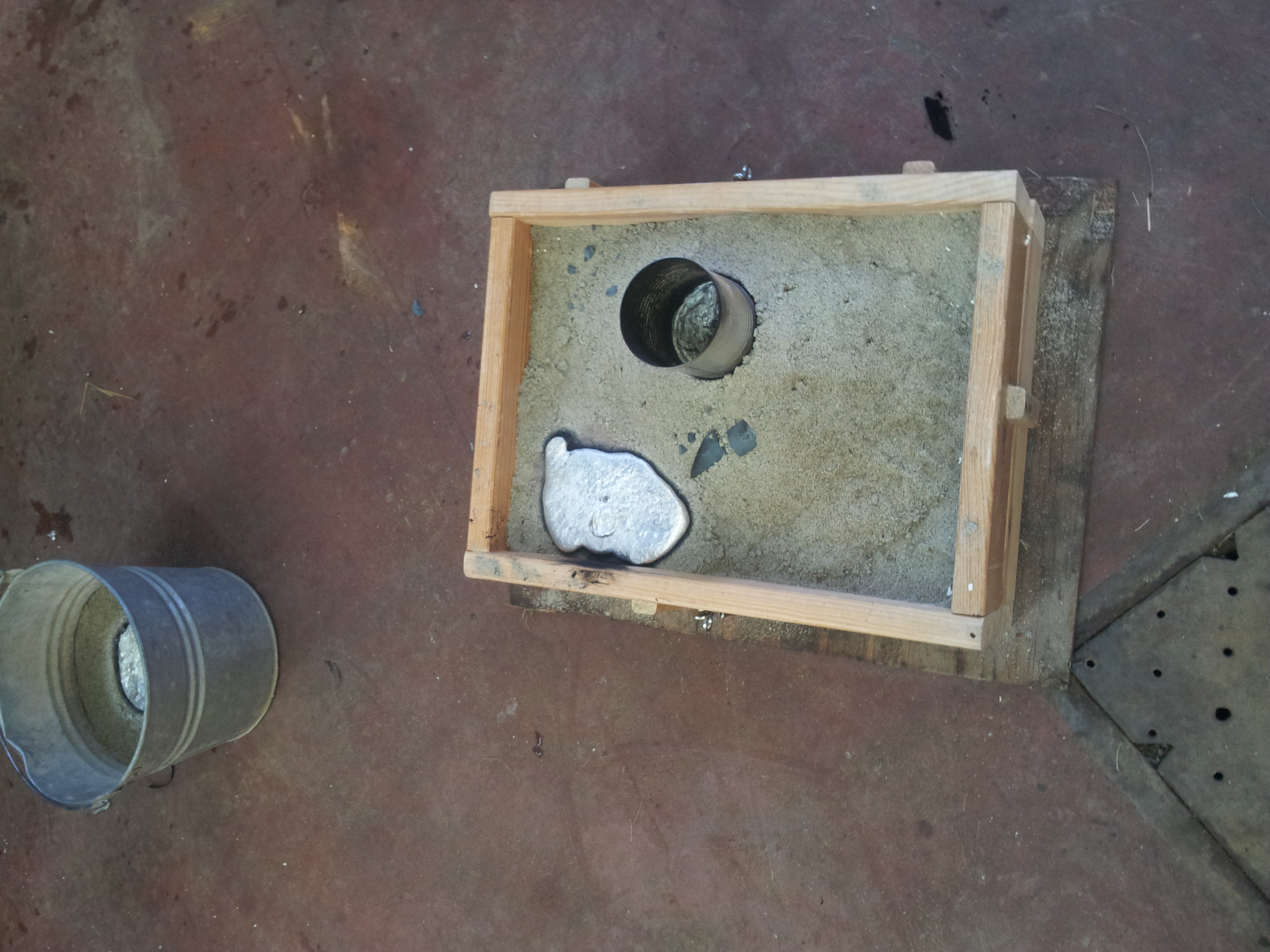

Nice foundry work - is that your plenum 'ends', and did you cast them directly into the tube they were designed to fit into?!
I've not cast anything bike-related yet in my setup - except for a Norton sidevalve tappet cover I did because I had one with holes in which someone had screwed to my mate's garage wall. I filled the holes with epoxy putty and used it for a pattern - it's my first 2-sided effort and came out well. I'd sell them for a lots of money, but unfortunately, for obvious reasons, it's a bit small

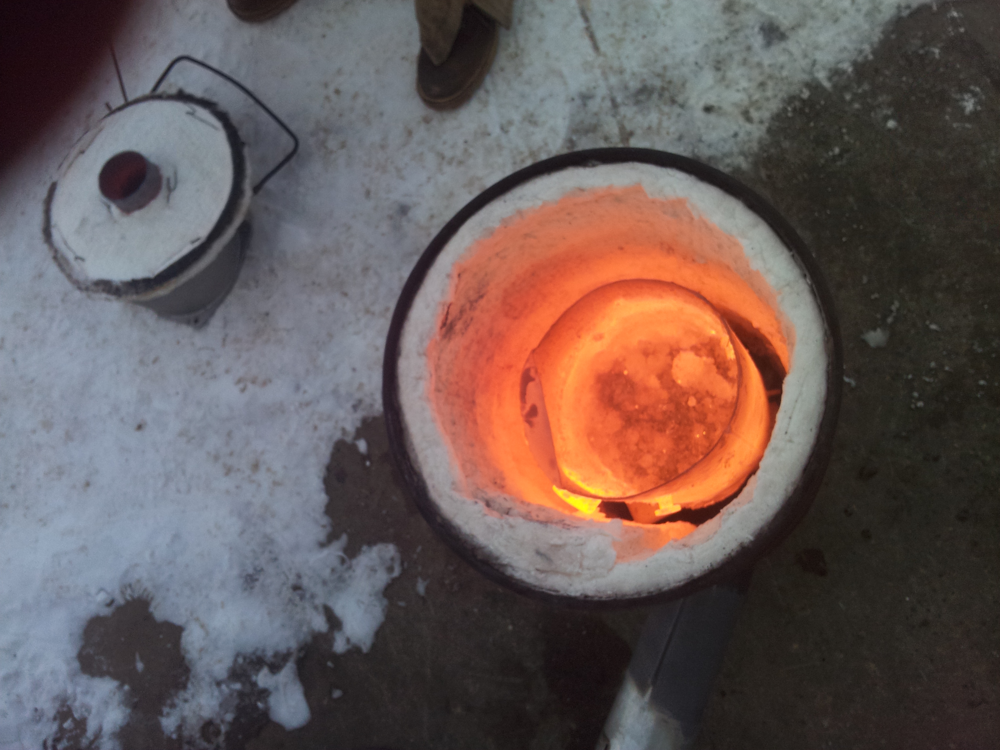

Recently I found a whole pile of rolls of ceramic-wool insulation sheet, so I'm hoping to get to higher temps and melt copper soon. I'm using waste engine oil and a blower.
cheers

thanks mark. these ends are actually my toolbox. i'm still experimenting with my foundry and would eventually like to do some bronze. i'm using an old diesel furnace gun to fire it and it works very well. i made some other parts when i mounted the centrifugal charger, i will post some pics now.

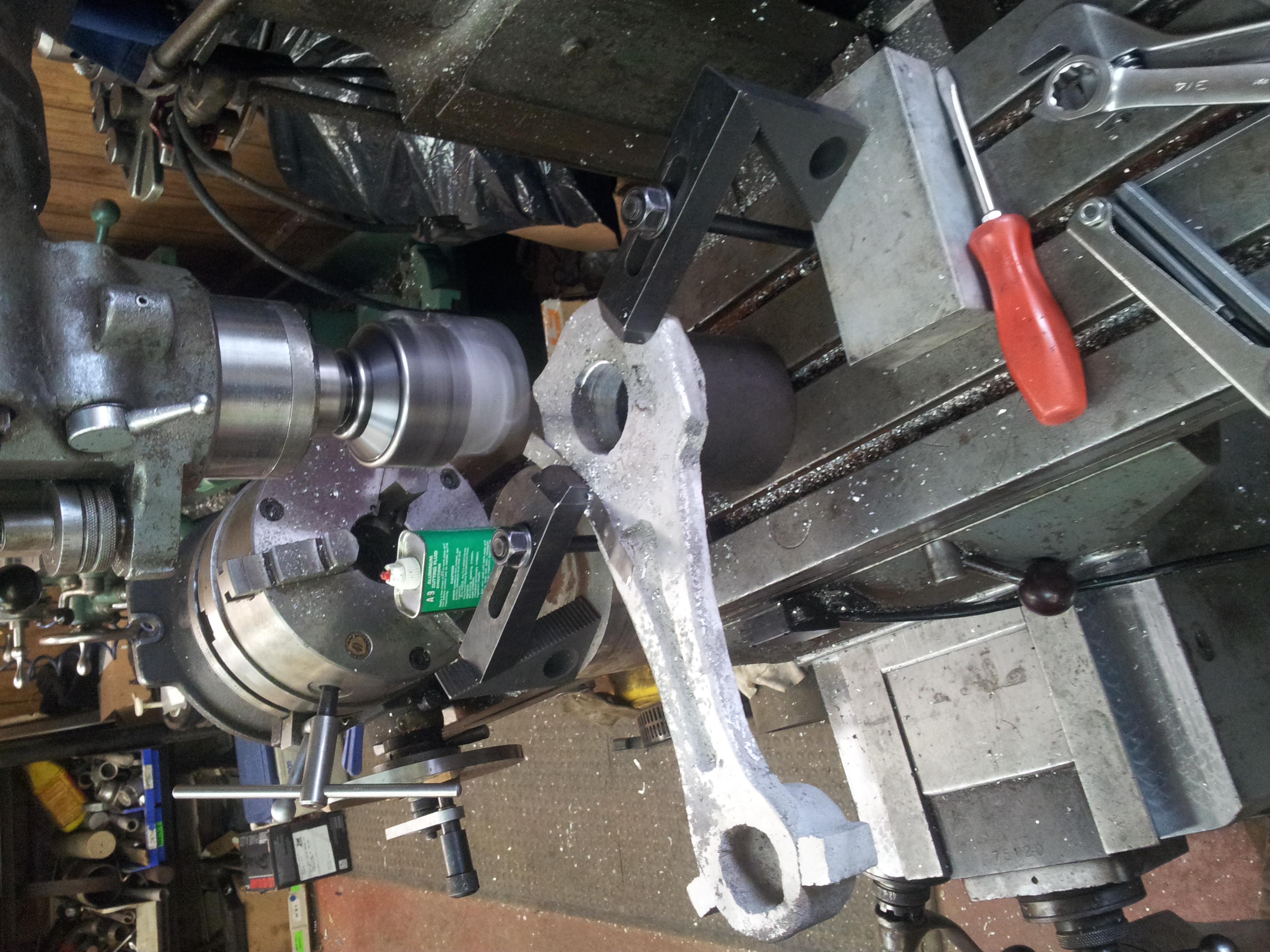

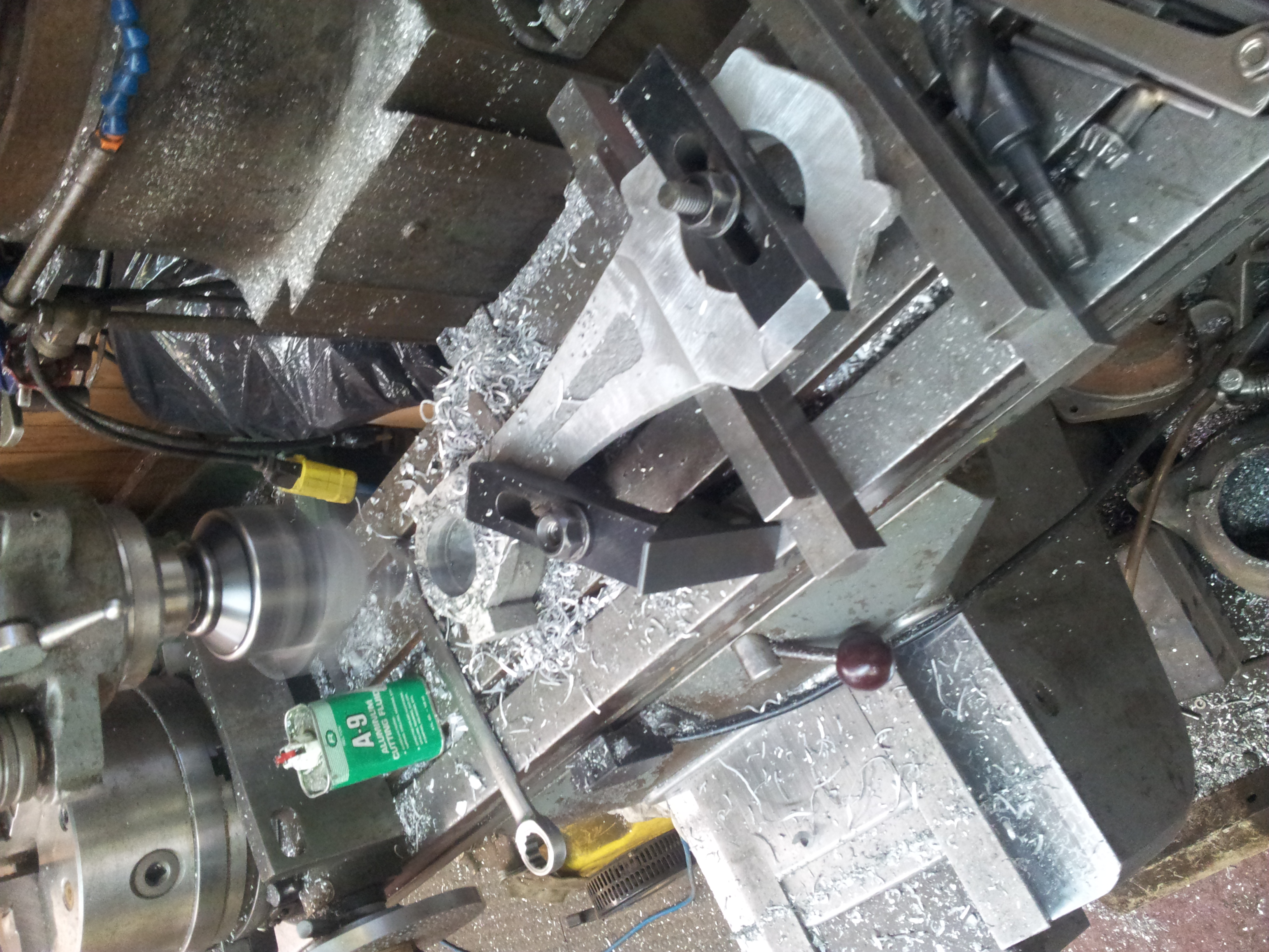

I've rather limited space, and my 'milling-machine' is a forced marriage between a small 3-axis table and an ancient pillar drill. I envy you a big machine and the stability to clean things up with a fly-cutter like that.

They are old machines but they work good. a bell housing would be a cool project. just never enough time for the fun stuff.

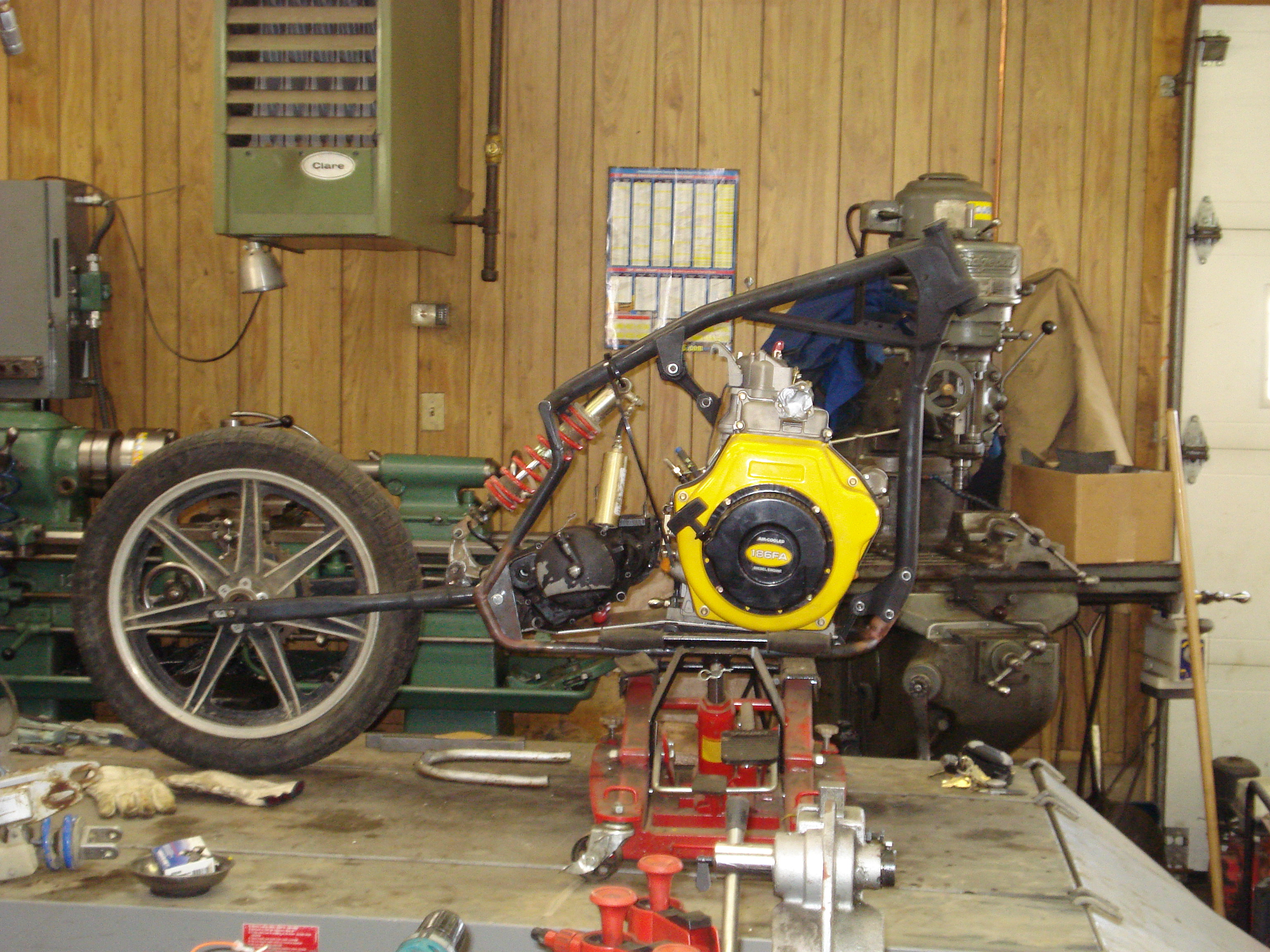

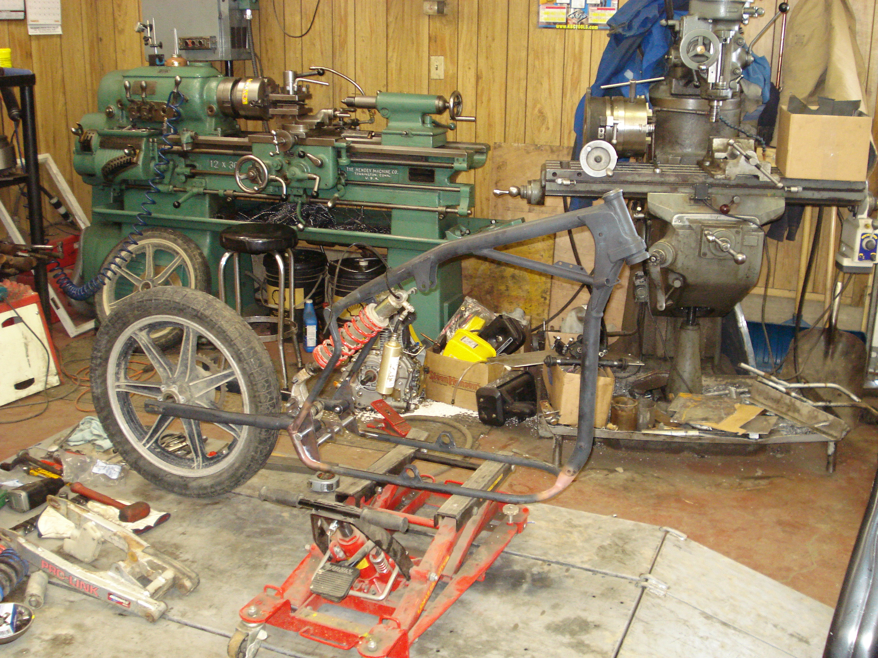

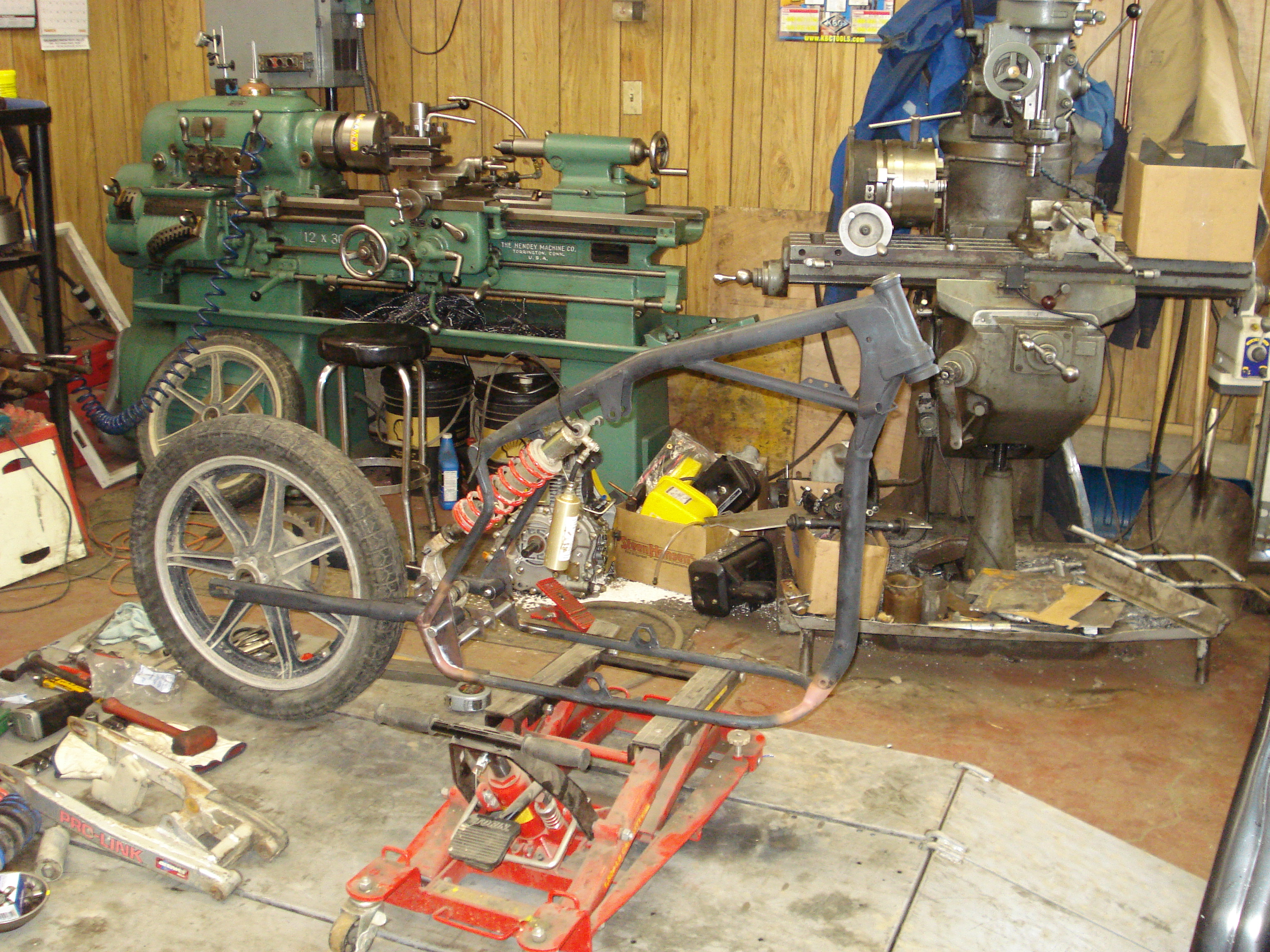

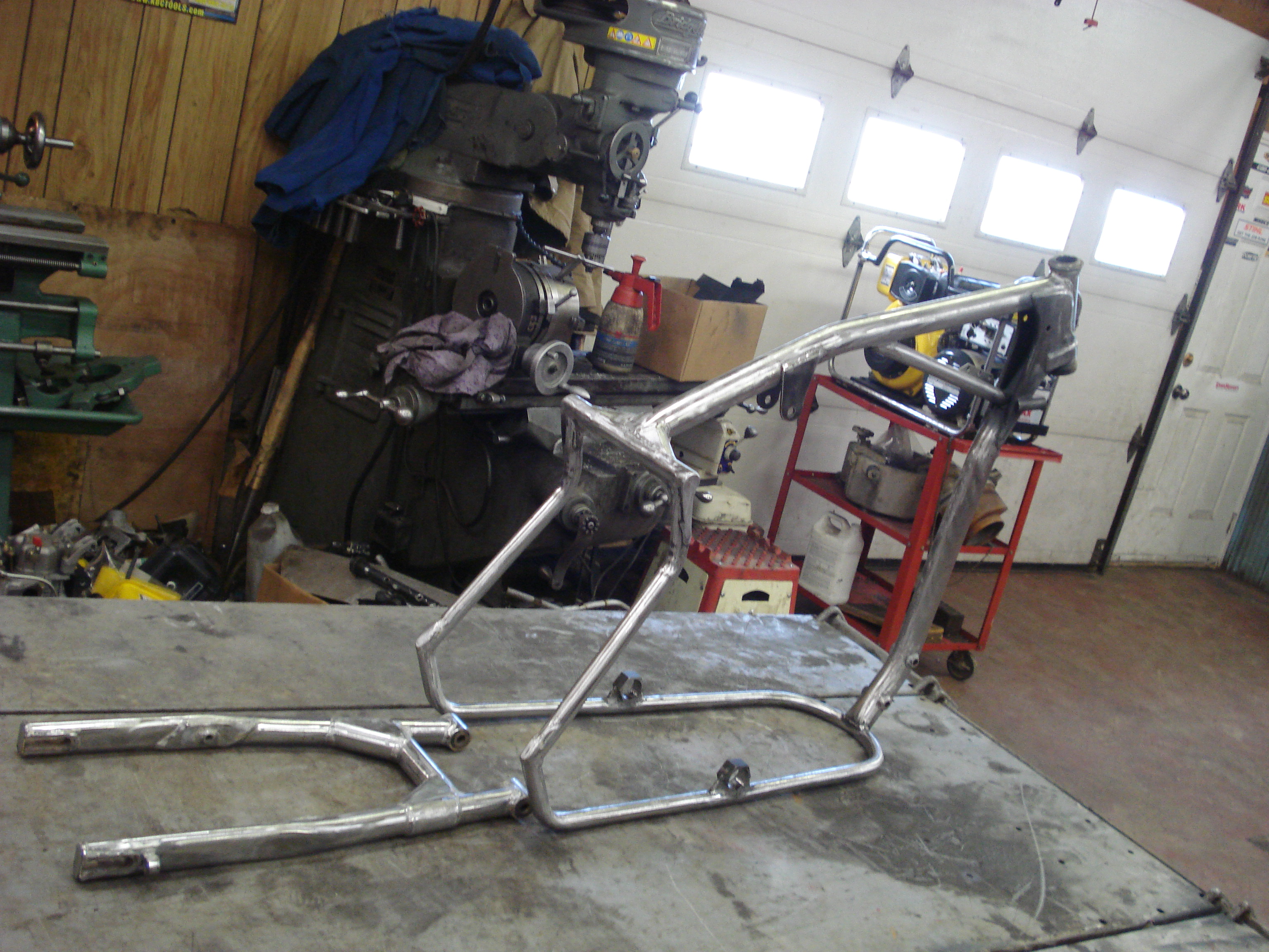

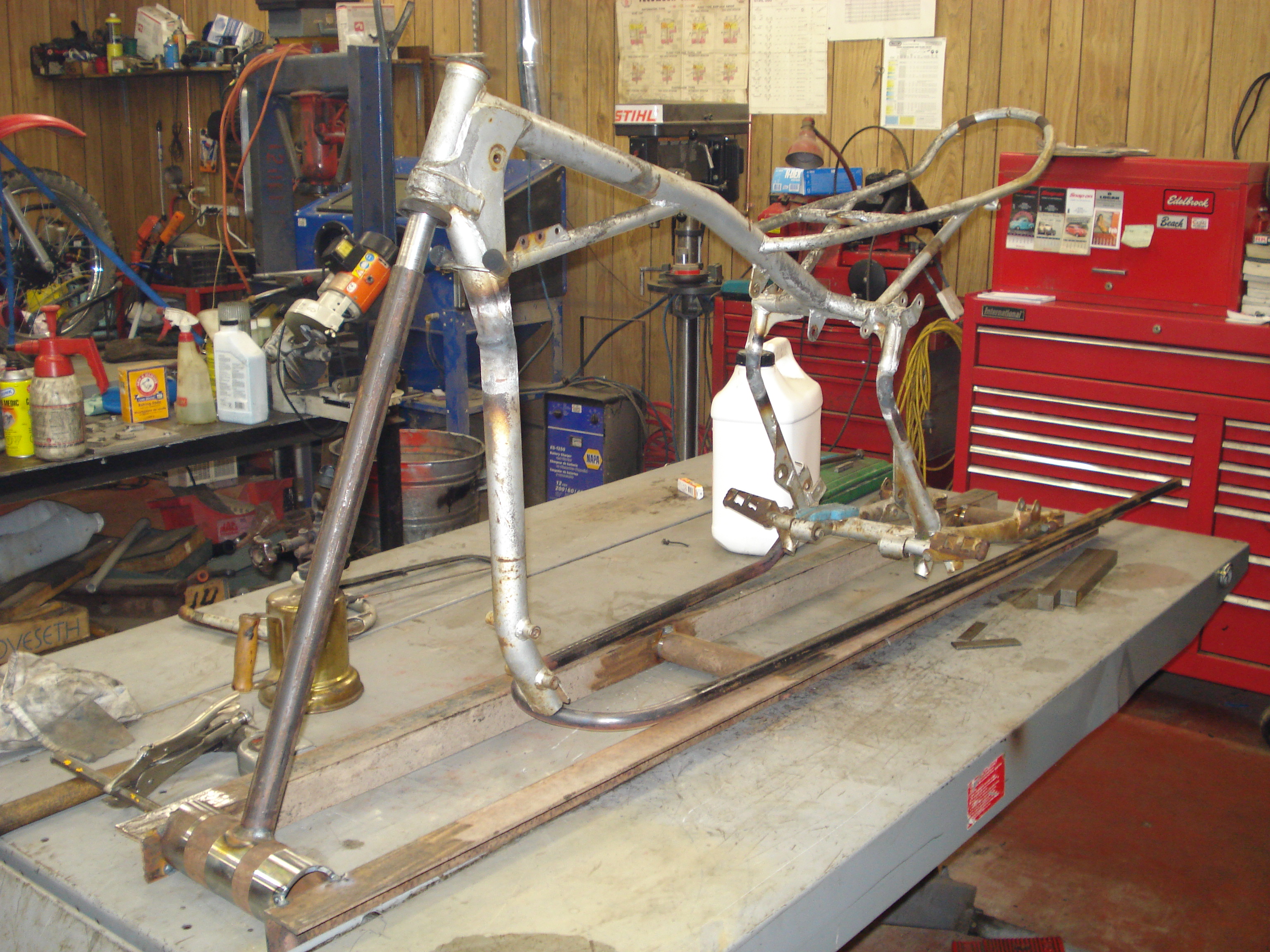

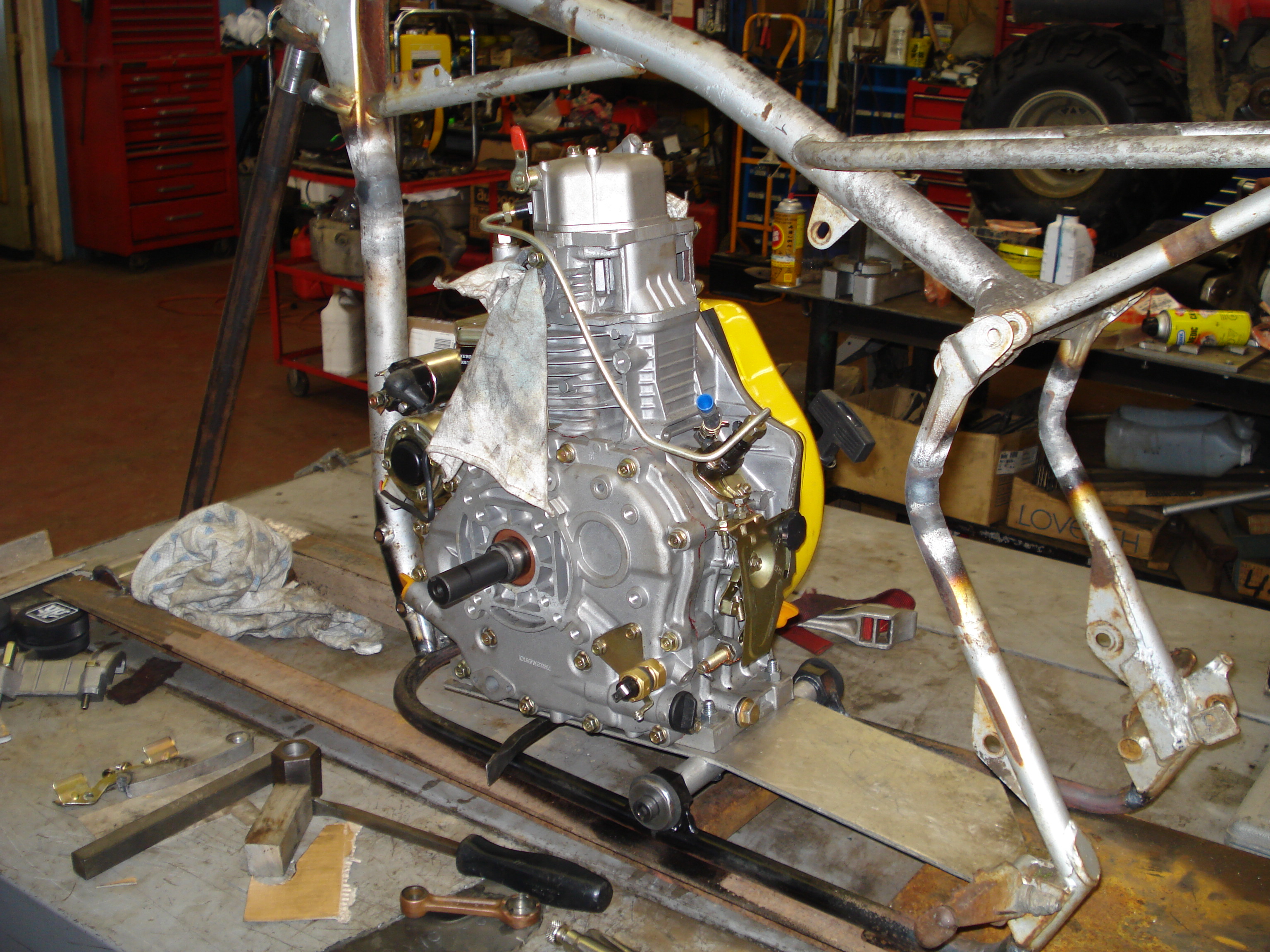

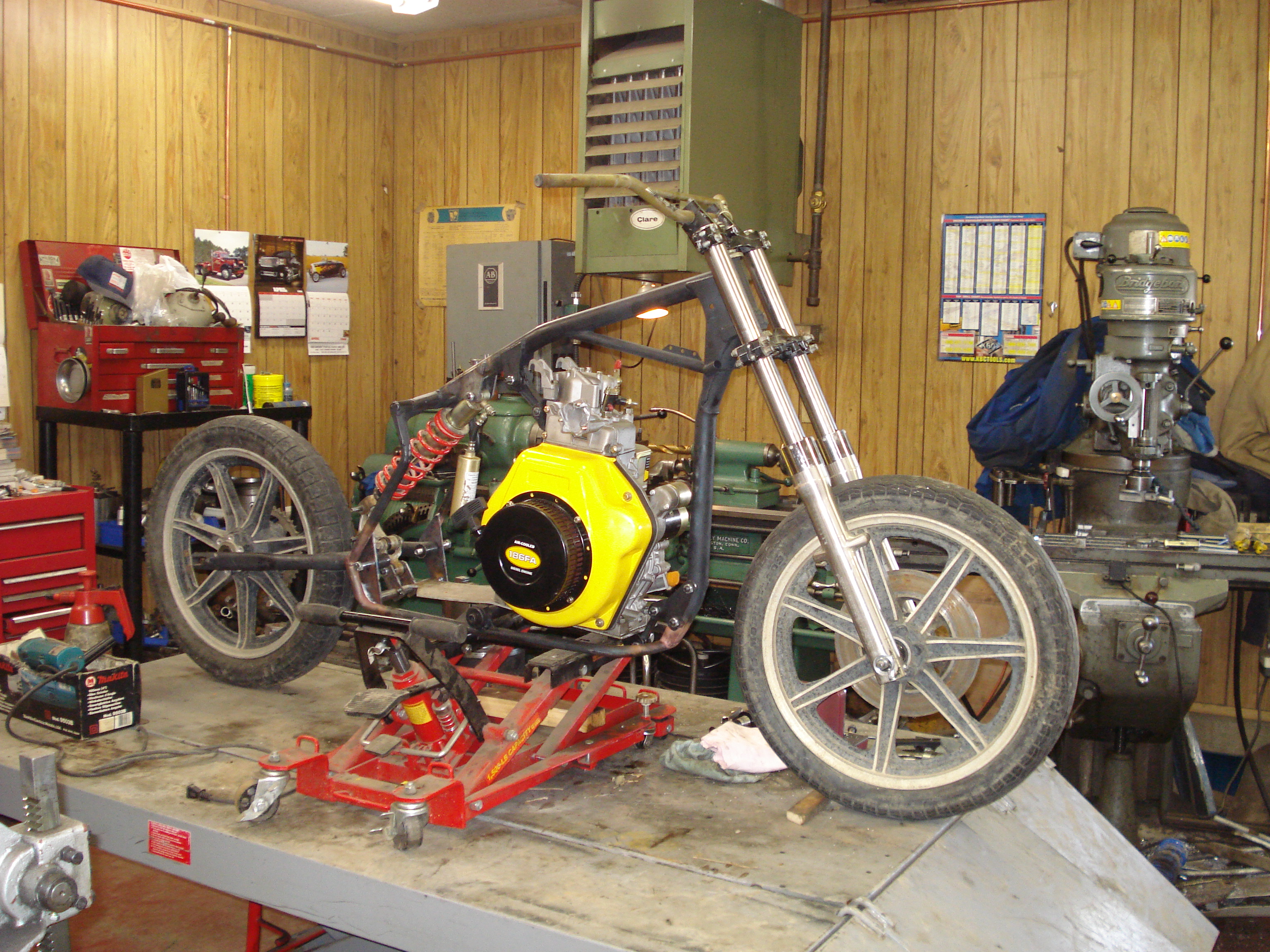

early building 2008.

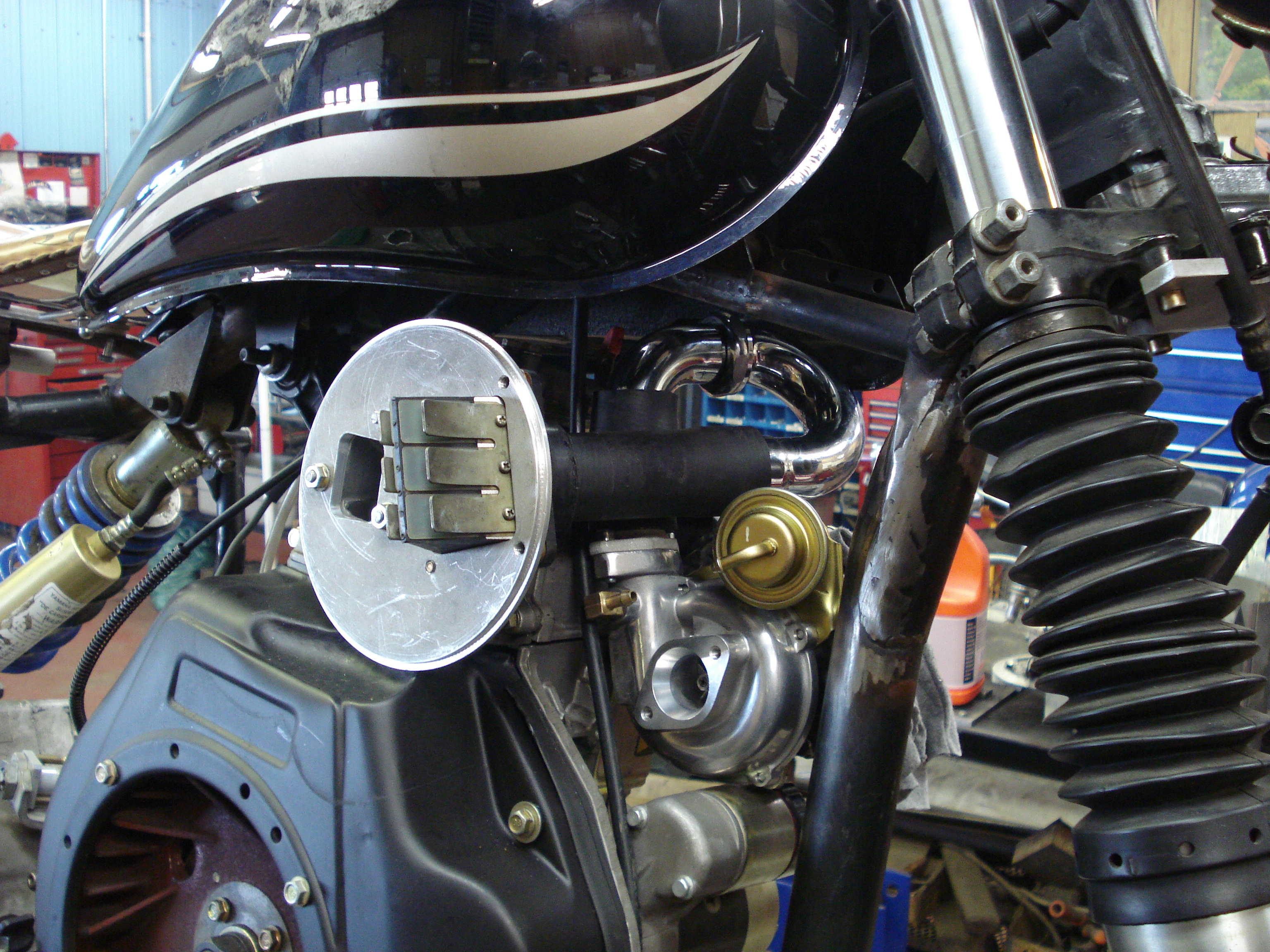

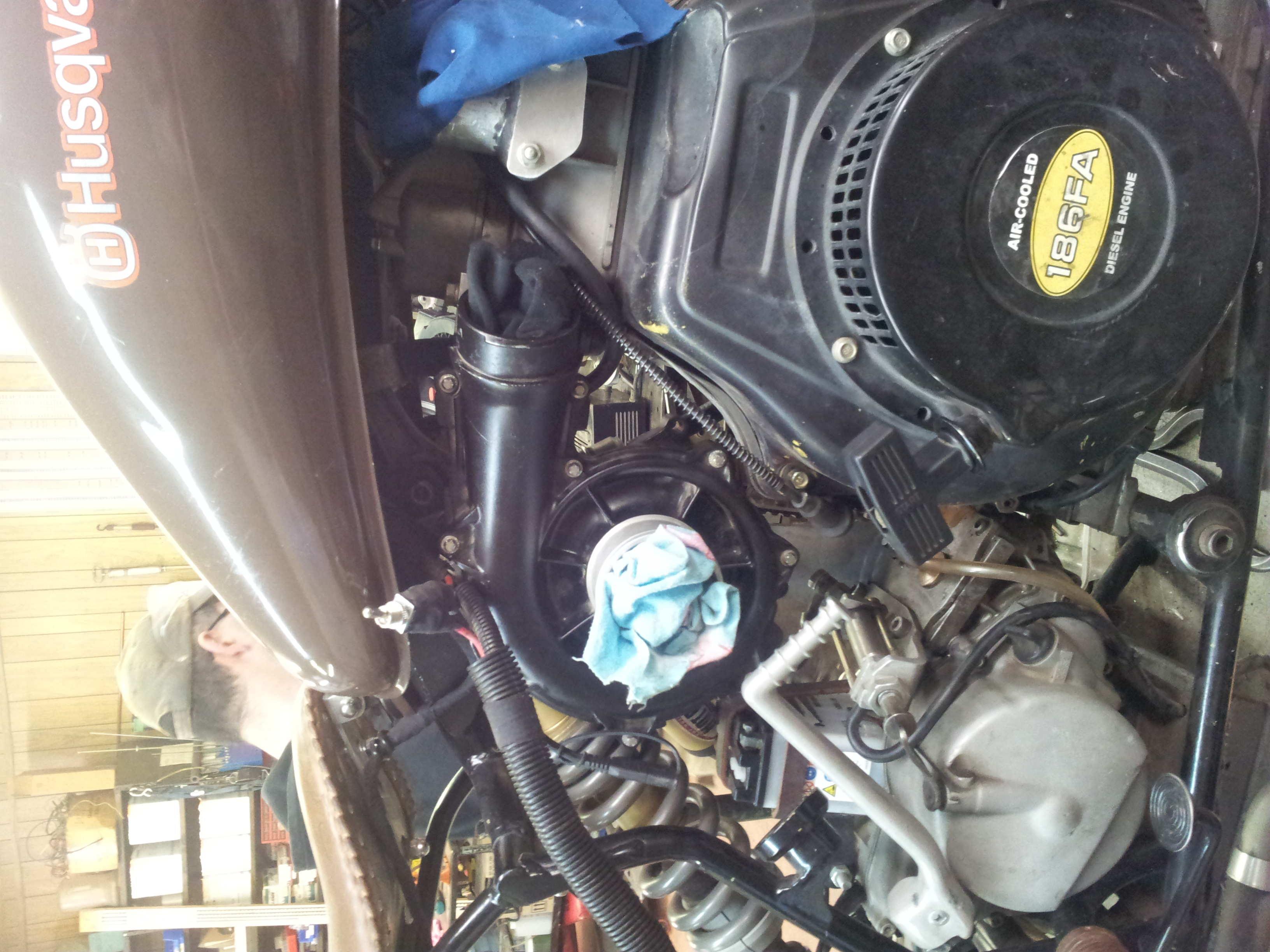

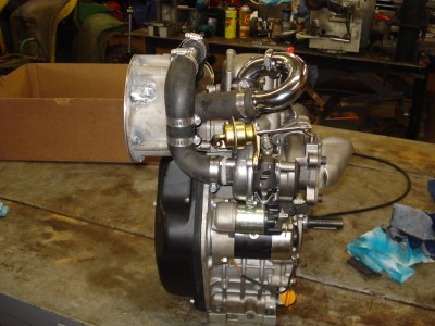

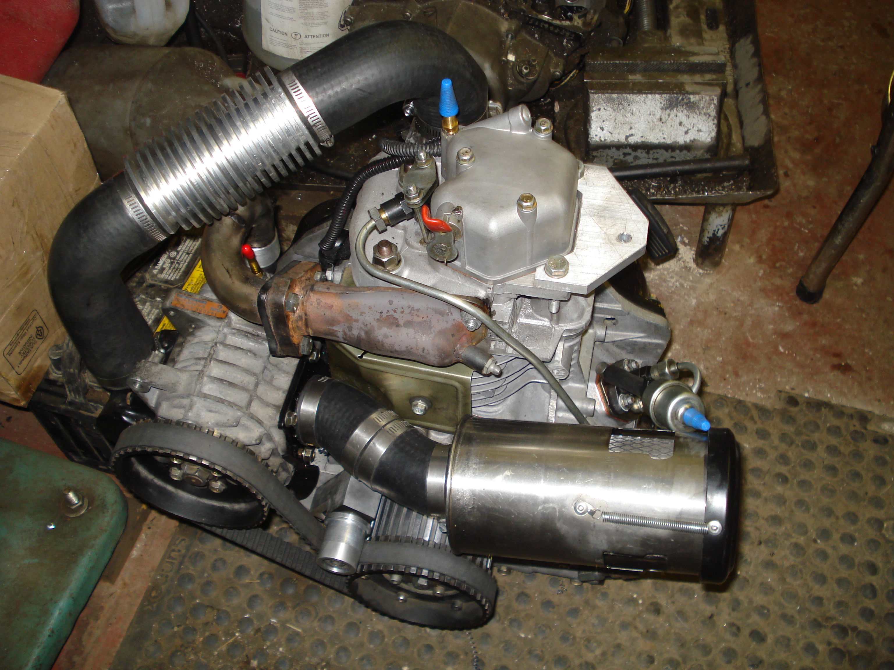

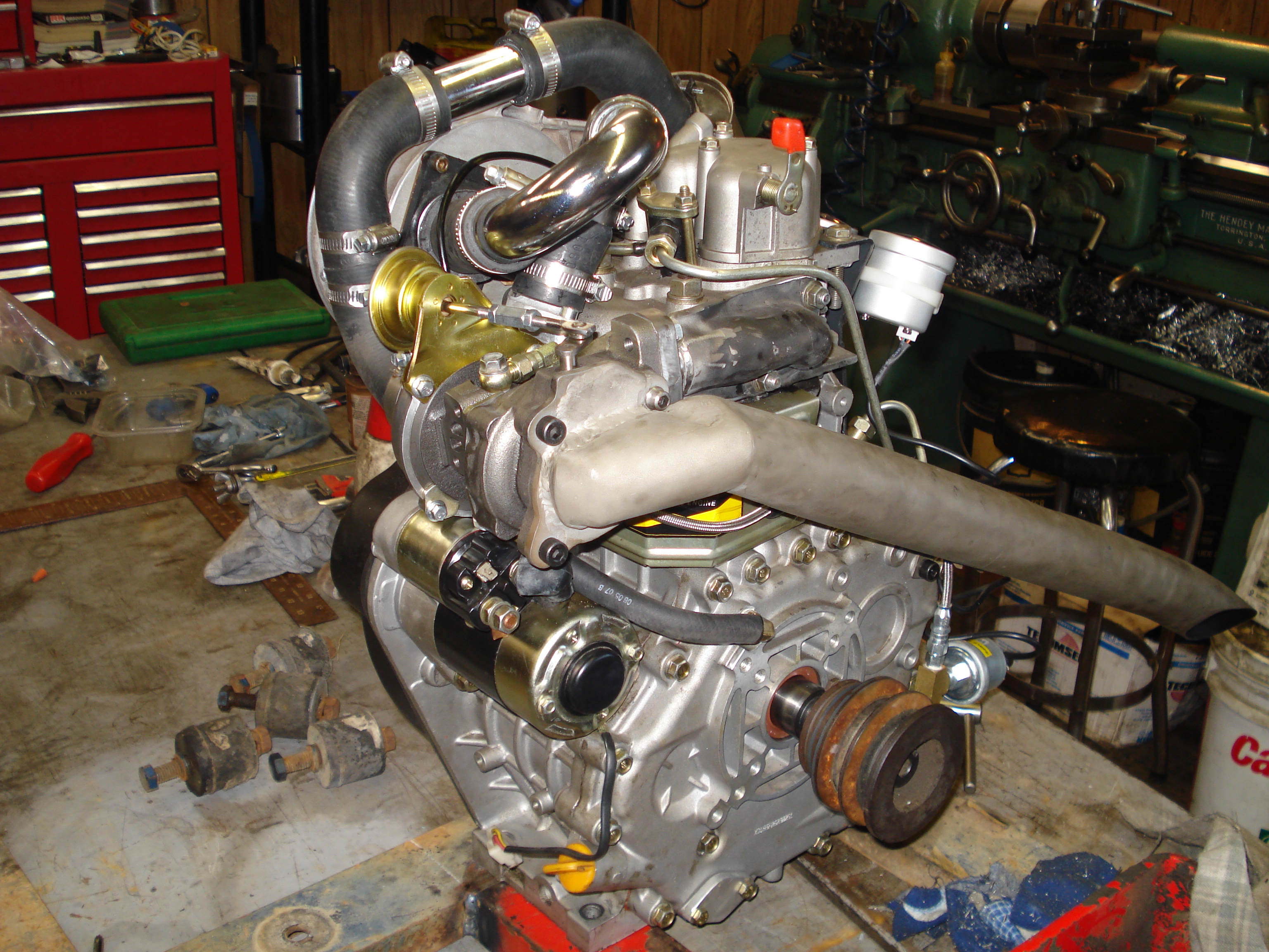

Why was the Turbicharger dusapointing? What is better with the supercharger (belt druven compressor). On the pictures i cannot see an intercooler, and the pipe from the compressor (turbocharger) is quite short. And contains not much volume. I think, when the engine sucks after the Intake valve opens, the is a big pressure drop in this pipe and the carger cant refill this before the intake valve closes.BoxerOtto wrote:
Alex
viewtopic.php?f=32&t=2527 will give some explanation of why supercharger not exhaust powred turbobf109v7 wrote:Why was the Turbicharger dusapointing? What is better with the supercharger (belt druven compressor)....BoxerOtto wrote:
BoxerOtto
- Posts: 91

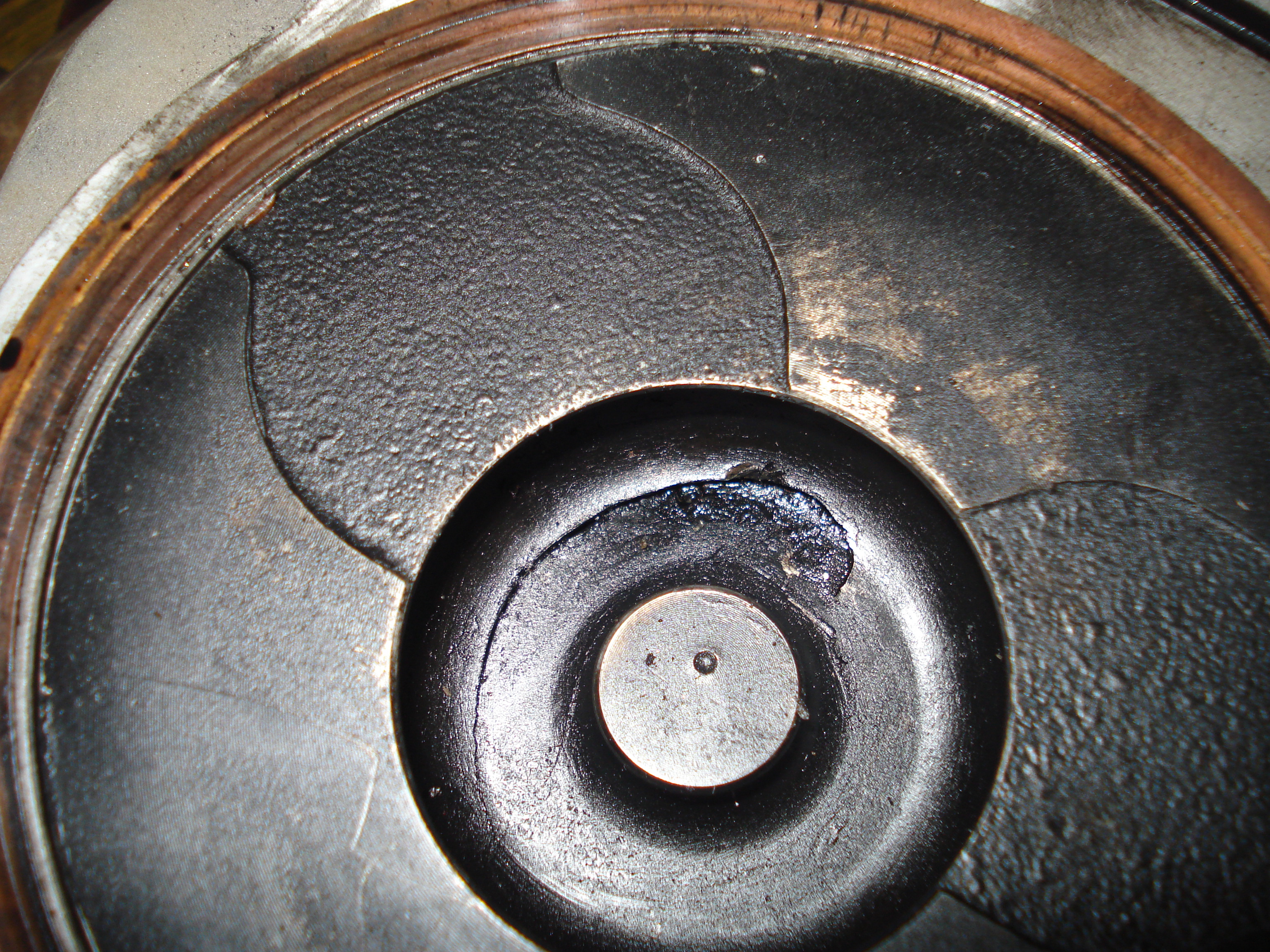

the snail supercharger also did not work. could barely achive .5 psi boost. to large of a unit. being large I thought I could spin it slower than it was designed for on the seadoo because my displacement is 418 cc not 1500 cc.however on the seadoo it needed to run up to 43000rpm. all I could gear it to was about 18000rpm. the load driving it this fast was more than the minimal boost could provide extra power for so it was a slower bike than naturally aspirated. the amr 300 supercharger is positive displacement and geared 1 to 1 provides ample boost and volume for 418 cc. however there are many other mods to the engine that need to be done first, and is not just a slap it on solution, but it works. I will post more on this tonite when I have time.
