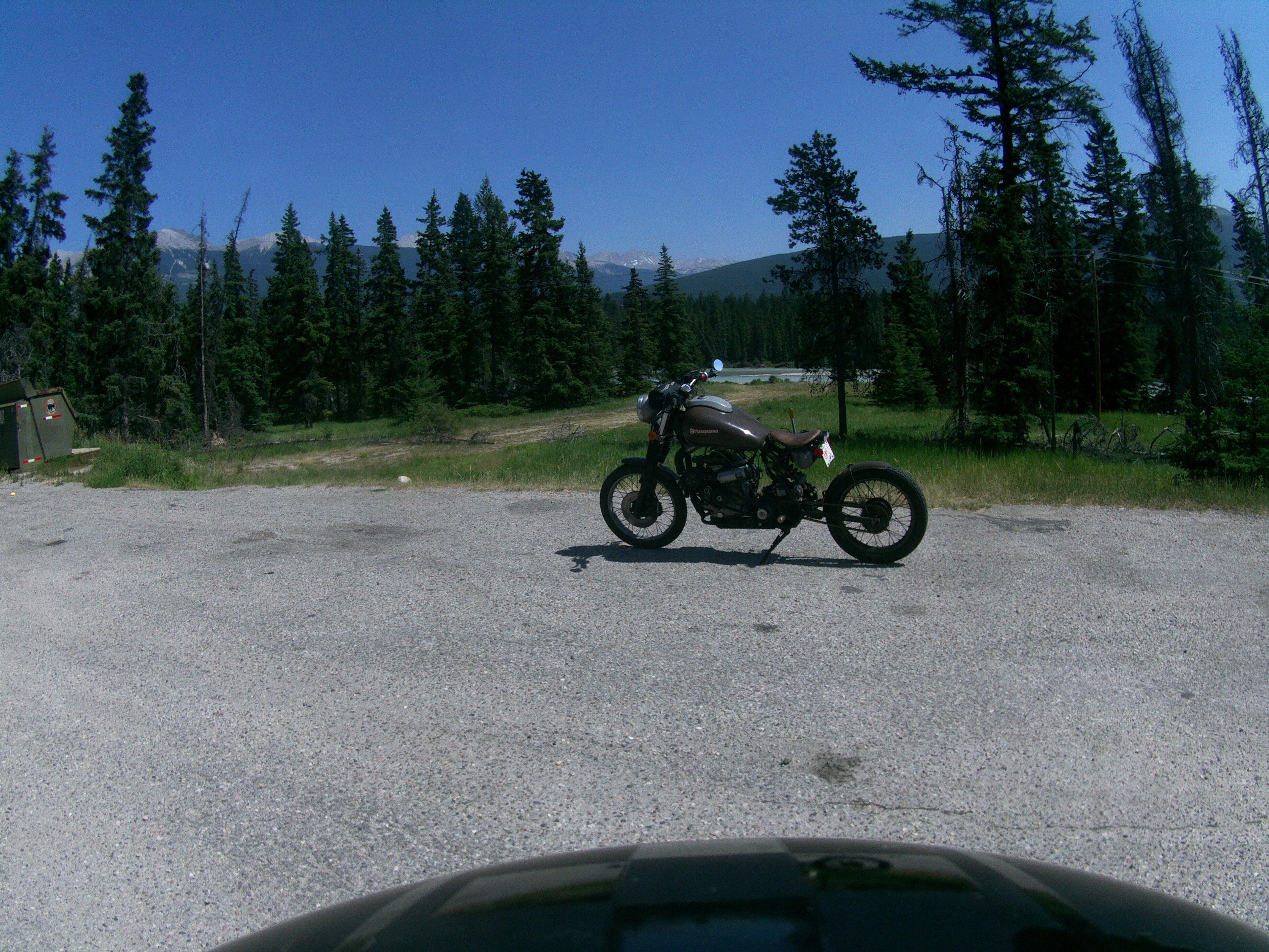

Post by BoxerOtto »
well, here it is finally. it works and seems to be reliable enough and its very fun to ride." miles with smiles " right. the building was fun and challenging but the riding is way funner. :D
jasper alberta july 2014
