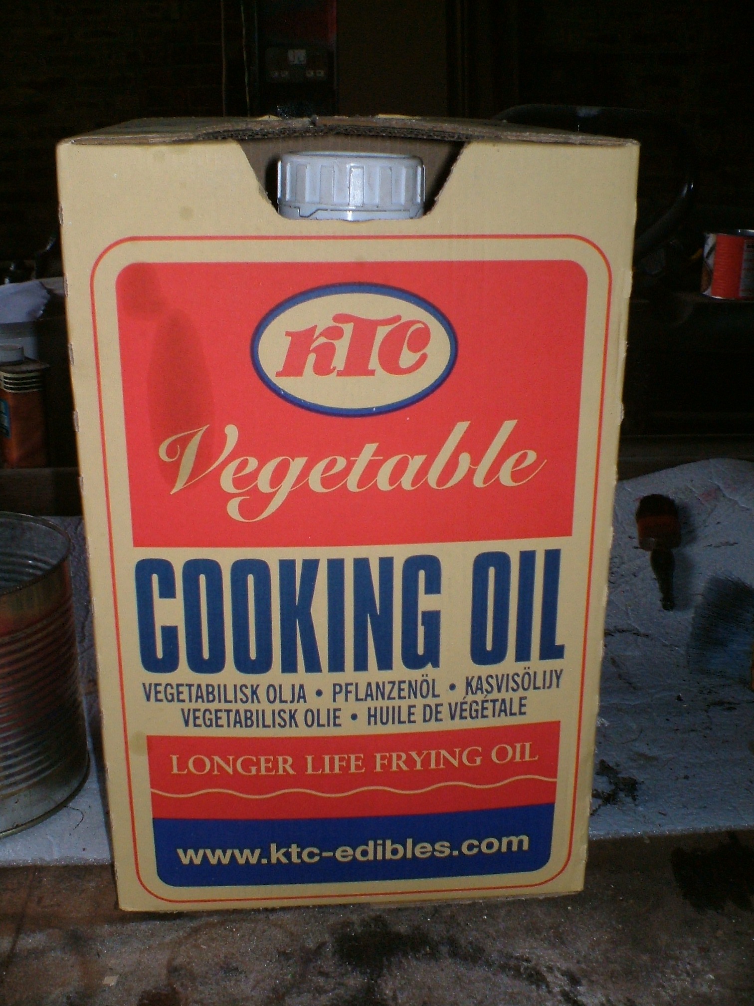

Right done another test today. Bought a gallon of the green stuff. Got a syringe with a small outlet and filled with diesel 60ml in the syringe. timed how long to drain out, about 47sec. Tried the veg oil, this was way longer would have been 400sec if I had waited. Mixed 60ml of veg with 10ml of petrol, this was still way longer than 47sec, so tried 60ml veg and 20ml petrol. This was about 57sec. Tried this in the lawnmower with the Yanmar engine, starting on diesel then changing to the 60/20mix, not good, did not stop but not far off, the revs died to perhaps a 1/4. Although it mixes well i believe the petrol element is exploding far before top dead center and thus robbing the power by slowing the piston. Still it was worth a try and would have been good if it had worked.
