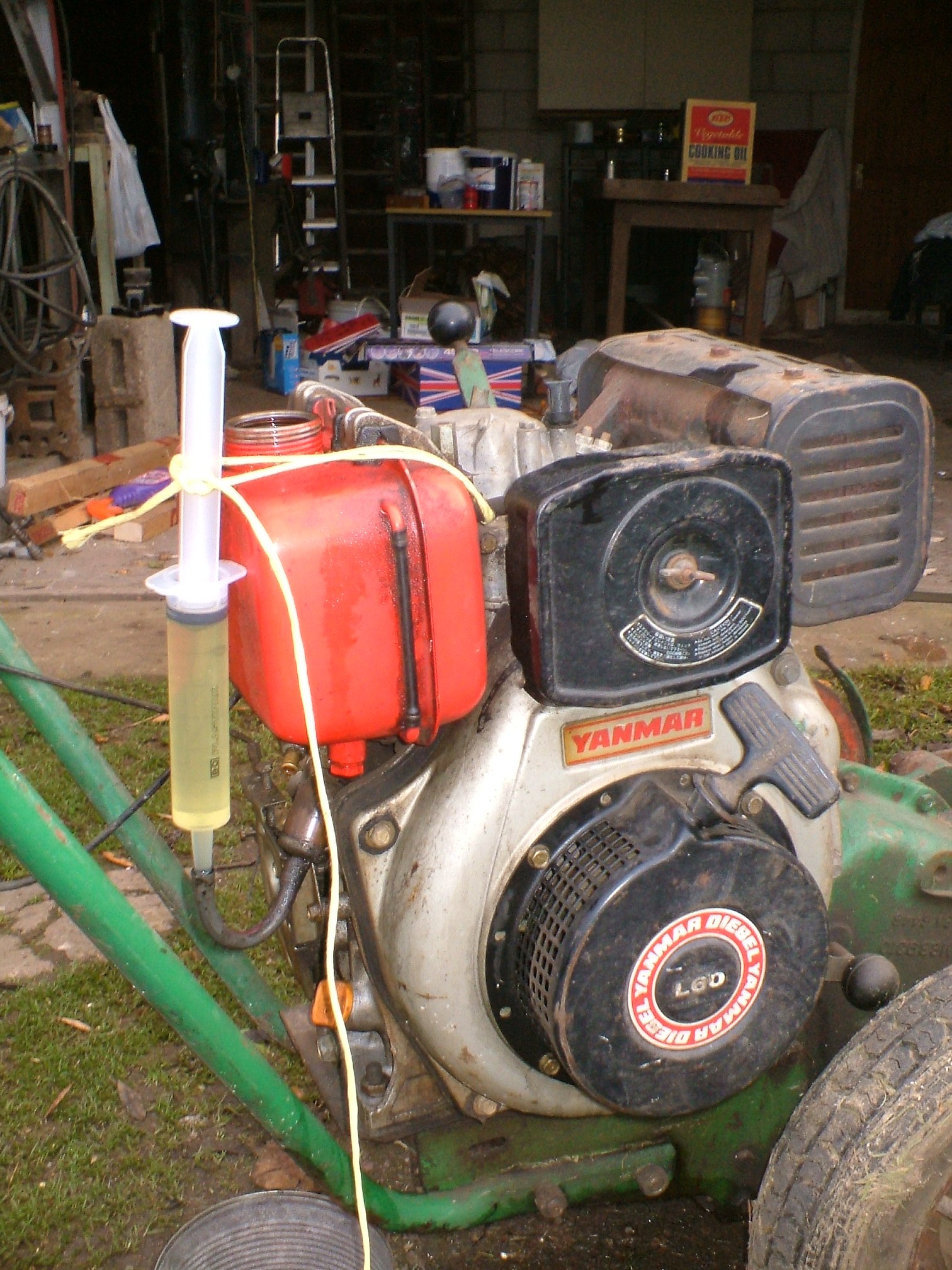

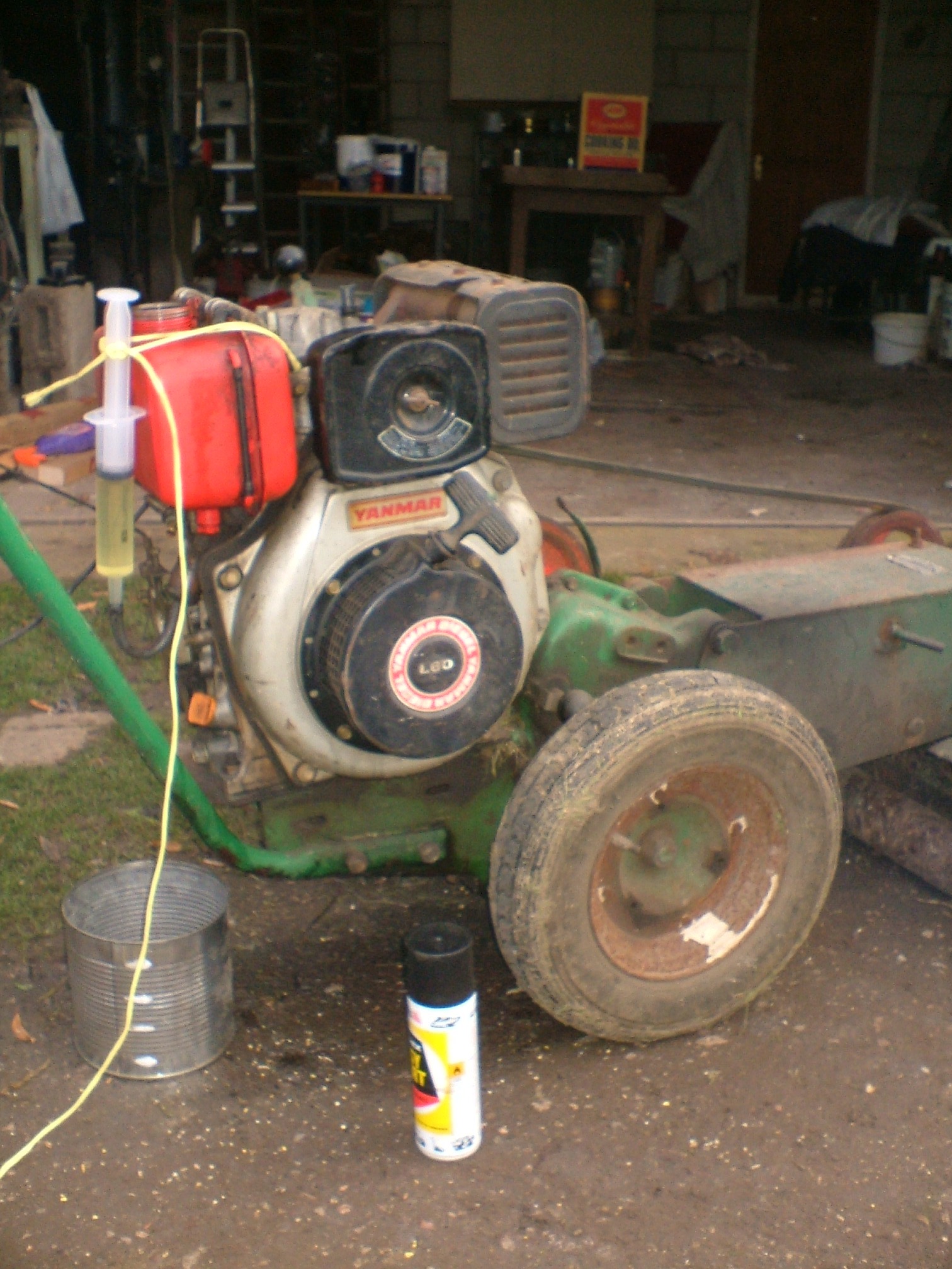

Here is the start of my trials on running with veg oil. Take one lawnmower with same engine as small bike. Disconect tank and replace with syringe filled with veg oil. 20 litres £20. 100% GM soya oil. Pull cord and away she goes admitedly on diesel to start with as there is a small inline filter before pump. A few seconds later on pure corn oil.
Runs OK apart from smelling like a chip shop. The syringe works well and the plunger automatically travels down as the oil is used. Stoped on veg oil, left it a short while and tried the restart. Would not start,gave a squirt of easystart and away she went. Next did a fifty fifty blend of diesel and oil mixed in a bean can and back into the syringe. Squirt of easystart and away she went. Let her run a bit. Stop and restart, this time no easystart. The interesting thing is the plunger in the syringe does not like diesel and you have to give it a bit of a push. The plunger probably reacts to the diesel.

Right done another test today. Bought a gallon of the green stuff. Got a syringe with a small outlet and filled with diesel 60ml in the syringe. timed how long to drain out, about 47sec. Tried the veg oil, this was way longer would have been 400sec if I had waited. Mixed 60ml of veg with 10ml of petrol, this was still way longer than 47sec, so tried 60ml veg and 20ml petrol. This was about 57sec. Tried this in the lawnmower with the Yanmar engine, starting on diesel then changing to the 60/20mix, not good, did not stop but not far off, the revs died to perhaps a 1/4. Although it mixes well i believe the petrol element is exploding far before top dead center and thus robbing the power by slowing the piston. Still it was worth a try and would have been good if it had worked.
