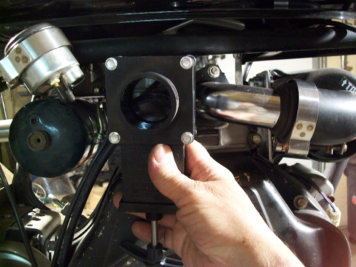

When still considering a turbo I picked up one of these to test out as an emergency shut-down device. Since it's water tight, I reasoned it might be reasonably air tight. Comes in 1/2" increments and can be plumbed in line with your intake hoses. The local RV salvage yard has them by the bin full as they are waste water gate valves from motor homes. So much more civil than trying to stuff a rag into the intake. And if you paint the handle red, you can pretend you're behind the tiller of a Detroit. Pic is a little dark, but shows the gate half closed.
- Posts: 320
Re: Turbo Ordered
I have a Daihatsu-ural with turbo...like your emergency stop idea. I have told myself I'll sacrfice a glove (and a turbo, I guess) if runaway ever happens...this would be more elegant and economical!

Not that hard to build a guillotine type shut off valve like the RV unit, but out of steel. All the RV waste valves I've ever seen are real lightweight plastic with a simple rubber O ring to seal at sliding plate. Not sure that's enough on a large displacement diesel? O ring could be sucked into engine, still allowing diesel to keep on running till it blows.
On larger diesels [over 2L] trying to stop a runaway with your hand will get you a new nickname: 'STUBBY'! Yes, it has happened with tragic results.
I've thought about it some & my solution is a flapper valve like a carburetor throttle plate, oriented so that once closed the intake vacuum would hold plate closed until engine stops. Actually the same as some exhaust brakes but used at air intake instead. Easier to build than a guillotine type, more positive control & very unobtrusive, not some big thing hanging out there.
