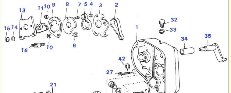

It's likely that the little spring you see in the picture is missing or broken or the plunger is sticking in the hole and therefore your pawl is relying on gravity to put it into engaugement with the gear - hence the excess travel.

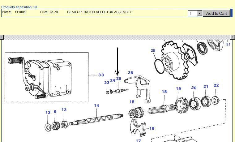

Whilst you are inside the cases check the engaugement detent plunger: (arrowed)
Some have the tip worn away because it was not hardened at the factory this leads to missed gearshifts.
Replace the 2 figure 8 springs numbered 2 and 5 in this drawing:

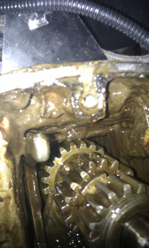

I don't think this repair will help much. Keeping it short because I'm on a phone. The parts were all in good order, only the slightest chip off the rectangular thingie.
While dismantling the gearbox I broke a bolt that shouldn't have come off. The gearbox poo was worse than I imagined. :(

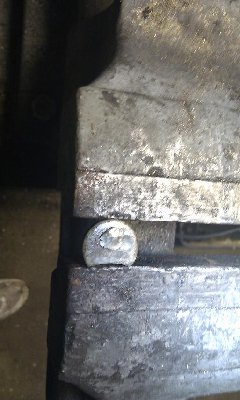

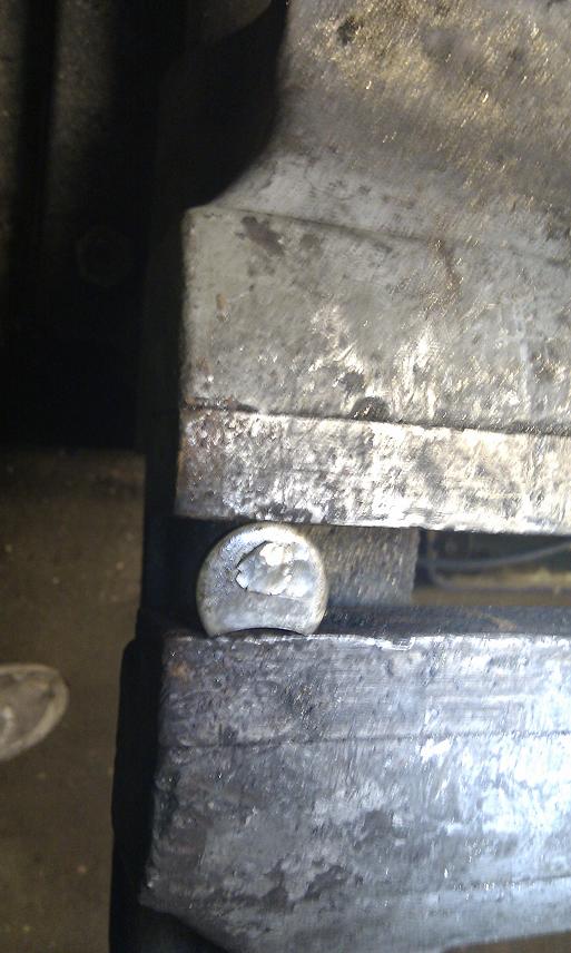

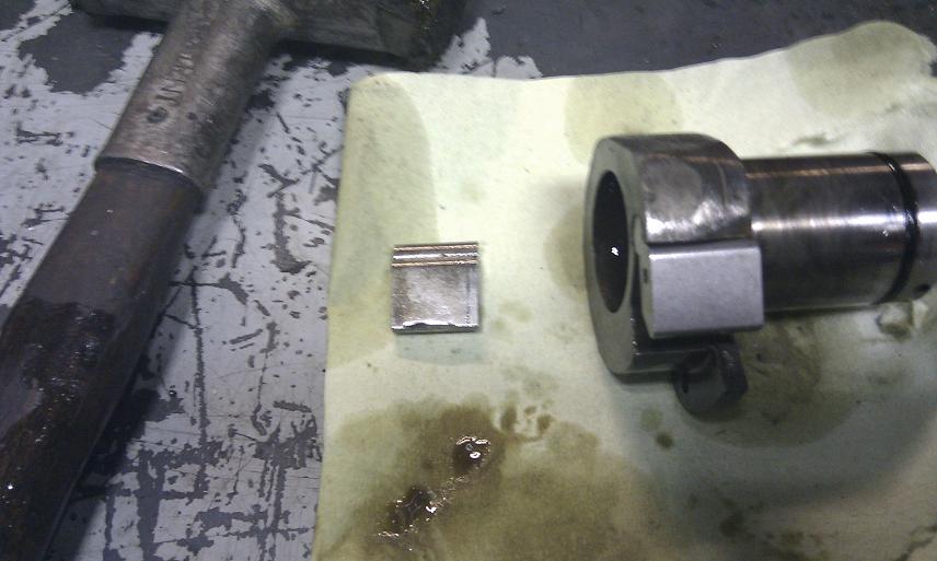

Picture of pawl replacement. As you can see it hardly has any signs of wear. Replaced it anyway, but I kept the old one.
Re: Enfield kickstarter

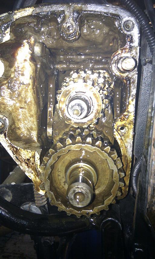

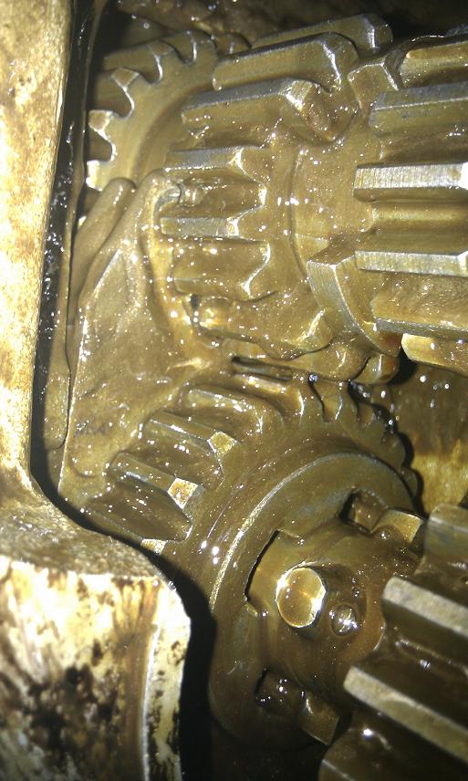

Several pictures of vintage elephant sh*t. Surprisingly it didn't smell as bad as it looked but I'm going to put oil in there in a future session. I think it also contained water. Even though no oil was added after putting it back together, gear changes seemed a lot smoother.
Make sure the plunger and spring are working freely in the hole - if it's sticky it might be why it was not engauging properly.
You should also be able to see the base plate that keeps the pawl out of the way at rest.

The pawl stop plate is what keeps the kickstarter pawl in place. And for much too long. I don't know why, but some people claim their kickstarter engages almost instantly. Either they have a different stop plate, or it was modified. I forgot to take a picture of the modified stop plate, but maybe it will come from a next session.
NOTE: in my case I didn't know that the bolt I was undoing was stuck in this stopplate. I ripped it clean off when dismantling the gearbox and gave Nanko an interesting time repairing it :oops:
