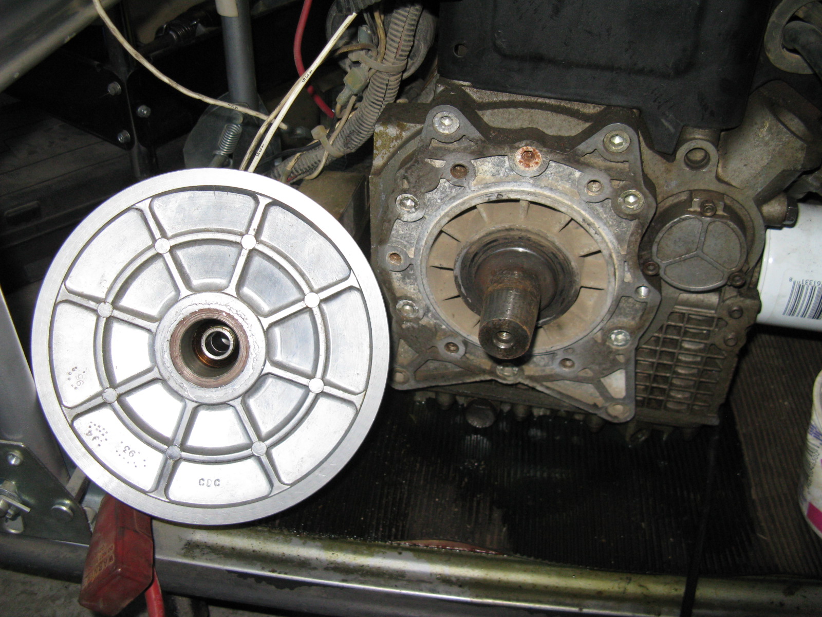

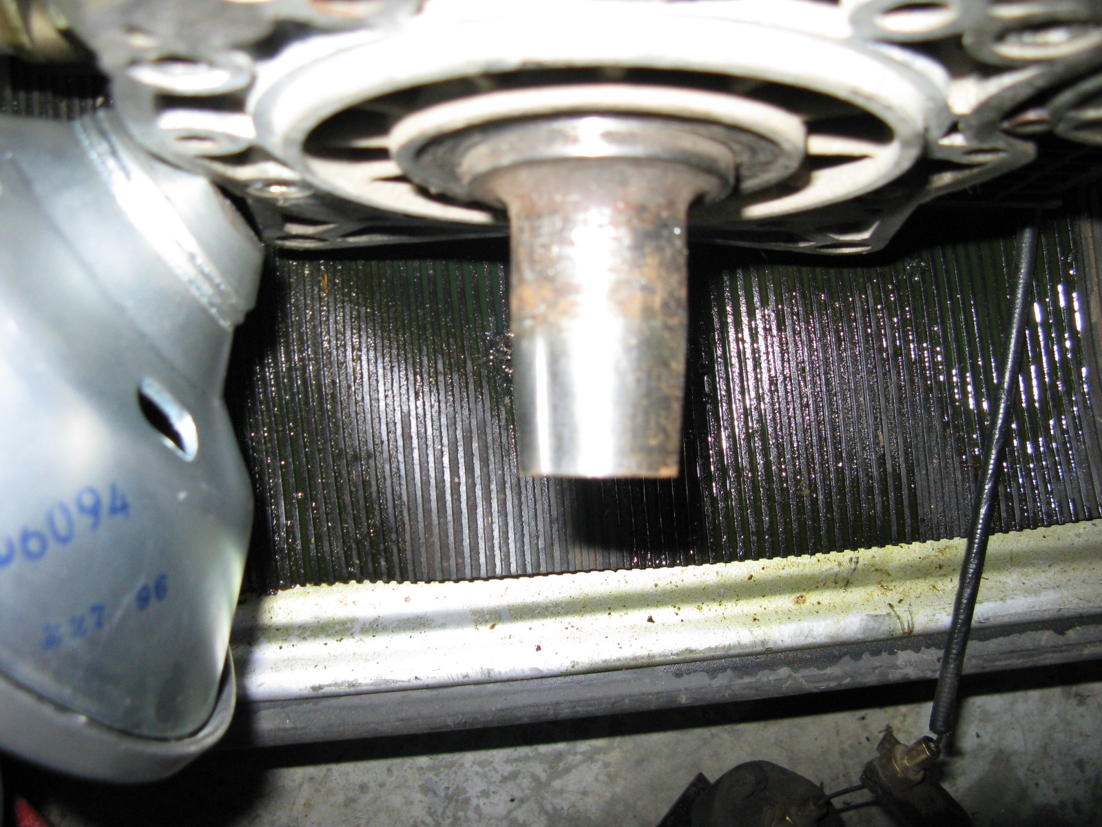

So I finally got an afternoon with my engine and Comet 94C primary, and here is what I now know:
1)my engine (a ruggerini md151) has a 1 1/8 dia. tapered, keyless crankshaft with a taper of 1/8" in 7/8" (I think...could be 1")
2)my comet pulley has a diameter of 30mm and a taper of 1mm in 10mm.
3)comet does not make a pulley with the dimensions of my crankshaft
I'm thinking that an adapter to mate my pulley to my crankshaft is out of the question (different sizes and tapers would take a magician to turn an adapter on a lathe). Comet makes a straight-bore pulley with a 1 1/8" bore. So I have some questions:

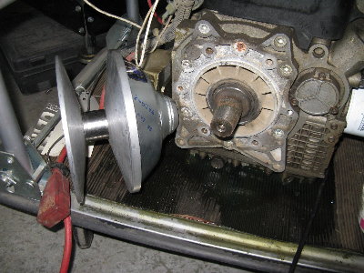

1) is there a way to adapt my tapered crankshaft to a straight-bore pulley?
2) is there a taper-lock setup for my tapered shaft?
3) what would you do?
I did want to go the CVT route, but that dream seems to be dimming. Which the most probable route as converting a 2 stroke transmission ala. mazdog, Sam Brumby and others. But that is only if I can come up with a primary to bolt onto this doggone crankshaft. Thanks, gents.

Could you go at it from the opposite direction? Mount up the pulley in a lathe and cut the taper into it to match your crankshaft? You'd need a pulley with bore same as or less than the small end of the taper on the crank and enough meat that the big end would not be too thin after I guess.

Update on my solution: I have had my machinist produce a "split collett" with matching taper in the bore to enter the outer side of the (CVT hub in my case) drive. It has a center bolt and an outer flange so it can be removed, either with a bearing puller or three small bolts run in through threaded holes, pushing on the drive hub. He also bushed-up the skinny part of the shaft from 7/8" to 1", then mounted the engine on his mill and sliced a woodruff-key seat through the bushing and into the shaft, so I have officially jumped one pesky hurdle... Now for the governor and then frame revisions.
I went through Martin Sprockets' catalog, which has thousands of types of sprockets of all sizes and attachments. Not seeing anything that had my particular dimensions, I emailed the address on their website and within a couple of hours had a response from someone. Several emails and a phone call later, and Martin will be machining a bushing to fit my crankshaft, and sending a #40 double sprocket to fit the bushing. Next step is getting a 48 tooth #40 double machined out to be just a ring with an ID of 5 1/2" to bolt onto (or weld onto) the piece of pipe I will be using to extend my clutch out far enough from the transmission case to line up with my crankshaft sprocket. Interestingly, the Martin guy told me that they can only sell me these parts for testing purposes as they do not make a sprocket that can handle 16hp at 3600rpm. Seriously, even a #50 double sprocket is only good for 14hp at 3600rpm officially. A #40 double is good for 10hp, and a #50 single is good for 6hp. Go figure. Countless Harleys are running around with a #50 double primary. I was originally thinking a #50 single as my primary since my wheel drive chain is a #50 single running out in the water and dirt, albeit at 2400 rpm instead of 3600rpm.
Jeremy, my Ruggerini is set up for variable speed operation so I don't have to worry. What did you have to do with your Hatz?

East German MZ TS and ETZ250 and variants (1974-about 2000) use a tapered keyless crank onto which the clutch fits. Power is about 21hp and peak revs are 6000. Put on correctly, they don't come off - in fact they can be a bugger to remove. 'Correctly' means warming the clutch to about 100°C and doing up tight onto the cold taper (cranks are normally threaded into their end, for this purpose), then leaving to cool with the tensioning bolt done up. Everything needs to be _really clean_. Some people use thread lock / magic goo, but I have not found it necessary. If you put it together cold and oily, eventually the clutch (soft) tends to spin on the crank (hard). If you stop quick you'll just have a buggered clutch centre. More delay, and the crank will have 'picked up' too, hard though it is. If both clutch taper bore and crank taper are in any way 'picked-up', you'll have a sod of a job trying to get a nice reliable fit - in fact in the MZ world, it is not unknown to weld the clutch on at this point (since clutch centre and crank are buggered anyway...one might even change main bearings and seals first!).
So, adapters - well, I made one to re-use a picked-up MZ clutch - I bored the clutch taper out plain, shrank a piece of mild steel bar into it (and put a couple of weld blobs on for good measure), then bored it out taper on my knackered old lathe. The only way I could get the set-over right on the top slide was to put a good clutch up in the chuck, mount a DTI (clock gauge) with a sideways 'finger' on the top slide, and mess about with the top slide angle until I could wind it down the taper without the clock changing its reading. Then swap clock for boring tool and proceed with caution! This worked fine, and I am not much of a turner.
So - it's all possible, even at home.
