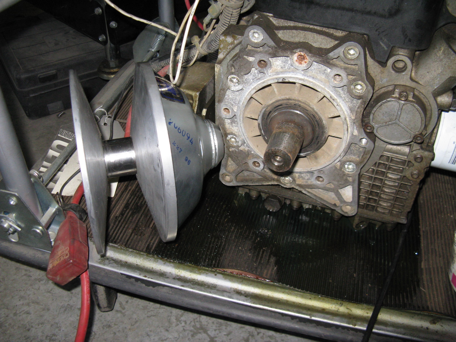

So I finally got an afternoon with my engine and Comet 94C primary, and here is what I now know:
1)my engine (a ruggerini md151) has a 1 1/8 dia. tapered, keyless crankshaft with a taper of 1/8" in 7/8" (I think...could be 1")
2)my comet pulley has a diameter of 30mm and a taper of 1mm in 10mm.
3)comet does not make a pulley with the dimensions of my crankshaft
I'm thinking that an adapter to mate my pulley to my crankshaft is out of the question (different sizes and tapers would take a magician to turn an adapter on a lathe). Comet makes a straight-bore pulley with a 1 1/8" bore. So I have some questions:
1) is there a way to adapt my tapered crankshaft to a straight-bore pulley?
2) is there a taper-lock setup for my tapered shaft?
3) what would you do?
I did want to go the CVT route, but that dream seems to be dimming. Which the most probable route as converting a 2 stroke transmission ala. mazdog, Sam Brumby and others. But that is only if I can come up with a primary to bolt onto this doggone crankshaft. Thanks, gents.

Phil,
Got a pic or diagram of the crank? That said it looks like others are familar with the engine. Hope you get sorted.

- Posts: 212
Re: primary drive options from a tapered shaft
Thanks, everyone.
Sam, thanks for the link to the parts manual. On page 100 of the manual, item 20 (which is called a "plug" on the next page) looks like it could be an adapter to make the shaft a straight bore (of unknown size), although the name does not really suggest that. I'll follow that trail for a while. Incidentally, what bike did the 6 speed transmission in your VF come out of? What do you use for a primary drive? I guess your engine is turning the same direction as your wheels. In the event that I can't get this CVT to work, 6 speeds would be nice, but if I could have the engine running the opposite direction to the wheels and driving the primary from the right hand side of the bike the way mazdog did it on his CB350 ("Kaiser") I would be very happy. This would get my oil filter and filler out in the open, and allow my cooling air to blow backwards, instead of into the wind, although I guess you don't have any cooling issues.
Phil (just a little bit oily:-)

Phil,
Could you go at it from the opposite direction? Mount up the pulley in a lathe and cut the taper into it to match your crankshaft? You'd need a pulley with bore same as or less than the small end of the taper on the crank and enough meat that the big end would not be too thin after I guess.
N

- Posts: 212
Looking at the crankshaft, it is rotating counter-clockwise. That is, when the crank is on the left side of the bike, it is rotating the same direction as the wheels in forward travel.
Philip

I'm going through this same situation with my Hatz 1B30 and a Comet 500; the Hatz I bought was built by factory to bolt up to a generator as Sam has said, and so it has a taper with no keyway. It has a section of 28mm, steps to 7/8" then tapers and threaded hole etc. I purchased a 1" bore driver then bought a spare 3/4" bore spindle new, before the Co. went poof. I will either bore the smaller spindle out to match the shaft, or have my machinist cut a bushing from 7/8" up to 1"and loctite it to the shaft. Either way, we expect to set the motor on the table of his Bridgeport mill and cut a couple of woodruff key seats in line into the shaft/sleeve to make for a keyway, if not being able to cut a continuous one at that time. Then I'll still have the end-bolt to make it come together and stay there. We also have considered the idea of making a split "collet" to go over the taper and grip the bore/shaft as the end bolt is tightened, but this clearly presents the problem of making the thing hard to get apart once it's cinched up. It's real positive, though.
While on this subject, I'll add my standard warning: if you see an un-keyed, tapered shaft on your engine, beware: you most likely have an engine which has been set up at the factory for "static-speed" operation through particular governing, and will not perform satisfactorily under the use we have planned for it. You will no doubt become well acquainted with the process of remodeling the governor to make your power plant into a variable-speed unit, including sourcing the little bits that make the difference and learning how to get it apart, them in, and then it back together again. Maybe you've already discovered this...I was naive when I started. But I saved a thousand dollars...I think.

Update on my solution: I have had my machinist produce a "split collett" with matching taper in the bore to enter the outer side of the (CVT hub in my case) drive. It has a center bolt and an outer flange so it can be removed, either with a bearing puller or three small bolts run in through threaded holes, pushing on the drive hub. He also bushed-up the skinny part of the shaft from 7/8" to 1", then mounted the engine on his mill and sliced a woodruff-key seat through the bushing and into the shaft, so I have officially jumped one pesky hurdle... Now for the governor and then frame revisions.
I went through Martin Sprockets' catalog, which has thousands of types of sprockets of all sizes and attachments. Not seeing anything that had my particular dimensions, I emailed the address on their website and within a couple of hours had a response from someone. Several emails and a phone call later, and Martin will be machining a bushing to fit my crankshaft, and sending a #40 double sprocket to fit the bushing. Next step is getting a 48 tooth #40 double machined out to be just a ring with an ID of 5 1/2" to bolt onto (or weld onto) the piece of pipe I will be using to extend my clutch out far enough from the transmission case to line up with my crankshaft sprocket. Interestingly, the Martin guy told me that they can only sell me these parts for testing purposes as they do not make a sprocket that can handle 16hp at 3600rpm. Seriously, even a #50 double sprocket is only good for 14hp at 3600rpm officially. A #40 double is good for 10hp, and a #50 single is good for 6hp. Go figure. Countless Harleys are running around with a #50 double primary. I was originally thinking a #50 single as my primary since my wheel drive chain is a #50 single running out in the water and dirt, albeit at 2400 rpm instead of 3600rpm.
Jeremy, my Ruggerini is set up for variable speed operation so I don't have to worry. What did you have to do with your Hatz?

Three points caught my interest in the above thread:
1) there seemed to be some uncertainty whether keyless, tapered cranks are reliable for automotive use.
2) there was a lack of confidence that adapters could be made to lock onto them, for use with plain-bore sprockets (chain or belt).
3) someone mentioned MZ250s.
East German MZ TS and ETZ250 and variants (1974-about 2000) use a tapered keyless crank onto which the clutch fits. Power is about 21hp and peak revs are 6000. Put on correctly, they don't come off - in fact they can be a bugger to remove. 'Correctly' means warming the clutch to about 100°C and doing up tight onto the cold taper (cranks are normally threaded into their end, for this purpose), then leaving to cool with the tensioning bolt done up. Everything needs to be _really clean_. Some people use thread lock / magic goo, but I have not found it necessary. If you put it together cold and oily, eventually the clutch (soft) tends to spin on the crank (hard). If you stop quick you'll just have a buggered clutch centre. More delay, and the crank will have 'picked up' too, hard though it is. If both clutch taper bore and crank taper are in any way 'picked-up', you'll have a sod of a job trying to get a nice reliable fit - in fact in the MZ world, it is not unknown to weld the clutch on at this point (since clutch centre and crank are buggered anyway...one might even change main bearings and seals first!).
So, adapters - well, I made one to re-use a picked-up MZ clutch - I bored the clutch taper out plain, shrank a piece of mild steel bar into it (and put a couple of weld blobs on for good measure), then bored it out taper on my knackered old lathe. The only way I could get the set-over right on the top slide was to put a good clutch up in the chuck, mount a DTI (clock gauge) with a sideways 'finger' on the top slide, and mess about with the top slide angle until I could wind it down the taper without the clock changing its reading. Then swap clock for boring tool and proceed with caution! This worked fine, and I am not much of a turner.
So - it's all possible, even at home.
M.
M.
