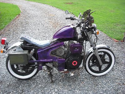

This is the bike the drive is on.
This is a pic of the comet drive. Very tight.
Here is the drive box we made from 4x4 box tube and the shafts we cut.
Here is the top shaft. You can see the drive pulley from the engine on the back.
Heres the bottom shaft. You can see the sprocket for the chain to the wheel.
We ran it last year and it still runs great. I only took it apart 'cause I promised pictures. We cut the shafts and made the drive box ourselves. The bearings are flange bearings that are rated for 7000rpm. We are planning a full rework after this riding season is over. We have a 5 speed Kawasaki trans to go in. Plan on lowering the seat some more and stretching it.

Thanks for the pics Ben. Certainly a novel approach to squeezing the Comet into limited space. Are you using a tensioner on the primary belt drive or do you have a means of taking up the slack? Also, can you tell us what kind of top speed you're getting with that arrangement?

I do have a tensioner on the primary side. Its a simple pulley mounted on a slide with a lock bolt. Pull it tight, tighten the bolt. We made it using pulleys for idlers off a mower deck. We stepped up the speed on the input to the comet to get it to pull lower in the rpm. The drive pulley on the engine is six inches and the one on the jackshaft is 4.5 inches. We have a large rear sprocket, 60 teeth. It runs great 45 to 50mph easy. I have seen 60mph out of it on a downhill. We geared for in town, I hate freeways. Its my cheap college transportation. I get about 110 miles to a gallon. I run cooking oil in it.

Nicely done, phoenix. So that is how you fit a CVT into a smaller space. The extra shafts would add a bit of weight, but I think you might have just made possible another project with an engine and comet 94c I have lying around.
Shall I assume that you don't care for the CVT, hence your plan to install a gearbox?
Why did you "gear up" your primary drive between the crankshaft and primary CVT shaft, and "gear down" with such a huge sprocket on the rear wheel?
Anything you would do differently next time besides not use a CVT?

We sped the drive up to "tune" where the clutch engaged. Normally those drives don't engage till around 1600rpm. This one pulls in around 1000rpm. The large rear sprocket was 'cause I hate freeways,. We geared for in town. I like the comet, but we are on a quest to see just how much mileage we can get. Seems like the comet is costing some in parasitic drag. The five speed has a wider ratio spread and the clutch locks, so no loss. Right now, I average 110mpg in town. Pretty good considering I'm 280 pounds. There is also the custom view, it'll never really be done. There will always be something to improve.

The kaw trans we are going to use has an aluminum case and weights about 10 pounds less than the current unit. (the case we built is heavy.) I checked the ratios in the trans. First is lower and fifth is higher than the comet can get. The range is broader than the comet. We have several rear sprockets, we can tune for optimum rpm that way. We played with different pulleys and different rear gears, If we put too tall gear in, the drive compensated and did not go all the way to the top ratio. It cut its own legs off. this is about maxed out considering how much weight its haulin' around. . One real issue with the comet is that take off is limited to whatever the rpm it comes in at. I do all my riding in town. Sometimes you need more acceleration, People drive like maniacs around here. I could bring the clutch in at a higher rpm to get out of the way faster.
We are going to built a scooter with the drive and probably a 6.5hp diesel. Classic scooter style, seat over the engine, floor board, and step through. We plan on mounting the jackshfts and comet on the swingarm, so the engine will be right in front of the swingarm.
