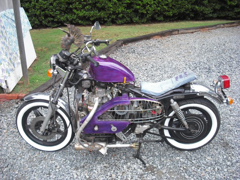

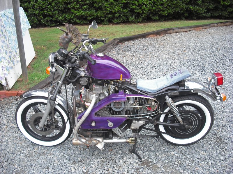

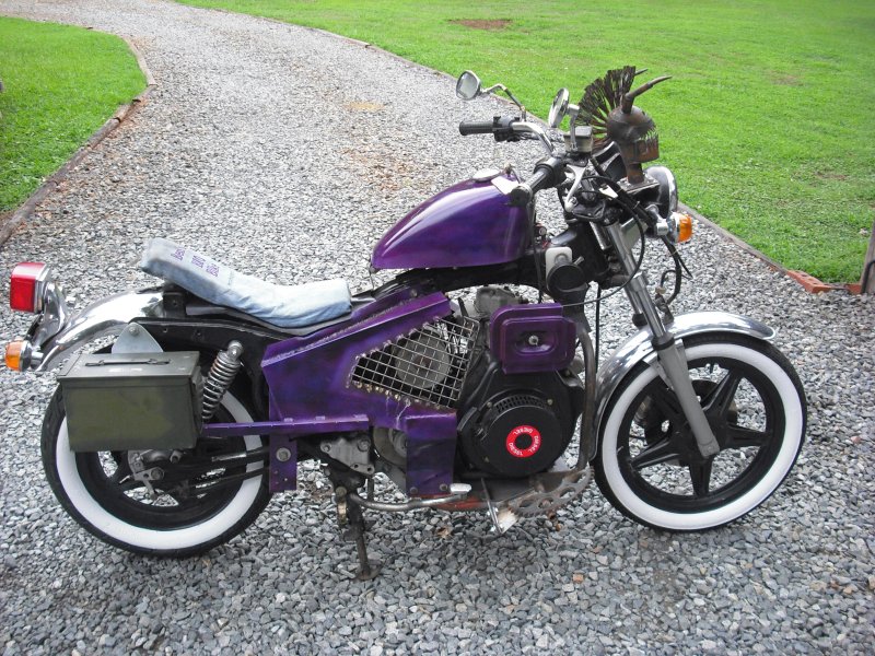

This is the bike the drive is on.

We ran it last year and it still runs great. I only took it apart 'cause I promised pictures. We cut the shafts and made the drive box ourselves. The bearings are flange bearings that are rated for 7000rpm. We are planning a full rework after this riding season is over. We have a 5 speed Kawasaki trans to go in. Plan on lowering the seat some more and stretching it.
