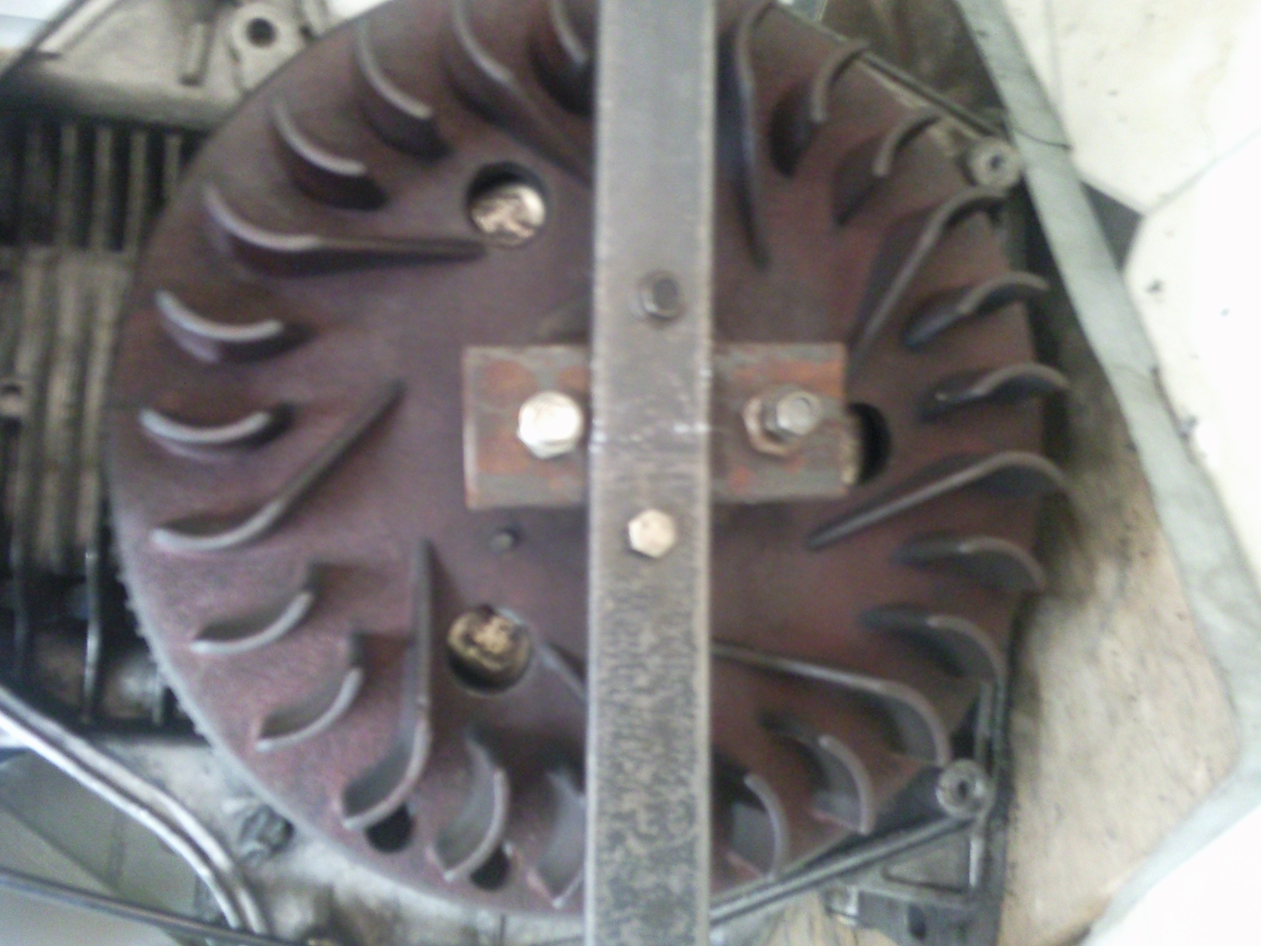

Hi.. The flywheel is very attached to the crank..
i reworked the claws of a 3 legged puly so it grasps in the 3 holes in the flywheel of the china diesel.
it is not ideal. you ned a very big one to fit all around.
A trick is to set it on tension and smack it with a big hammer..

I used a little bit of heat on the flywheel whilst putting a considerable amount of preload on the puller. If that fails a small tap on the end of the puller might do the job ~~ Remember you have a ball raced cartridge bearing in the engine on the flywheel side, so don't get to serious with a hammer.
A
Re: removing flywheel
I took the time to make a device on which you can use the 4 threadholes.. it worked!

arnaud wrote:I took the time to make a device on which you can use the 4 threadholes.. it worked!
Pic is worth a thousand words? Video even more
Finally, as promised, the self-made tool for china flywheel removal.
