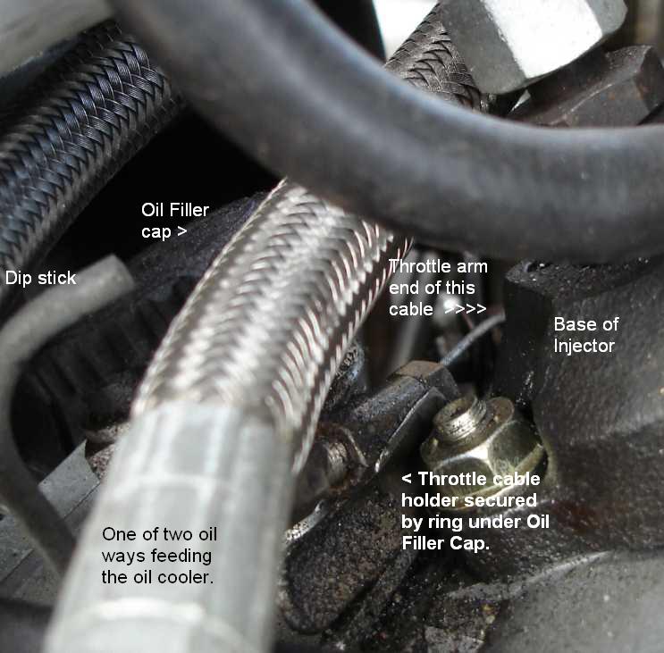

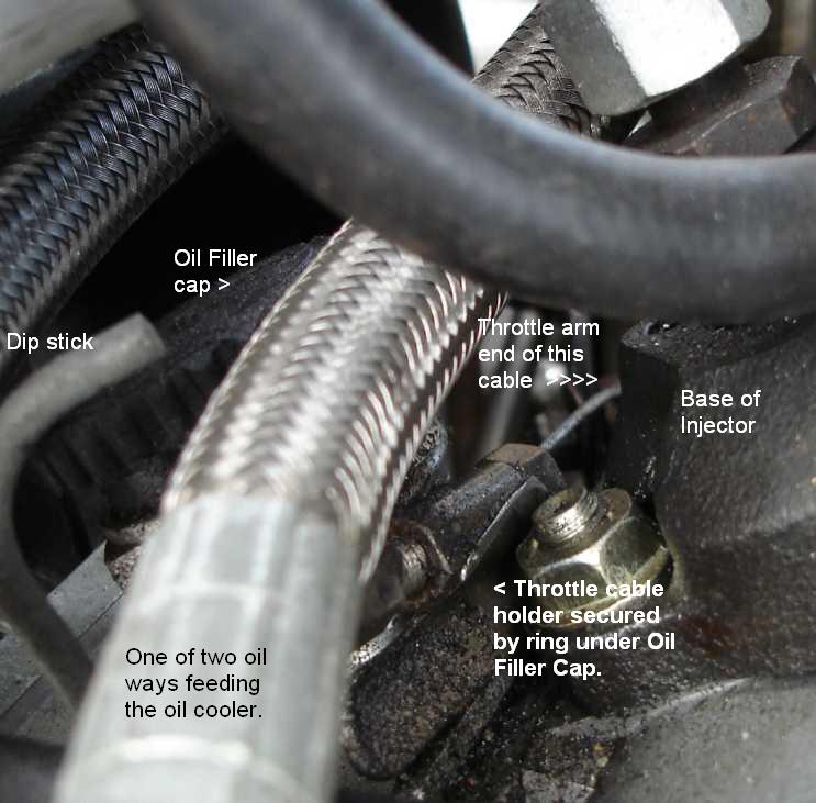

the throttle linkage on diesels can be tricky as you're going onto a guvnor arm. You may have to fabricate a bracket to hold the outer cable. Would you believe the one on my bike has been secured by it being held at the oil filler point :?: :D On my bike the lever is at the back of the engine and is not easy to get at :!: I'm hoping the cable doesn't break on me on the way to Germany next week that's for sure :(

Here's a shot of my throttle cable holder.
Outer cable holder - Ruggerfield
