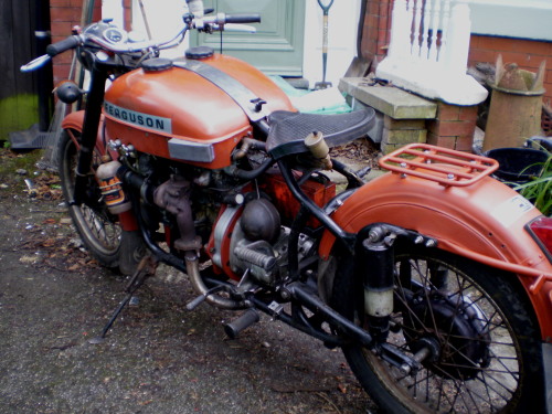

OK, we have an MOT again. Here are some pics from today:
- Attachments
- Dnepr box is in and mods seem to work. Exhaust exits on this side now, to give some room for sidecar fittings on the left. Thin steel around clutch basket calms the noise but only a little. MZ choke lever just visible top right controls cold start device, which appears to alter injection timing a little.

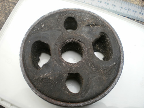

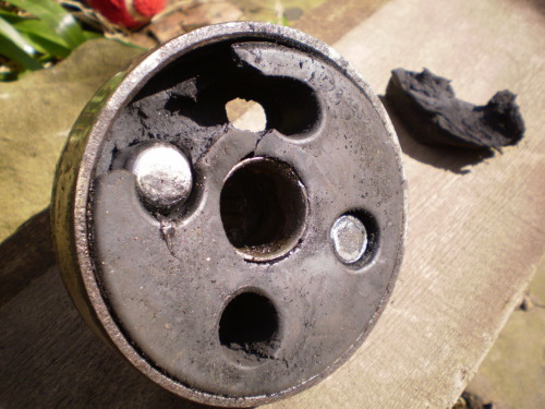

bum - drive donut death. The old Russian rubber donut in the final drive had been there for years, and looked really nasty (see pic) - but still worked. It was hardened and looked cracked. The new one seemed softer, and lasted a week.
This failed just after using reverse (not for the first time), and without the passenger footpegs fitted which have bump-stops which supposedly limit swing arm outward travel. But shockers seem to limit this travel too - so could rear suspension have 'climbed' sufficiently in reverse to mis-align the drive donut? (swing arm squats down under forward drive, and climbs in reverse).
This bike is fitted with 3.2:1 (very) high ratio crown and pinion set, which amplifies the torque impedance (I don't know the right phrase for that) into which the drive shaft and components have to operate. But the old rubber donut lasted, albeit looking ill, for years.
Well, I have a Polish fibre-reinforced donut on order, so lets see if it is any good.

That's the fourth one I've seen gone to bits, I'm working on removing the entire thing from my build.
Sticking with an direct drive using an universal joint.

From memory, there's something odd about a UJ which is different to a CV joint. That is, although one rev in = one rev out (obviously!), depending on the angle made by the two shafts then I don't think the instantaneous shaft speed is the same on both sides of a UJ - it fluctuates above and below a mean - though over the course of one rev it averages out to the same rpm. By contrast I _think_ a CV joint is constant (angular) velocity.
If I'm right then the donut is partly in there to soak up the torsional vibes put in by this twice--per-rev changing velocity factor. I guess (thinking about the drive shaft on a RWD car) then appropriate pairing of two UJs set at the correct relative angle on a shaft may soak up those forces - do you know how this is done?
