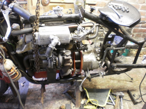

OK, I guess it's time to post the odd progress shot of how things are coming along, now I know the spare engine is a runner. Here's where I'm up to. Dnepr box is in, frame is stretched (another 18mm) as a result. Dnepr kick starts turn out to be different to Ural ones (the cotter is the same but locates on the kick start shaft at a much shallower angle at rest - say 30 deg to horizontal - than Ural ones, where the cotter is at 60-70deg to horizontal with everything at rest) so I ended up cutting the kick start lever and bending it down by 30-40 deg. Hope my welding is up to it. I also made a stainless kick start cotter, as I seem to chew up mild steel ones with boring regularity. I hope it doesn't wear the (hard) shaft on which it locates.

OK, we have an MOT again. Here are some pics from today:
Rather OTT home-made waste-gate linkage - no more rattle.
Dnepr box is in and mods seem to work.  Exhaust exits on this side now, to give some room for sidecar fittings on the left.  Thin steel around clutch basket calms the noise but only a little.  MZ choke lever just visible top right controls cold start device, which appears to alter injection timing a little.
From the right...
From the right...
...and from the left.
