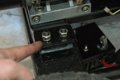

Interesting thank you.bearnyc wrote:... The motor has rubber mounts on the bottom and a head steady on the top. It rocks front and back, but not side to side.
What is a "head steady"
What is the OEM purpose of the rubber mounts you used? Those made for generators or come from something automotive orrr?
Did you hard mount the tranny? Do you think you will need a spring armed belt tensioner on your belt drive to take up slake from rubber mount engine and solid mount tranny?

Re: Punsun HD chopper
Here's a pic of the "head steady". Motor rocks forward and back, but not side to side, keeping the belt alignment ok.
"It's better to regret something that you have done, than to regret something that you haven't." -Gibby Haynes
- Posts: 2227
Gotcha, that looks like it will do the job

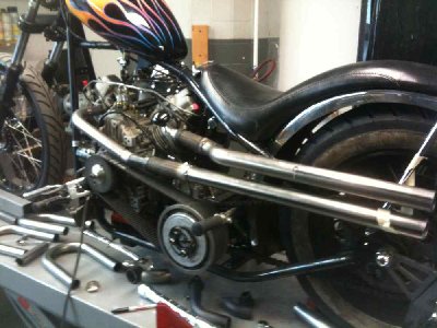

Got the exhaust started today. Here's a pic of Peter working with the flexi bits that were part of the generator's exhaust and then the final layout.

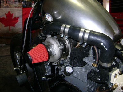

Finally got the motor in and running. Actually seems to vibrate less than the rubber mounted Punsun. Maybe this Longfar has better balance.
I need to finish the primary.
