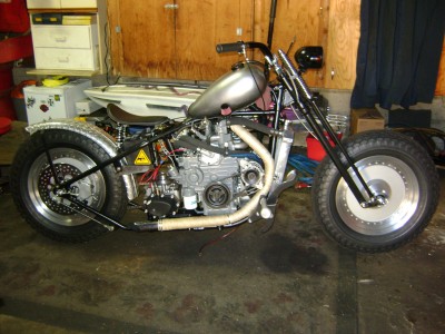

Hi All, I've been lurking here for a while. I've finally made some progress on my build so I'll start a thread. Thanks to all on this forum who've shared their experience, and to those who've answered my emailed questions. Started it for the first time last night. Exhaust, wiring, shift linkage needs to be sorted(before I can ride it), but here's a video of it running(on commercially produced B99 biodiesel):
http://www.youtube.com/watch?v=60QWByhbz-k
It's a Paughco frame(Harley aftermarket) that we cut the tube between motor and transmission and created a "Y" for clearance. Motor is a Punsun from a portable generator that had a tapered output. We had to cut and tap the taper and CNC an insert to fit the Primo from primary pulley. The motor has rubber mounts on the bottom and a head steady on the top. It rocks front and back, but not side to side.

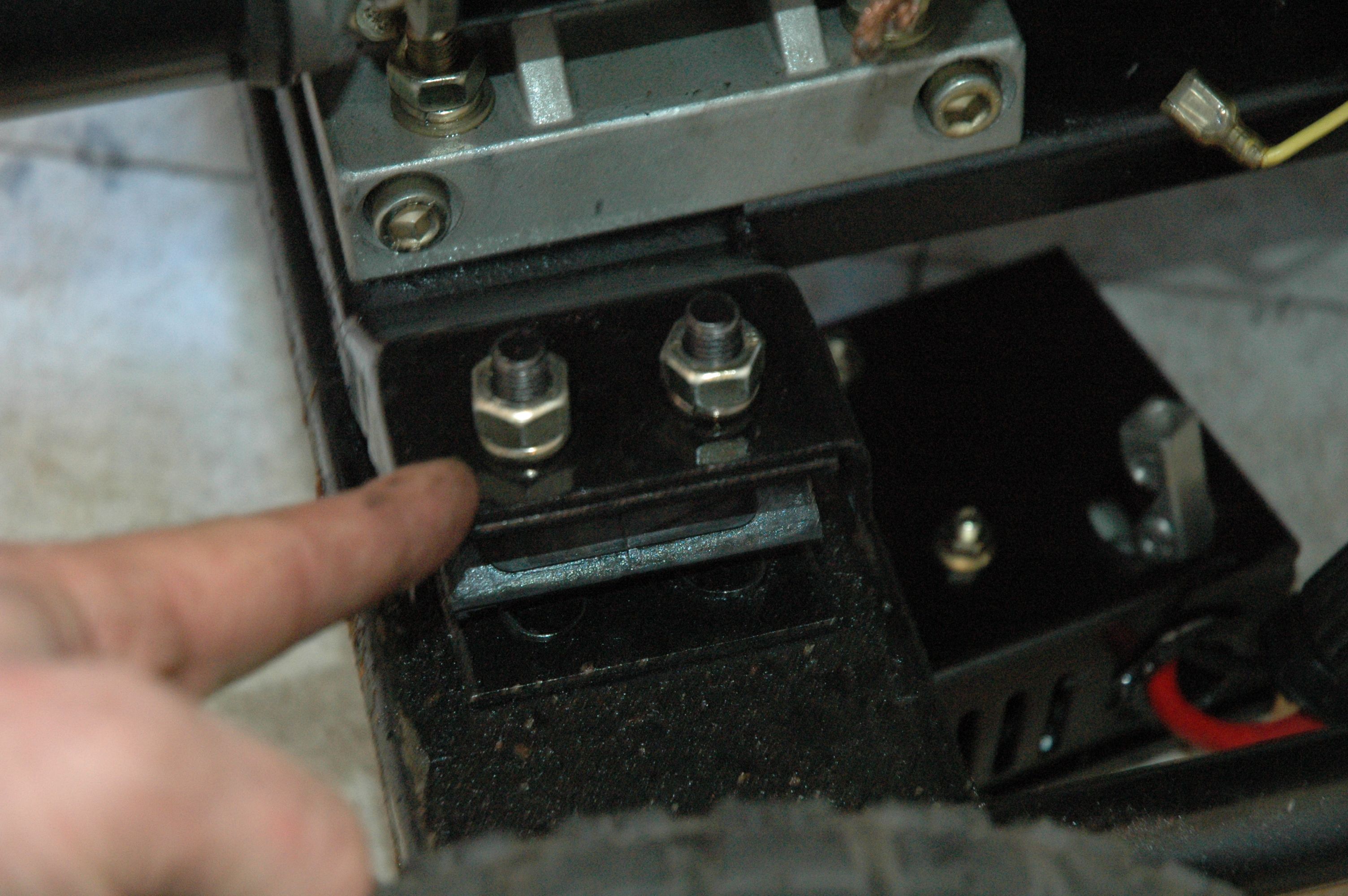

The Punsun was in a portable generator when I met it. It had braided stainless exhaust sections and SOFT rubber mounts(pic attached). The exhaust is still on the bike(with pipes flipped around). I plan on keeping the flex parts of the exhaust in the final setup. The Punsun rocked a LOT in the generator. My rubber mounts are generic industrial mounts from Mcmaster http://www.mcmaster.com/ . After other's horror stories of Punsun's blocks cracking, and the fact that it came to me rubber mounted I felt like it might be best to go that route. I'll take a shot of the head steady today and post it. It's a piece that connects the tops of the jugs to where the HD ignition used to mount to the frame. Transmission is rigid mounted and alignment on the belt seems to be fine. The Harley motor vibrated plenty and the belt drive system allows for wiggling, and may help isolate some of the vibration, at least that's the theory.

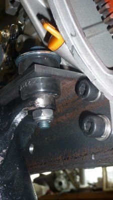

Here's a pic of the "head steady". Motor rocks forward and back, but not side to side, keeping the belt alignment ok.

Re: Punsun HD chopper
Gotcha, that looks like it will do the job :D

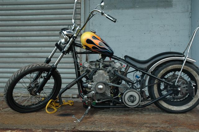

Rode it today. It took a year and a half to reach this point. Here's a link to a(slow loading) shot of it moving:
http://web.mac.com/bearschmidt/bike/fly.html#0
Still have a lot of little things(doesn't shift properly, exhaust is still from the generator, have to start it with jumper cables... ...) but I'm quick to jump on a bike once it moves! :D
I'm curious about the huge amount of black smoke. I had it running on commercial B99 biodiesel, then put in pretty much straight D2 petrodiesel and had no change in the smoke...LOTS(see the video) It smokes under load and when increasing the revs. Does anyone have suggestions on any adjustments or steps to address this?
I'm looking at various exhaust options, and a friend suggested that most motorcycle silencers have fiberglass or something similar in them and that the(huge amount of) particulate in the exhaust would quickly stop this from reducing sound as it clogged it up?? Any experience with this or suggestions on motorcycle silencers with all solid parts inside that actually reduce the noise level?
Thanks!

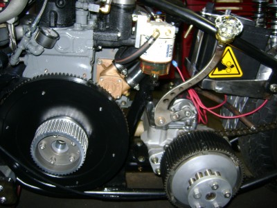

Got the exhaust started today. Here's a pic of Peter working with the flexi bits that were part of the generator's exhaust and then the final layout.

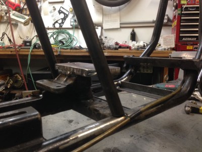

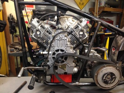

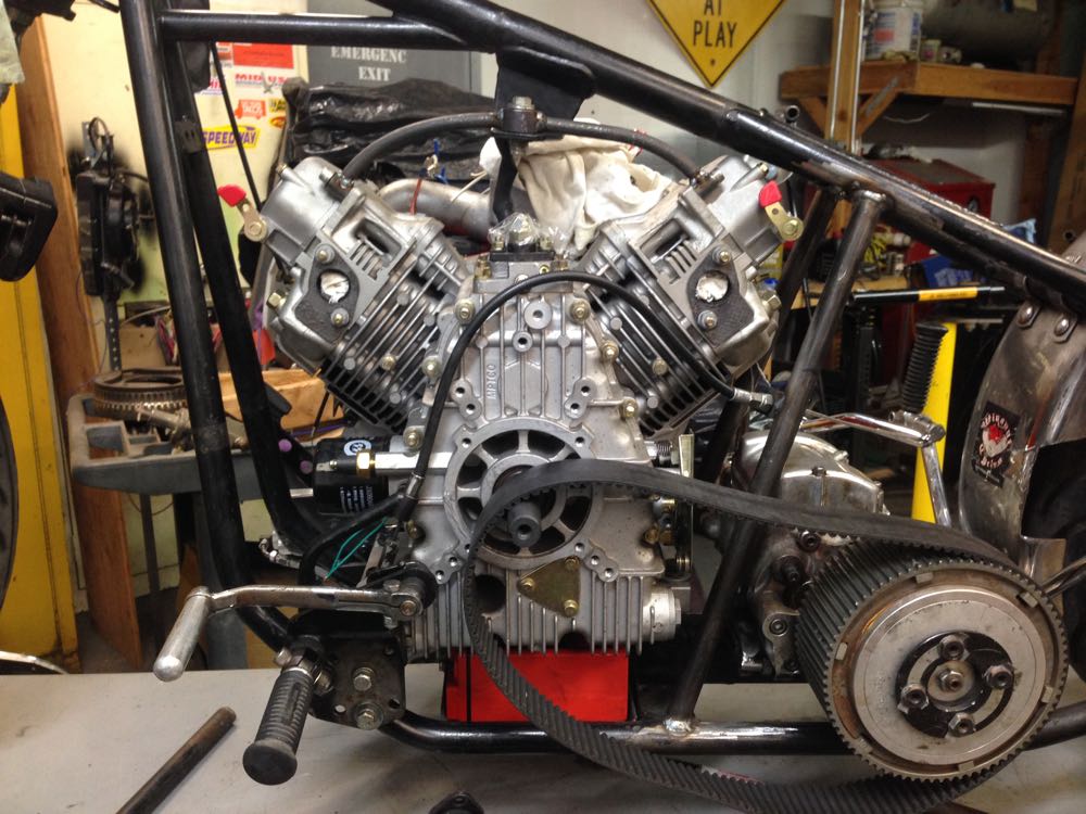

Finally getting around to putting the pig back together. "Iron_Monkey" the adjustments I referred to were just changing the fueling screw. Nothing extreme, just adjusted for smoke.
The Punsun died due to the crank splitting in HALF right in the middle. I forgot to take a pic of it, but will and will post it. It is bizarre that the motor still ran afterwards.
I'm not sure how many miles I put on it(no speedo). Guessing maybe 5k. I really don't know though. Not a lot.
I had 2 Longfar motors that I ordered, hoping they would drop in. They have "feet" cast in the block(I didn't know this) so the mounting to the frame is different from the Punsun(no feet on block).
The crank was removed from one Longfar, but it is not the same as the Punsun.
So....the decision was made to change the frame mounts to adapt to the new case design of the Longfar motor. Theory is that the rubber mounting on the Punsun caused stress on the crank and killed it.
Longfar is now solid mounted to the frame with a new head steady without joints. Maybe the vibration will be miserable. Maybe it will destroy itself without rubber mounting. One way to find out.
Next step is to make a new insert for the front pulley(Longfar is a keyed 1" output and the Punsun was a taper).

Finally got the motor in and running. Actually seems to vibrate less than the rubber mounted Punsun. Maybe this Longfar has better balance.
I need to finish the primary.
