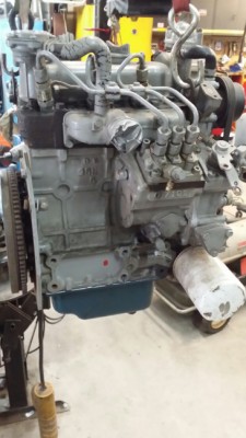

Looks like you can screw the oil filter to either side of the engine. Just out of curiosity, which direction will it be facing? And does either present an interferance?
Re: Build Thread US Diesel Tiger
Here is the cradle tubes for the engine in mock up. These are not the actual tubes. Curtis will give more detail when time comes
pietenpol2002 wrote:Curtis,
??? Where do you get this from? ohhh. maybe I see. the Round cap with the formed in nut head that sits just below the proposed alternator location. You think that is an OEM alternative location for oil filter..... VEWY INTAWESTING!!!!
If it fits the cards I would vote for a bypass block being milled out to sit in place where filter goes and with hydraulic hoses running to the easy to damge oil fiter in a new location such as tuck it in to where it runs along the block instead of poking out away from it. Say either behind the IP or the Starter Motor. Then put a guard over it and the hoses that run to it?
I'm assuming the flywheel will be to the left, placing the filter in its current location to the back of the engine and thus well protected. But not making for a particularly compact arrangement. Is this what you're referring to with respect to a remote filter?
http://cgi.ebay.com/ws/eBayISAPI.dll?Vi ... 1287345993
The other option is the right angle filter mount that turns it parallel with the engine making for a tighter package (seen in the link below just under the dynamo). It can actually be turned 360 degrees to whatever position is needed.
https://www.dieselbikeforum.com/down ... &mode=view
pietenpol2002 wrote:I'm assuming the flywheel will be to the left, placing the filter in its current location to the back of the engine and thus well protected. But not making for a particularly compact arrangement. Is this what you're referring to with respect to a remote filter?
That right angle would turn it same way I was thinking of doing with a unit like the one in the ebay ad and hoses... but more elegantly. Will have to see if I can find such a beast somewhere. where did you find yours?
One on Ebay. Common type though I would use right 90's in the hose ports
Second attempt to post!
You are correct. The filter will be at the back of the engine when mounted. (lower right side) (flywheel to the left side) If it gets to be in the way, being as it's low on the block, I will add a remote mount and put it so that the filter is hanging down so as not to make a mess when changing.
That engine does have the option of moving the filter to the other side of the block. Kinda cool actually.
Curtis in Texas wrote:..... The filter will be at the back of the engine when mounted. (lower right side) (flywheel to the left side) If it gets to be in the way, being as it's low on the block, I will add a remote mount and put it so that the filter is hanging down so as not to make a mess when changing.
Yeah it is pretty cool.. Your idea of point her downward with a remote kit sounds too smart.

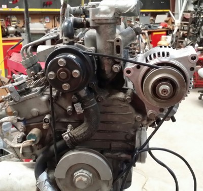

few more pics from curtus
Alternator housing slotted to create a tightly tucked close into the engine alternator. This is pivot point for adjustment. Mounted to OEM tab on block (tab end modified slightly for clearance). Pic is shot from above with alternator swung out wide on pivot point created with this slot
Front View. Note the Alternator housing's mount tab sitting closest to block. This will be the one utilized for belt adjustment setup. Will at some point cut off 3rd mounting point on the Alternator housing to keep nice clean lines and unnessisary width
Just enough room for Headers. Note how using the Triumph Alternator end cap puts the breather holes toward the bottom where the Suzuki were more exposed to the elements. But then again. Ground muck kicks UP off the tires while clean rain kicks down... hmmmm. so maybe Suzki would be better after all??

Alternator almost done. I want to build a brass insert in the engine tab for the bolt to ride on since the tab is aluminum. Here's the Alternator with the new belt on.
It will work like this but for a longer trouble free life I think the bronze bushing will be just the ticket.
Here is the adjuster I made out of aluminum.
Doesn't look like much in the picture, but I milled it out of solid 1/2 inch aluminum plate. Might anodize it before we ride the bike! Then it would look a lot better.
AND, I might still cut that extra mounting hole off of the alternator. But I think I'll wait to see if it causes a problem once we start mounting the engine in the cradle. FYI the alternator sticks out just a little more than the starter motor, measured off the face of the block. And I"m only talking about 1/2 (26 MM), so I don't see it as being a mojor obstacle.
So George, we can pretty much call this problem fixed. Well, we do have to test this alternator to see if it's going to work, but, even if it doesn't it will just be a matter of getting it rebuilt.

Curtis in Texas wrote:Alternator almost done. I want to build a brass insert in the engine tab for the bolt to ride on since the tab is aluminum. Here's the Alternator with the new belt on......It will work like this but for a longer trouble free life I think the bronze bushing will be just the ticket.
Here is the adjuster I made out of aluminum....Doesn't look like much in the picture, but I milled it out of solid 1/2 inch aluminum plate. Might anodize it before we ride the bike! Then it would look a lot better.
AND, I might still cut that extra mounting hole off of the alternator. But I think I'll wait...
Sounds and looks GREAT. One thing off the check list and moving forward. LOVE IT

He's back at the Tribota now. Experementing with brackets to mount jackshaft to engine and making of a Stub shaft.
First was making a centering pin that sits in the pilot bearing hole in the fly wheel to ensure everything stays centered as being made. From there some round plates will be cut out and made to screw into the flywheel clutch bolt holes
Pilot Bearing center pin being made in Lathe
Centering pin sitting in the pilot hole
Primary Clutch in the lathe. The white hub will get basterdized for part of the stub shaft building. the black collar on back of the Clutch will be ground down. It is only needed for the orginal OEM application of that clutch (a UTV) Newer bolts in the flywheel shows that the plate shaft gets welded too will be about 5"? diameter (flywheel is 8.5"). The actual stub shaft will be keyed and it too will be milled down like the centering pin above so part of it will sit in the pilot bearing hole in the crank. This will give it more strength. The stub shaft will be designed to get that Primary clutch tucked in as close to the flywheel as possible.
Side note. Keyed shafts (jack and stub) along with ecentric locking pillow blocks for the jack shaft (7/8") are in shipment so some of this will have to wait

ooops..... issue. "The alternator won't work in front. Going to need to remote mount the oil filter and put the alt in back".
While at that. Curtis says "I am seeing a possibility of putting the driven (Secondary) on a hinged plate (attached to engine?) and having it adjustable with some lock down bolts in a pair of slotted bracket to keep it in the correct position. Looks to have enough room to work with if I remote mount the oil filter.
