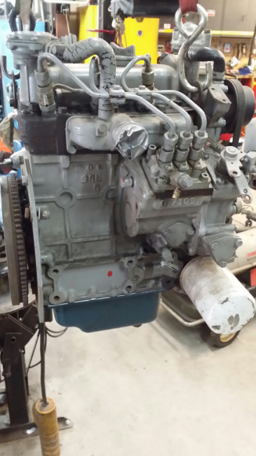

Curtis,
Looks like you can screw the oil filter to either side of the engine. Just out of curiosity, which direction will it be facing? And does either present an interferance?

??? Where do you get this from? ohhh. maybe I see. the Round cap with the formed in nut head that sits just below the proposed alternator location. You think that is an OEM alternative location for oil filter..... VEWY INTAWESTING!!!!pietenpol2002 wrote:Curtis,
If it fits the cards I would vote for a bypass block being milled out to sit in place where filter goes and with hydraulic hoses running to the easy to damge oil fiter in a new location such as tuck it in to where it runs along the block instead of poking out away from it. Say either behind the IP or the Starter Motor. Then put a guard over it and the hoses that run to it?

I'm assuming the flywheel will be to the left, placing the filter in its current location to the back of the engine and thus well protected. But not making for a particularly compact arrangement. Is this what you're referring to with respect to a remote filter?

The other option is the right angle filter mount that turns it parallel with the engine making for a tighter package (seen in the link below just under the dynamo). It can actually be turned 360 degrees to whatever position is needed.

That right angle would turn it same way I was thinking of doing with a unit like the one in the ebay ad and hoses... but more elegantly. Will have to see if I can find such a beast somewhere. where did you find yours?pietenpol2002 wrote:I'm assuming the flywheel will be to the left, placing the filter in its current location to the back of the engine and thus well protected. But not making for a particularly compact arrangement. Is this what you're referring to with respect to a remote filter?

One on Ebay. Common type though I would use right 90's in the hose ports

You are correct. The filter will be at the back of the engine when mounted. (lower right side) (flywheel to the left side) If it gets to be in the way, being as it's low on the block, I will add a remote mount and put it so that the filter is hanging down so as not to make a mess when changing.
That engine does have the option of moving the filter to the other side of the block. Kinda cool actually.

Yeah it is pretty cool.. Your idea of point her downward with a remote kit sounds too smart.Curtis in Texas wrote:..... The filter will be at the back of the engine when mounted. (lower right side) (flywheel to the left side) If it gets to be in the way, being as it's low on the block, I will add a remote mount and put it so that the filter is hanging down so as not to make a mess when changing.

Use to remote mount my race car oil filters all the time. It's the best way to get the filter out of harms way.
