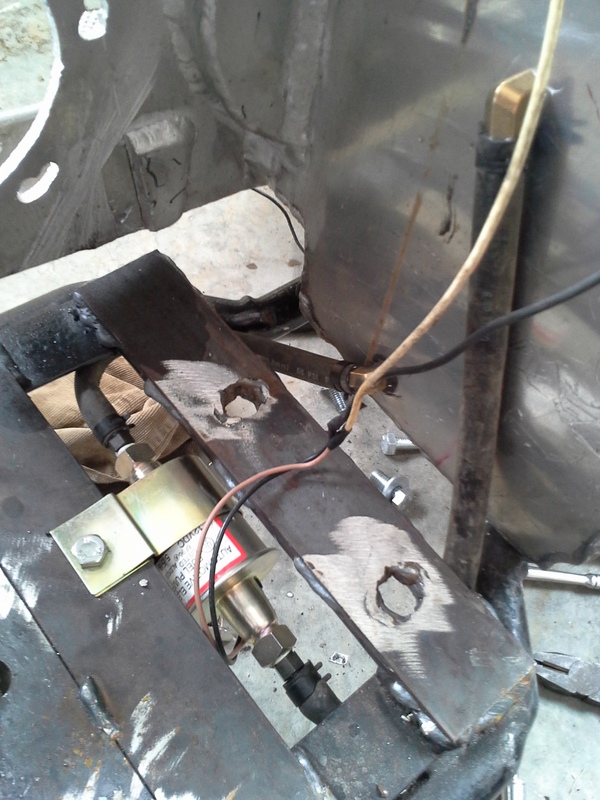

Post by albertaphil »
Here is a picture showing the oil pump. You can see it down at the bottom between the engine mounts. When I tested it with a straight pipe it really seemed like it would shoot the oil far enough to reach the gears.

Consider making a spray bar inside the tranny. Something like fuel line with the end capped and small holes drilled in it strategically over gears etc. Affix the bar to the inside by brazing it to the wall you made? Another option is to maybe make a tree off tubes along the outside of that back wall you made and then elbow them into the tranny at different locations to hit a broader area of inside of the tranny. The outer tree may act as an oil cooler too?

My thinking is that oil dropping onto gears spinning at 3000+ rpm will produce a veritable fog of oil inside the trans case. In not actually concerned about the gears since they weren't really lubed by anything more than mist originally. It was the bearings that were pressure lubed by the engine oil pump

Im hoping the fog of oil Will make it to the bearings and clutch shaft bushing.
As for the spray bar Idea...I thought of that too but I have learned that the 9psi produced by the little fuel pump is not adequate to spray anything. I attempted to get the oil to shoot farther by necking down my elbow fitting. All it did was reduce oil flow.
So I replaced the elbow fitting with a straight nipple and It now works like I expected it to.
