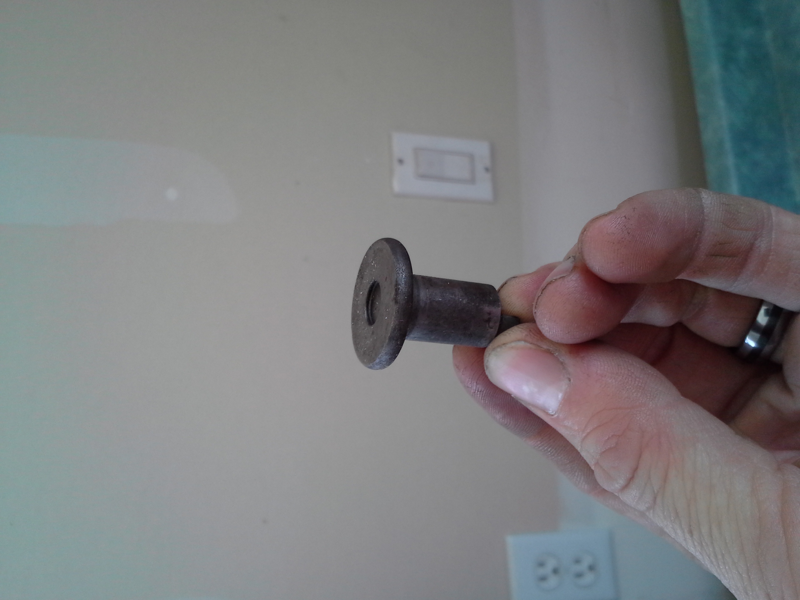

The original clutch-pusher thingy.  Actually it isn't the original, but it is very much like it.

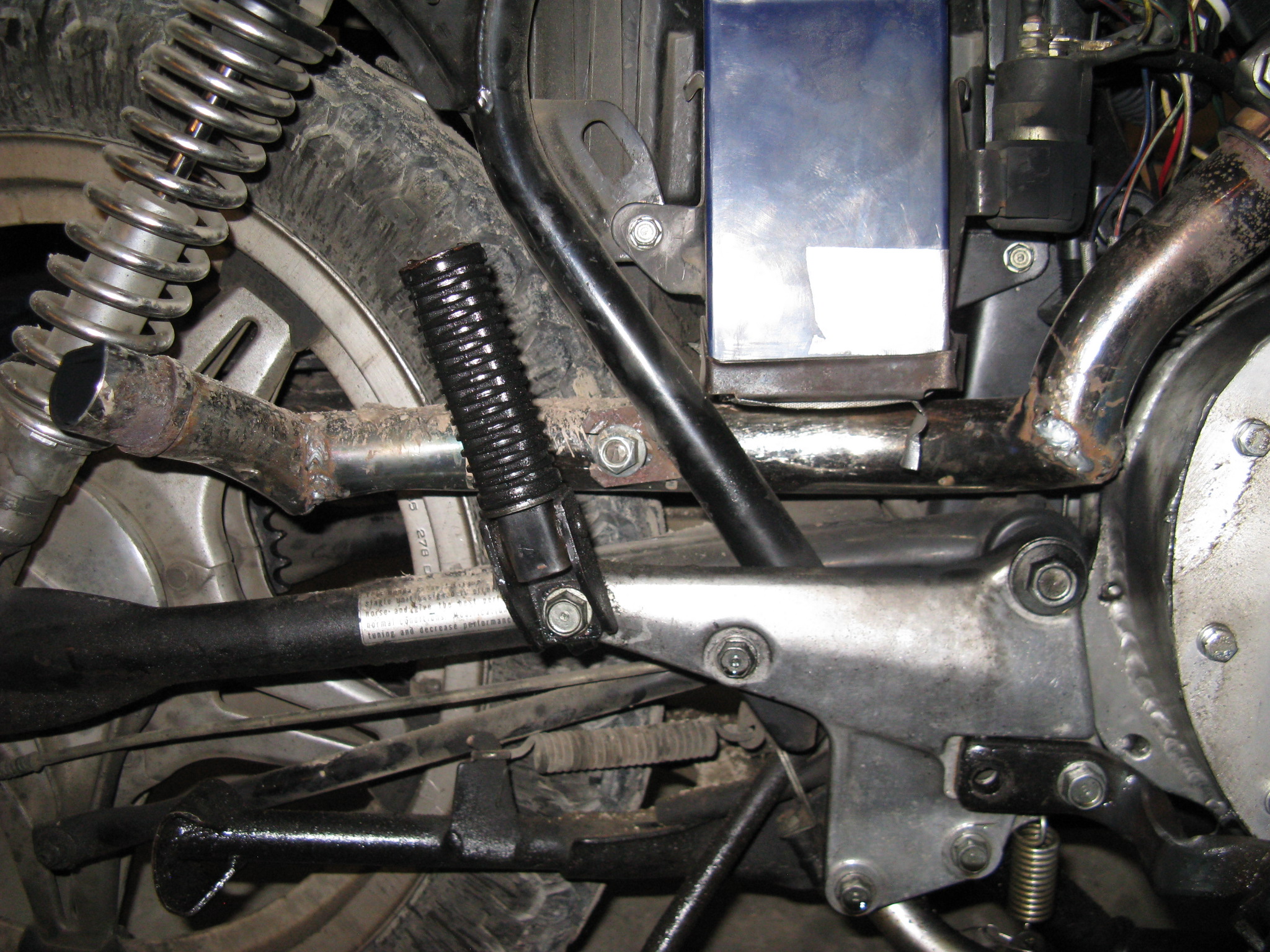

Detail of my cut and rewelded Honda exhaust pipe.  I'm confused...does it count as a ratbike if the crappy parts seem unintentional?:-)
The tailpipe I build from the original Honda double wall chrome pipe, cut at angles and rewelded to get the right "curve." Leaky and restrictive for sure.  To be replaced eventually.
My horrible exhaust header made from an old chunk of VW pipe.

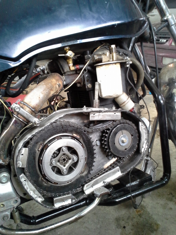

The completed primary drive.  I used a piece of ready rod to adjust tension on the primary chain.  It hasn't stretched much.  I hope the tensioner lasts.  It was originally what tensioned the big laminated chain that went from the crankshaft to the transmission on a 1981 Honda CB1100.  In that application it was tensioned by engine oil pressure.
Clutch-pusher thingy in place in the primary cover.

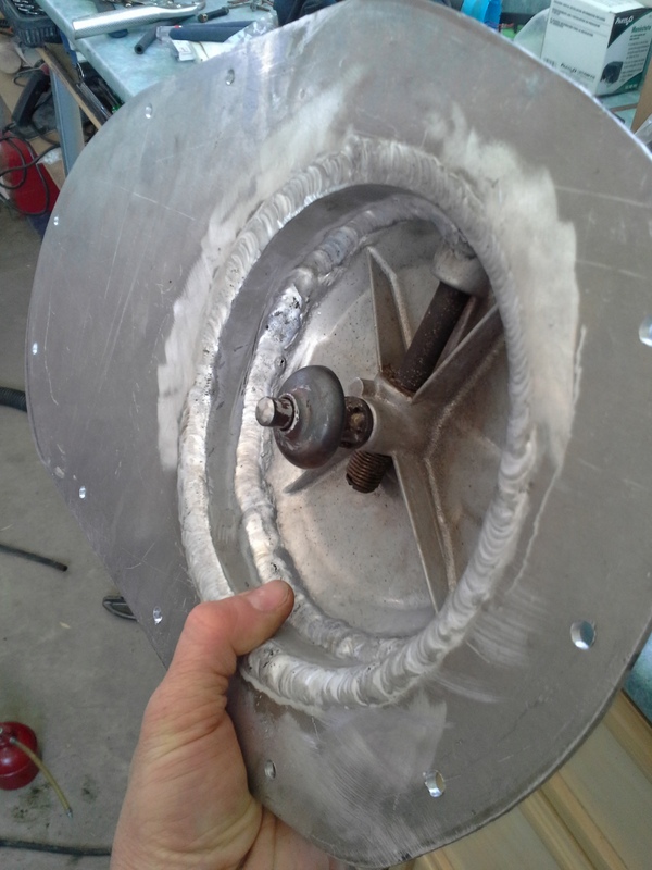

My revised clutch-pusher thingy.  I had to make this much longer than the original, and I made it to stick into the inner race of the bearing in the middle of the clutch disengagement plate so that everything would stay centered. Hopefully the little bearing doesn't wear out too fast.  The curved cup is from a mcpherson strut.  I just used it because it fit nicely around the rod I extended the clutch-pusher with, but its outer diameter was the same as the inner race of the little bearing.
