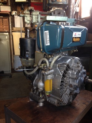

Chinese Fuel Filter Arrangement
Posts: 2002
Re: Robin DY35 Starting Issues
Since this is a glass bowl.....
Prime and start her up.
What goes on in the glass bowl? Lots of bubbles? Does it begin to fill with more air than fuel?
Before it conks out....... remove the fuel cap off the tank and see what happens.
gilburton wrote:Am I right in thinking the "angled" connection behind the tap is the inlet which fills the bowl "outside" the filter and the other straight one is the feed to the pump from "inside" the filter?
Looks large enough to me.
Yes you are correct re the running that's why I still suspect a fuel flow or air problem :)
Yup thats right, the one in the center is the engine connection, one on the oustide fills the filter from the outside.

Comparing the picture of your engine with the PDF on the web site there does appear to be a difference but that may be cosmetic and the functionality of the engine is the same.
Eddy.

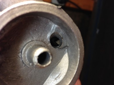

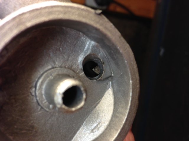

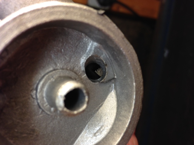

Fuel Filter Housing (blocked)
