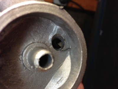

Had another go at starting the DY35 today.
I checked the fuel supply and found only a very slow flow into the pump. I then decided not to be quite so tight and fill the tank up (well 1/2 fill the tank). That immediately increased the fuel flow!
I remounted the engine to my test bench and started it with a little help from Mr Easy Start
I thought I had it cracked but it died after about 20 secs and is back to giving fuel starvation symptoms
I can get it popping and running for very short periods but nothing longer than a few seconds. I'm beginning to wonder if this is why the engine was removed in the first place!
If I have a good flow to the pump, is it worth stripping the fuel pump? What would I look for? I guess I could start swapping bits from one of my other 2 Robin DY 41 and 42 engines which both run fine.
Any advice appreciated.

Start with simple stuff. Sounds like as the engine gets going the vacuum from the pump builds enough vacuum to start pulling air in from some place.
Try running it from a fuel can to see if there is a leak between tank and fuel pump.
On this model is the IP and the fuel pump all in one? Another words is there a pump to move fuel from tank to IP or not?

Possibly your aftermarket filter/tap is not letting enough fuel through so after your initial bleeding/setting up a good flow it runs until it uses up the fuel in the line then struggles again??
Using a genuine filter/tap once bled the fuel should literally pour out of the bleed screw on the pump, by gravity, assuming all the air is out of the glass bowl.
Just turn on the fuel then loosen the bleed screw on the pump. If no fuel comes out within a few seconds the filter is the problem. No need to physically do any bleeding the fuel should flow by gravity!!
Once happy with the flow tighten up and bleed the injector.
I had this sort of trouble using the cheap in line plastic disposable filters you can buy in bulk.
They just weren't letting enough fuel through possibly they were too small or petrol ones don't suit diesel??
Assuming it's letting fuel through,no air is getting in and it's pumping fuel to the injector it should run??
You do have copper washers on the banjo joint on the pump??
Is there an arrow on your aftermarket filter or can you put the link up if bought on ebay??

Am I right in thinking the "angled" connection behind the tap is the inlet which fills the bowl "outside" the filter and the other straight one is the feed to the pump from "inside" the filter?
Looks large enough to me.
Yes you are correct re the running that's why I still suspect a fuel flow or air problem

Just to close this thread, I'm pretty sure I have identified the cause of my problems.
I stripped the new (Chinese) fuel filter assembly as it appeared the flow was at least 50% less than the original Robin fuel filter I fitted. I found the rubber seal in the fuel tap partly blocking the fuel passage. (See photo). I cut the hole to the correct profile (to give full flow when the fuel is turned on) and re fitted the assembly.
When I undid the bleed screw on top of the fuel pump union, the fuel gushed out. When I originally fitted the filter, it just about trickled out. Maybe that would have been a good time to check the seal! Just because something is new, doesn't mean it's not faulty!
I have now started the engine and it runs fine
