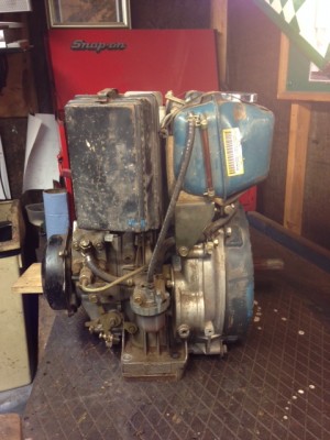

Guys,
The following Robin Diesel has come up on e bay.
http://cgi.ebay.co.uk/ws/eBayISAPI.dll? ... TQ:GB:1123
The owner can't find a model number or plate. It looks like it's been repainted at some point so the colour doesn't provide any clues.
Can any of you tell? If it's a DY 41 or 42, it would be ideal for my Robin Enfield project.
Any help would be appreciated.

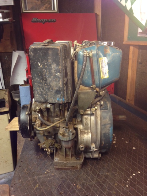

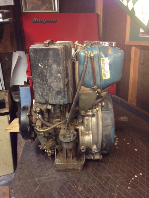

It's very difficult to tell just by looking. I would suggest it's a DY41 due to the oil bath air cleaner as I believe the DY42 had the square plastic disposable type filter???
If you knew the actual make of the pump as a whole it might give a clue as I don't think Robin actually made a pump and just supplied the engine?
The only thing I know about the number location is that mine had a number beginning with DY 41-------- etc. stamped on the edge of the mounting foot below the starter motor. Mine also had a sticker on the cam cover where the pull start is on this one.
Pity it's so far away from you!

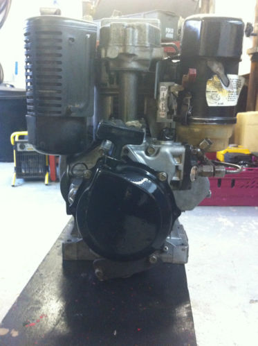

Just an afterthought . I believe the DY35 had different dimensions for the mounting holes?? If you check out some of the pdf manuals I sent the dimensions are on there somewhere.
This would at least rule out it's not a DY35. The DY41/42 are identical.Not sure if the DY35 ever had an electric start??
Maybe Tony Dymott could help as he has bought an engine he thought was a DY42 but the mounting holes were different to the ones on his bike.

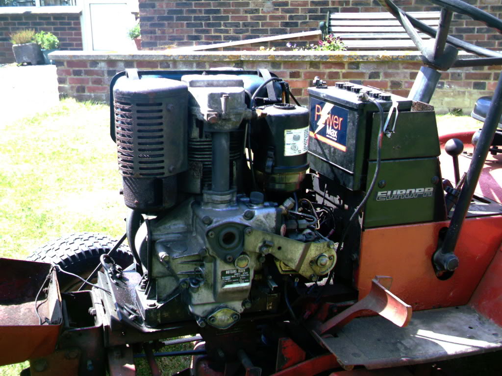

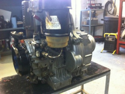

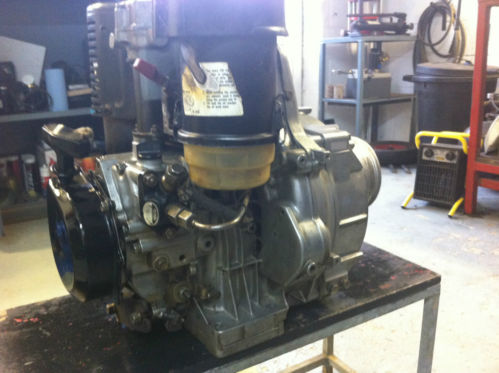

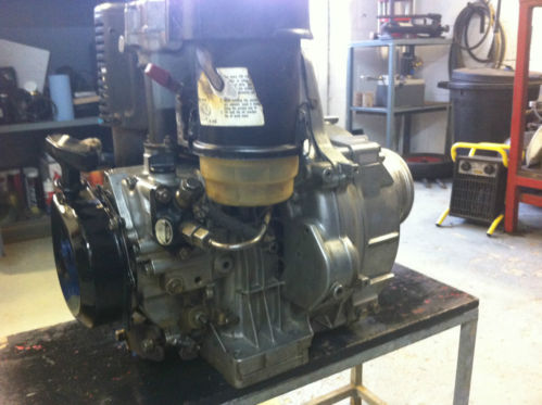

Here's the sticker I mentioned on the cam cover. Probably the pull starter is covering it??

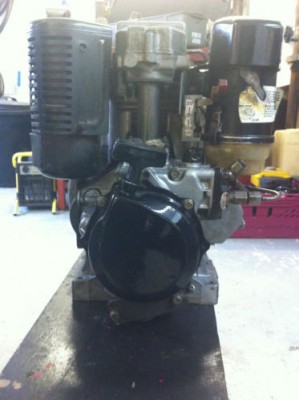

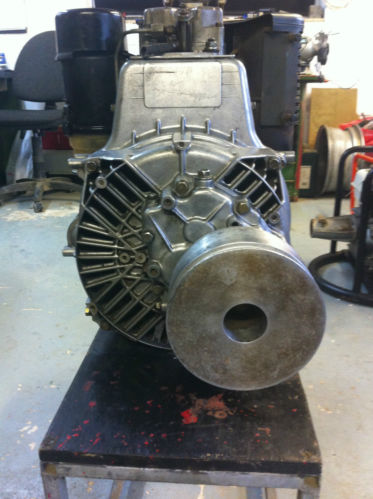

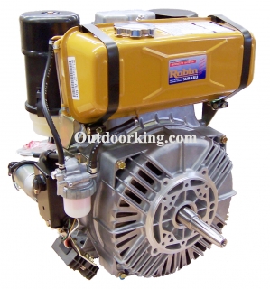

Hold on a minute!! I now believe this engine may be a DY41B It's difficult to see on the pics but the DY41B is the model with a gear reduction built in to the flywheel cover.
If you look at the pic in the ad where you can see the "join" between the engine/pump there is a casting on the flywheel cover housing the gears!!
Also the drive to the pump seems not to be in line with the crank??
I don't know but I assume the flywheel cover could be removed and a standard one bolted in its place??
I don't have any experience of that version so i don't really know what would be required to convert
I've looked at the pdf service manual I sent you and it would appear the flywheel cover just unbolts complete with the reduction gearbox so then all you would need would be the standard flywheel cover??
Have a look at section 10 of the service manual.
The seller might be mistaking the B for a 5??
Pic of standard cover. Compare with section 10 of service manual.
https://www.dieselbikeforum.com/down ... ew&id=1829

o.k, just got back from Southampton with a Robin DY42 in the boot
Thanks Joe for all your help. Your a star mate!
Having never handled a diesel engine before I was surprised how heavy it was! We got it home, Put it on the bench and decided to see if it would start. With me in charge of hanging onto the engine and controlling the throttle, my Son pulled the starter. After several pops and pulls, to my amazement it started! (probably the first time in quite a few years) I hadn't actually planned for this eventuality as a petrol engine would need quit a lot of stripping and cleaning. I now had a 10hp engine running at 3000rpm trying to escape from my shed! switching it off just made it jump higher until it came to a rest. With my Son and I grinning like kids, we decided to do it again! Blimey, I can't wait to get it bolted in a bike frame!
Output shaft is in line with the crank which is good. I pick up my DY41 electric start jet wash Saturday. Can't wait!
I've attached a couple of photos'

I see you've now got the correct drive shaft. I expect it will be 1" ?
I don't think the flywheel cover is a Robin one so I think you will still have to source a genuine one so that the enfield chaincase can bolt to it(I think)
If you want to start it again screw it to some planks or a pallet etc.
Before you do that remove the diamond shape plate below the starter and you drain the oil from there. Lean the engine over to drain it all.
On the back of the plate is a fixed filter.
These engines are well constructed and they use O rings/seals a lot.
I washed mine out but that is how they come complete with plate.It pushes back on to a hollow spigot so you may have to gently twist it to get it off?
Fill it with any motor oil just to flush it out and check the fuel filter bowl.
After all it has been standing and they all seem to be neglected a bit when it comes to routine maintenance.
Most of the weight is the flywheel. Don't drop it when you remove it
You just need to see if the electric starter will swap over but fingers crossed
You could use the jet wash to clean this one?

I'm now the owner of a DY42D, a DY41B (with electric start) and as from today, the DY35 shown in the photos.
The DY35 says it's a 'D' (3600 RPM) on the name plate even though it appears to have a reduction box. I'm guessing it's got a shorter stroke. My intention was to replace the DY41 engine in the jet wash with the DY35 and sell it on. I have yet to start it, but it has been well looked after and only done minimal work. I guess I can measure the output shaft speed of them all to see what my options are.

Well done! At least you can now compare some of the differences
Have you investigated the flywheel cover situation and removed the reduction gear just to see what's what??
The standard cover has lots of SAE drilled/tapped holes to which(I believe) the Enfield chaincase bolts either directly or by the use of a spacer/adapter??
