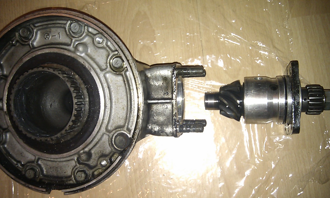

My project is a Kwak ZL cruiser married to an Lombo LDW702. The layout is similar to 'Modite' in germany, if you've seen it.
I'm attempting to retain the shaft drive. Unfortunately the shaft is on the left and counter-rotates compared to the LDW flywheel.
I could find a bmw/goldwing/CX right hand shaft/hub, but that also means changing swing arm assy, rear wheel, disc,caliper etc. Has anyone tried flipping the swing arm + rear hub over? Running upside down in effect. The pic shows the gears cut for one direction, but when we throttle off, on the over-run, its the wheel driving the engine, using the back of the gears anyway?
AND whereas the original engine delivered 100bhp thru the gears, the Lombo will now only be pushing 17-ish hp. The breather hole would be switched. Even if the gears mesh ok, the oil reservoir is redundant, with possible oil frothing prob?
Some words of engineering wisdom would be most welcome.

ZL1000 rear hub
ZL1000 rear hub
