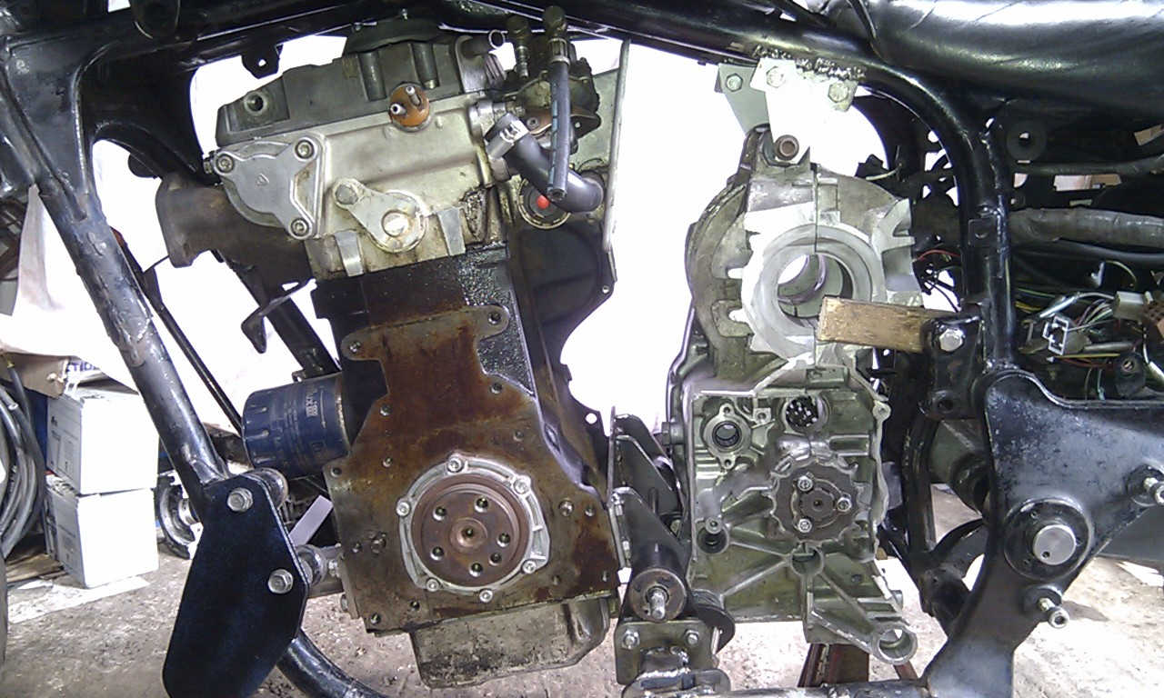

My project is a Kwak ZL cruiser married to an Lombo LDW702. The layout is similar to 'Modite' in germany, if you've seen it.
I'm attempting to retain the shaft drive. Unfortunately the shaft is on the left and counter-rotates compared to the LDW flywheel.
I could find a bmw/goldwing/CX right hand shaft/hub, but that also means changing swing arm assy, rear wheel, disc,caliper etc. Has anyone tried flipping the swing arm + rear hub over? Running upside down in effect. The pic shows the gears cut for one direction, but when we throttle off, on the over-run, its the wheel driving the engine, using the back of the gears anyway?
AND whereas the original engine delivered 100bhp thru the gears, the Lombo will now only be pushing 17-ish hp. The breather hole would be switched. Even if the gears mesh ok, the oil reservoir is redundant, with possible oil frothing prob?
Some words of engineering wisdom would be most welcome.
Regards to all, Bob.

Flywheel facing forward looked a winner with the cvt driven from the timing belt end, but I'm hoping to fit it without any frame mods, and the downtubes are just a few mil from the flywheel, and I couldnt get the starter motor in. I could move the engine back, but then not enough room for my CVT, that is until Tappy puts a super-slim cvt on the market! I've looked at every configuration, even buying a 2-stroke lump for the clutch/gearbox 'sbrumby' idea.coachgeo wrote: Another option is to go fly wheel forward. Chain or belt off your CVT to an intermediate drive shaft that runs along side the block to a Ujoint at the swing arm that the final drive attaches to. One advantage to this is you can change sprockets on the chain portion to adjust the final ratio's output. Course you could put secondary CVT clutch right to the intermediate drive shaft too but loose the final drive adjust ability of the added chain
CVT primary will run off the flywheel, and, as Coach suggests, use a short chain drive off the CVT secondary, as you say, to be able to adjust sprockets/gearing, and also to keep the engine central in the frame. I will have to look into Stuarts alternator idea, as I'm about to lop off the bracket.gilburton wrote: Are you running a chain from driven pulley to shaft??
As coach says turning the engine round would solve the direction problem but will need a shaft(old car drive shaft for instance) down one side. Could the drive pulley be attached to the bottom pulley shaft of the engine if turned round?? and the alternator be relocated to the flywheel end??
Using my upside down drive is tempting, but I'm hoping to cross continents on it, so I've been watching (on Fleabay) a GL1200 swingarm/hub/wheel up in Cumbria, for notalot of duckets. well, by chance a customer has offered to pick it up for me, so we'll see what develops.
One things for sure - It wont have 'Modite'* looks, or teutonic build quality! Thanks.

We're talking length in this particular setup. Looking at the pic he has the CVT vertically behind the engine with the driven pulley at the top. This means any additional length will probably put a chain drive with oil bath too long to fit behind the CVT and between the swinging arm and still line up with the uj joint of the shaft. The drive has to come down from the top pulley to the shaft but extra pulleys put in as well to reverse the drive.
This is how I imagine it with whatever type of drive chosen.
I've viewed it from the front of the bike and I don't know the actual rotation but it works either way.

Redkite
- Posts: 24
- Joined: Mon Aug 23, 2010 10:31 pm
- Location: Central England
Re: Shaft drive dilemma
An overdue update for my build.
Thanks for some interesting ideas and suggestions from Gilburton, Tappy, Coach and pietenpol, and Ian, who I met at the Big Knock, also SBrumby, who's creations can be seen elsewhere in this forum. Mounting my Lombo LDW702 diesel twin inline was my first choice, but I faced many difficulties. Mounting the CVT, reversing the rotation, looking back, I should have ditched the Kwak frame and tried a BMW K75 or K100 or any rolling stock with a right-side shaft-drive set-up, where the engine is a stressed member, but I was too attached to this bike, with its laid-back riding position. I finally settled on a transverse layout, This meant dumping the shaft and go with chain, thus building a new swing-arm. The CVT concept is great, but if you want to mount transverse engine central in the frame, the cvt sticks out a mile (Ex Aixam Cvt's anyway). I have no main stand, so I'd like to have a neutral, so I needed some cogs.
I don't like a right-side gearchange so that ruled out a british gearbox, phosphor-bronze bushes and all, and a harley box is equally last century design and overpriced. I wanted a nice silky smooth (cheap) Jap tranny + clutch, so i've gone with an up-ended Suzuki two-stroke bottom end, with a 25mm solid shaft replacing the crank, made from EN-8 steel. This way I hope to use the original bearings/seals which are 52mm outer, 25mm inner. The shafts are made. 3 re-designs later, the gearbox mounts are nearly done. I don't know yet if this layout will work, but i hope to find out pretty soon.
Chain driven primary looked good, but I'm told that the power pulses of a diesel would be damped better with a belt-drive, so it'll be taper-lock hubs with a 3-belt pulleys. The gearbox will pivot, allowing some adjustment for the belts. If you search Sbrumby's belt drive pix on this forum, you'll get the idea.
DVLA are not helping. I sent the V5 in with detail changes for the diesel lump, it took them 8-9 weeks to reply, asking me to get 1, A receipt of purchase for the engine on headed paper from a garage, or 2, An AA / RAC insp. report blah blah, so I went to my local DLO with a written engine receipt from the (ebay) seller and the engine manufacturers spec sheet. Another 6 weeks and I get the same reply. When its rolling I'll take it to a vehicle engineers.
