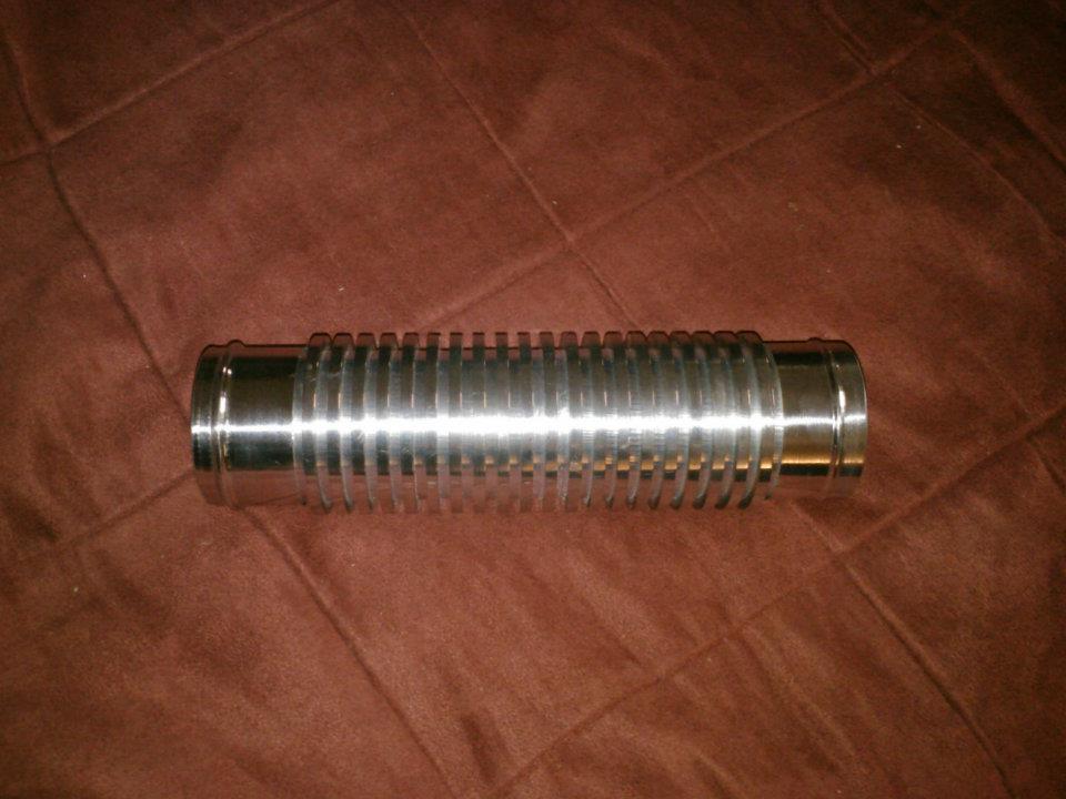

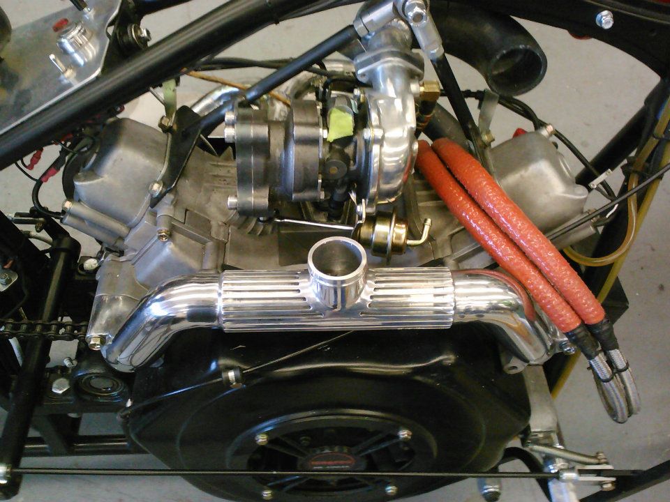

Turbo installation begins
We made up two couplers for the turbo outlet to intake manifold plumbing. I am using 1 1/2" tubing to add about 900cc to the intake volume.

The new intake has been tig welded togeather as well as all the couplers and tubes to go from the turbo outlet on the left side to the intake on the right.

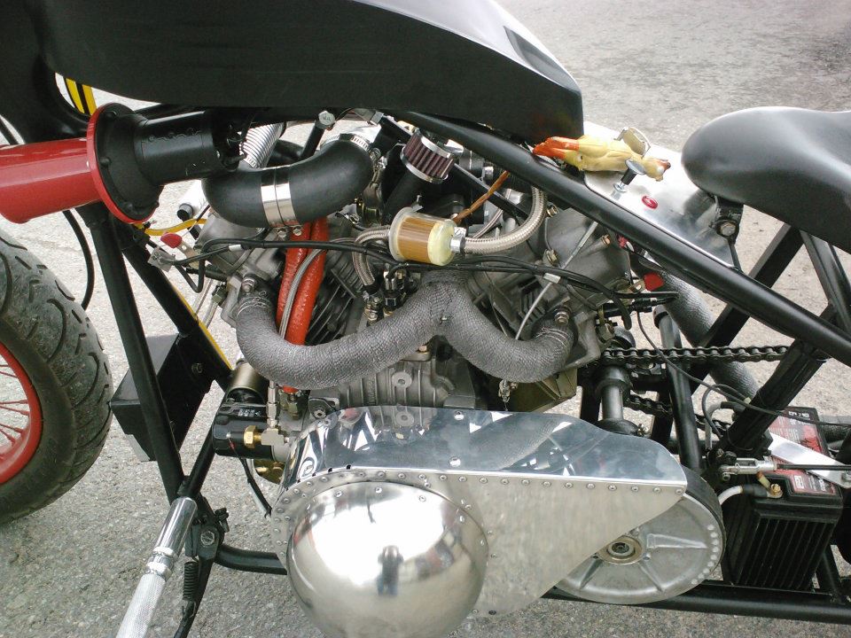

Turbo installation finished
I still have some loose wiring to tie up but its done. I had it out and ran it around the parking lot at work. It seems to pull harder than without the turbo but the real test starts tomorrow when I pay for this years licence sticker. It started to pour rain mixed with wet snow just as I put the bike away but it is forcast to clear tomorrow stay tuned I will update with more info.

CB500T Turbo Punsun Hardtail Bobber
Well after riding my turbo conversion and chasing it with the car I'm pleased so for. Still lets out a black puff till the turbo spools enough and off it goes. The overall noise signature has been reduced both riding and following. and my first peak in the tank after 30 miles of running the piss out of it shows about 1 litre used. Right now my main focus will be on cleaning up from the oil down. Fixing my tailights as the cheap LED's are not very durable and sevaral segments are out again. There is a bike show coming up on the 28th that I want to put the bike in see if I can steal another prize from the over chromed gas (petrol, Benzine) burners.
