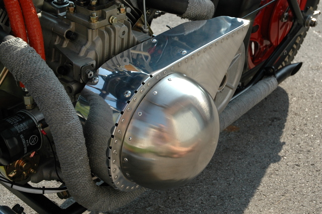

Okay the snow is gone the birds are singing and our bikes are almost done. We still need to design seat mounts, battery mount and fuel tanks. The next step is the paint shop and as luck would have it our school has one of those also. Enjoy the picture

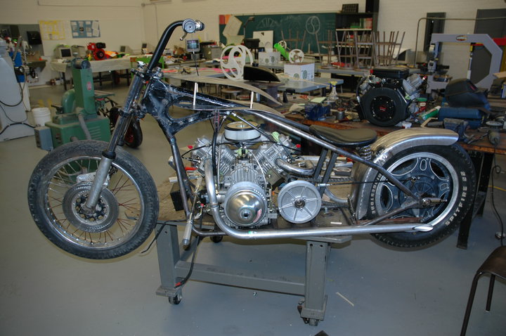

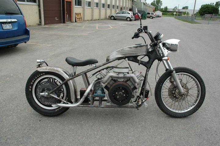

Okay the end is insight. I have finished the fabrication now it's off to the spray booth lucky for me our school also has a complete body shop. I will then bring all of the parts home and do the final assembly and wiring in the garage durning summer holidays. The good part of doing it at home is I get to spill beer on it while working :twisted: . The second bike is about one week behind and My friend will be home from work in Korea for a couple of weeks so we can knock off rest of the fab on his. Our plan is to use spray can for this summers paint ride the bugs out then give them proper paint work over the winter
Dreams of black smoke whirling through my head
Sean
Finished and riding 1975
CB500t Turbo Punsun powered
hardtail.
Posts: 212
Re: Honda cb500T Punsuns
Post by albertaphil »
Looks great! Are you putting the sheet metal back on the engine?
Phil
DieselFly
Posts: 214
Post by DieselFly »
albertaphil wrote:Looks great! Are you putting the sheet metal back on the engine?
Phil
Yes the cover was off getting the big dent from shipping out of the bottom and a cover over the hole where the oil cooler was mounted

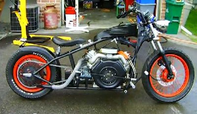

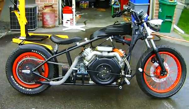

Its alive!! I finally have had some time to get at my bike and do the final assembly. I'm still short a front brake line (on order) and a cover for the CVT which I'm currently working on. I took it for a slow run around the block 25mph the CVTech clutch is very smooth. I should have the MTO inspection done and the plates on next week I hope. I wll get some video of it in motion when it has plates but here is a taste to get you started. http://www.youtube.com/watch?v=MRadb91o-pc
hardtail.
BoxerOtto
Posts: 91
Post by BoxerOtto »
nice job!!! i have the same type of engine kill. GO CANADA!!!!!

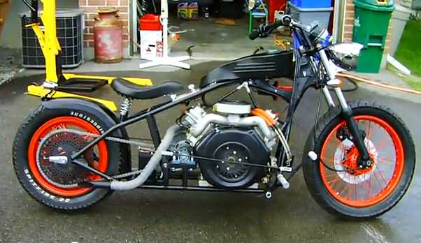

Excellent job there Sean :D I've taken the liberty of tweeting a still of the bike and the video. The bike sounds good too which is important. Should be a real head turner :D
Still from the Video

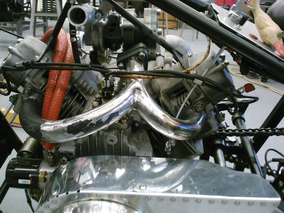

Turbo installation begins
Post by DieselFly »

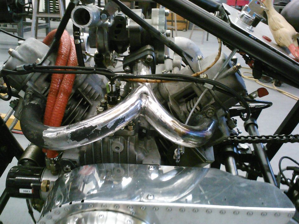

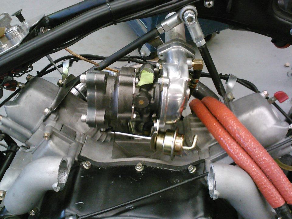

Okay lets go turbo!! I started working on my bike last week. So far the exhaust "Y" pipe into the turbo and the mounts have been completed.
Next is the intake maifold it has been cut in half the compressor outlet is done we are making the new pipe to join the two halves. Just for fun I have the students cutting radial cooling fins with the horizontal milling machine and index head.
We will finish the compressor to intake plumbing then the tail pipe and new custom made stainless muffler then the oil system.
Stay tuned
Sean
