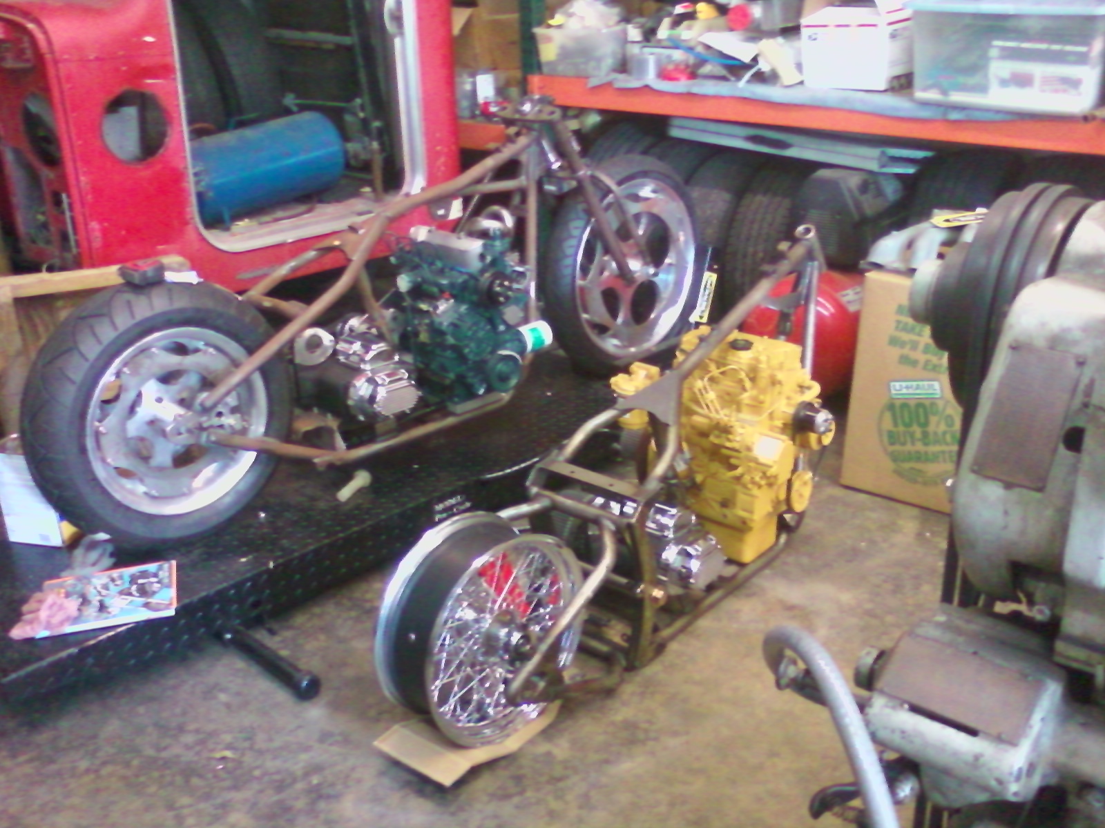

sneak peak at the new diesel bike build

Hey mate, your build here is fantastic, I always look forward to your updates too, really really top end stuff, its gona be awesome
......now get back to work, I want to see it go !

Thanks dougy, ill be done as fast as i can! I have a ton of other work to do other than the bike, so it may be a while.
Next step is to remove crank, and bring the rotating assembly to be balanced. Then comes final assembly! (I hope!)

Respect!!! You rock man! It must be nice to have the skills and machinery to create such a proffessional build.

This looks fascinating. Can't wait to see a video of the final project! I am rooting for you!
