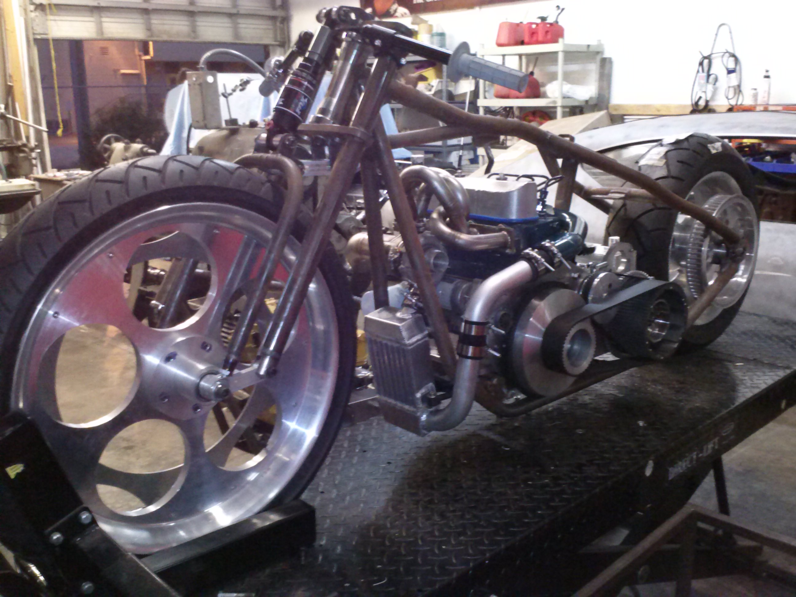

Post by dethmachinefab »
Brought the rolling chassis outside to get a better look. So far engine is complete and mounted, driveline is done, working on dry sump plumbing and turbo header now.

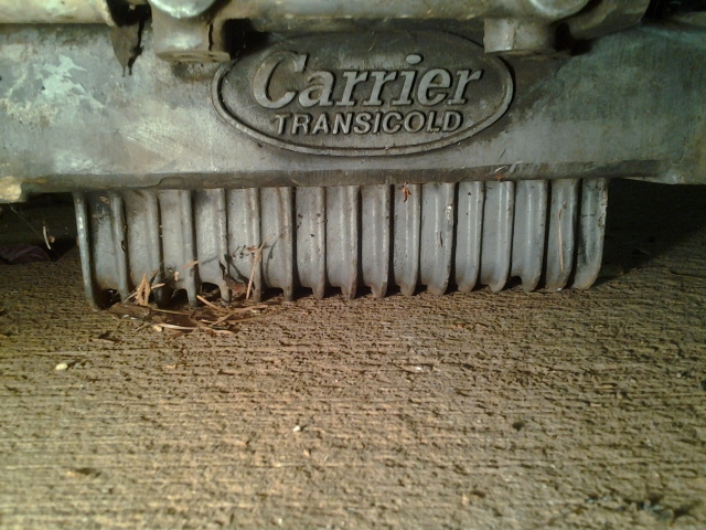

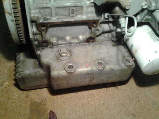

Re: sneak peak at the new diesel bike build
dethmachinefab wrote:Building another 3cyl bike.... .
If you said it in this thread; appologize in advance for not finding it.
What Kubota is that? D722, D902, D???
A tid bit for future if it is a D722. Just discovered there is what appears to be a smaller in height/depth (LOT SMALLER?) but wider alluminum HD oil pan for the D722 engine. It is used by the Carrier/Transicold line of Reefer's powered by the D722. Was told there are engine mounts built into the pan! Might be interesting to cut and splice this thing. Like say a taller section on the sides against the outer portions up against the lower sides of block. If it didn't impede lube that is. Similar; just taller, to what is done on the oil filter side of the attached pics allowing for even less depth in pan?. Most of all this would keep less depth yet wrap the pan around bottom of block reducing width / improving protection in a lay down. Would have to go to remote oil filter .. If it does not make engine moutning impossible.
dethmachinefab
Posts: 62
Joined: Tue Jan 12, 2010 2:37 am
Location: New York
Im using a d1005. I used a similar pan on my old yanmar bike, that came from a thermo king unit. I would be very weary using the mounts in the pan. Certainly not in a rigid mount situation.
Progress may be delayed on this bike for a little bit, have another bike to build.
dethmachinefab wrote:Im using a d1005. I used a similar pan on my old yanmar bike, that came from a thermo king unit. I would be very weary using the mounts in the pan. Certainly not in a rigid mount situation. ...
Sorry do not mean to hijack. If too much pan talk starts here I'll move things out of this thread into a new pan thread.
With that said....... on the previouse built bike w/Yanmar/TKing pan..... did it shorten the height of the whole engine much compared to stock pan? how much you guess?
On this thread's bike; looking at the thickiness of the material you used for your dry sump belly pan and its additional plumbing, how much additional engine height reduction did you gain going that route compared to going with something like a wider TKing/Carrier like pan?

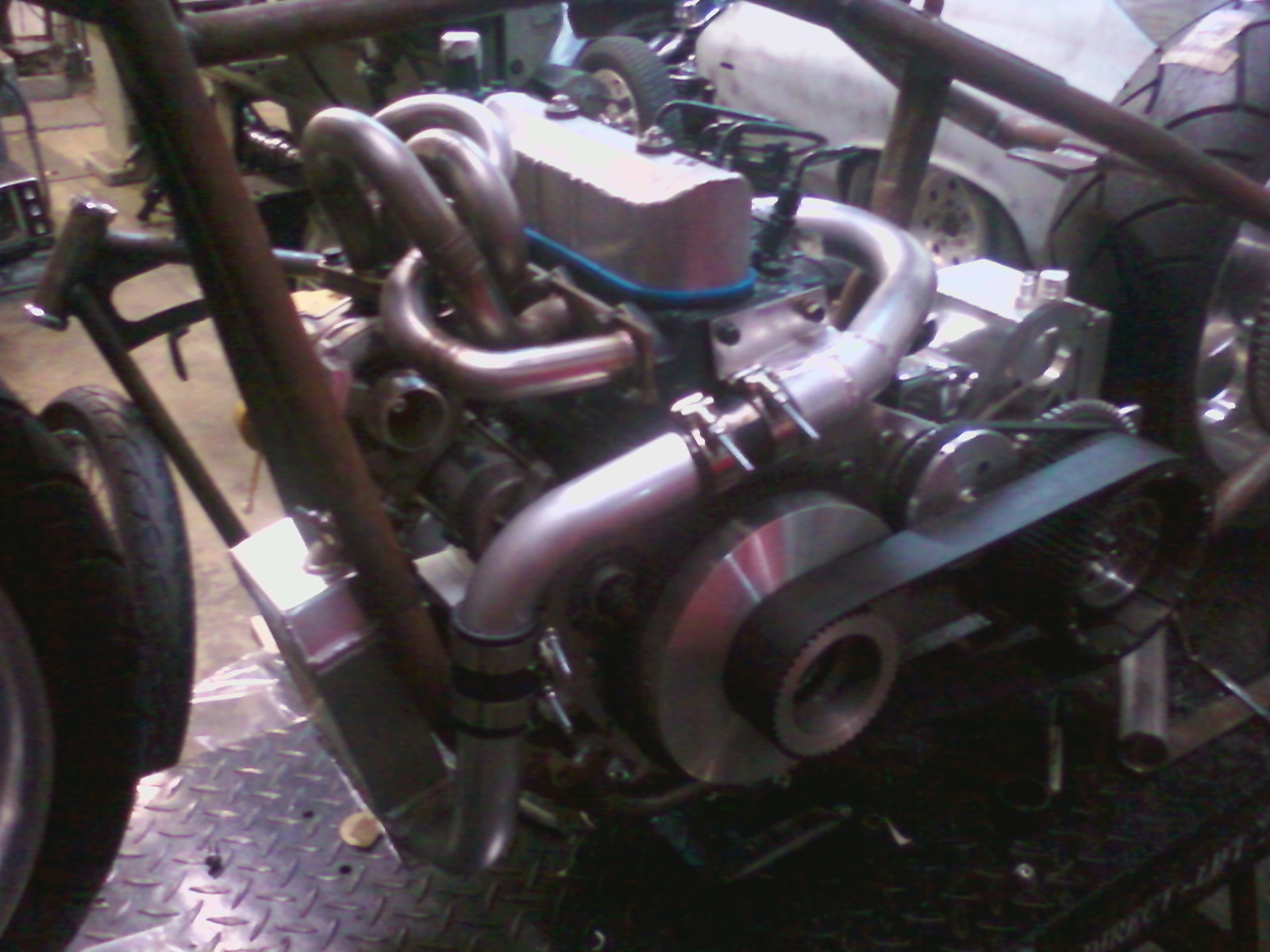

Worked on some charge air cooling and intake piping today.

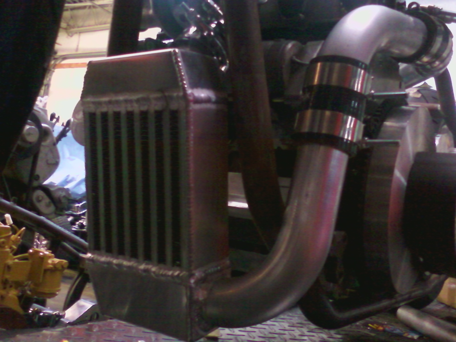

Worked on the charge air cooler mounts and some exhaust.

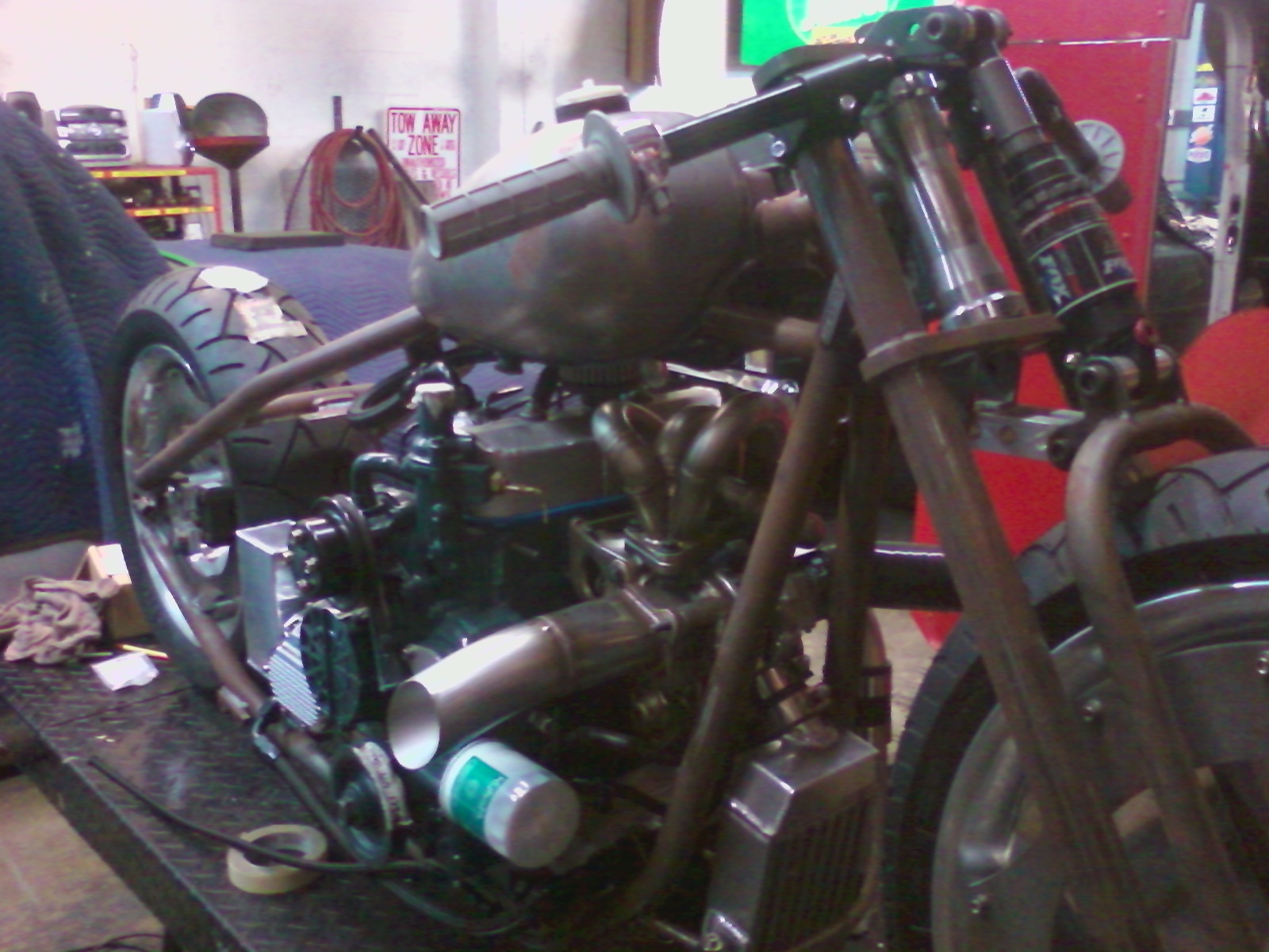

Not much progress on this, i have been busy with other work and some real estate stuff.
Fuel tank and oil tank are done, some plumbing, and crankcase vent done.
