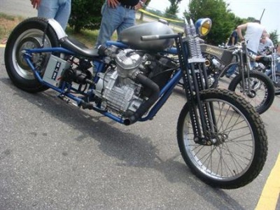

I absolutely love the idea of the left side shaft drive mated to a right side divorceable BMW tranny output. Could possibly only add a couple inches to the length. Would the motor have to turn clockwise? (looking at the rear)? Another interesting aspect of those pictures is the 90 degree gearing box. That opens a lot of options for final gearing, and eliminates altogether the need for a shaft drive. I just don't know where to find one of those little gems.

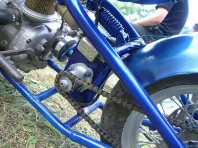

One of the benefits of using a HD/Baker/chopper style transmission is that it's so narrow. Not the mass of the transmission, but the input and output gears are sandwiched together. Even on the same shaft! If the primary drive were chain, and the transmission to shaft was chain as well, the length would be minimal. As I keep thinking about this, I'm amazed that I lucked out on the torque direction on the transmission. I hadn't thought about that until now. Maybe it's not an issue with the transmission, I'm sure the clutch and gears can handle reverse torque just fine. Just like engine braking torque.
These examples are most likely for more show than go. And I would imagine the chain slap is pretty annoying without a tensioner? maybe not. But the net length of the transmission could be less than 6 inches. It looks like (from pictures) the BMW bell housing + transmission + sprockets to shaft drive would be 17+ inches? With less length used by the transmission, there's more room for a motor. Or more room to fit a motor, as in putting the motor further back in the frame.
