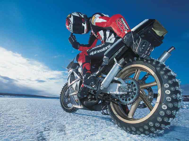

sno-bro wrote:... Putting on some final touches today, like trying to get the front brake to do something. :D ... sno-bro
wellllll... their just brakes LOL.
One of the few times ever saw an on the ice motorcycle race (on TV) there was this fellow who lead the whole race and the commentators were remarking often how gritty and amazing his fast cornering was in this particular race.... especially since this was not his normal style. He did win that heat.
After the race they asked him what made things different for him. He replied.... "my brakes failed in the first lap"
PS- these bikes have nasty looking spikes on their tires
