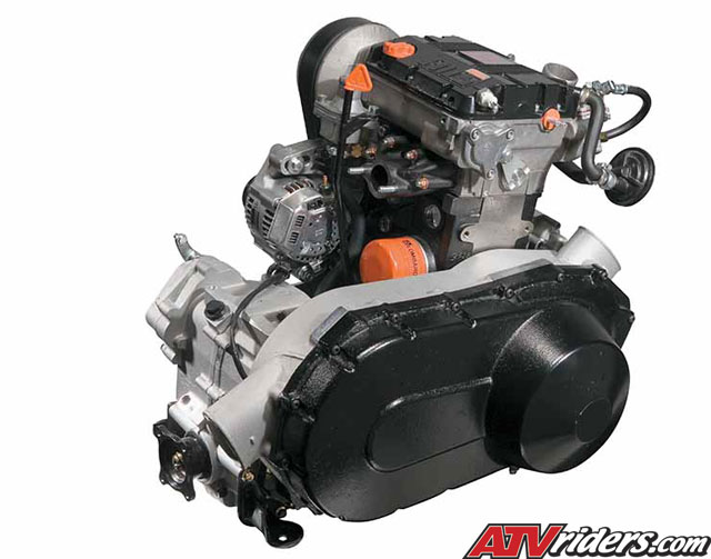

It might be better(cheaper) to see if there are any Chinese built Daihatsu charade or other small ex Japanese diesel car engines available??
What about diesel quad engines/transmissions?? These would be excellent for bike conversions. Most of these are made in China.
I don't think you are going to get an engine suitable for both light trail types and cruisers. The only bike that comes close are the BMW flat twins.
This is the Arctic cat 700cc and according to the information runs on all sorts of bio diesel etc??
Re: What is your dream bike? USA company needs your input
I looked at this pic again and I realised it's a lombardini engine so this particular one may be out of the question on cost grounds but there must be more out there?? You get the idea anyway. It wouldn't take much to modify it for bike use. Find something in China and import the engines in bulk and get a locally made frame etc.

gilburton wrote:...What about diesel quad engines/transmissions?? These would be excellent for bike conversions. Most of these are made in China.
...This is the Arctic cat 700cc and according to the information runs on all sorts of bio diesel etc??
Came across this in a re-read of this thread. I may be mistaken but recent search seems to show the Lombardini/Acrtic Cat arrangment "diesel" is ONLY one out there for an ATV with east west engine placement orientation. Notice the yoke on the lombardini CVT points out that it is also Shaft drive so somewhere in that transmision is a right angle.
Seems all other diesels in this market are put in side by side RTV or UTV's w/without 4x4 and have shaft drive. The engine sits in these ?TV's at a North South orientation with CVT to the rear basicall like the Track Bike arrangement. Fine for shaft bikes. Won't work for chain bikes. They appear to be rather wide too at around 25" from recent conversation I had on a 3cyl yanmar powered UTV (Polaris)
Interestingly though this 700cc was the reccomended power unit for a motorcycle when I was speaking directly with Kohler/Lombardini
