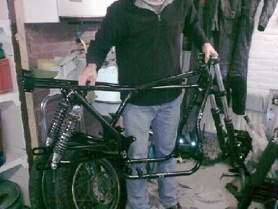

Even your daughter is helping, man you are a lucky bastard.
Good thing you keep them satisfied with the leg of lamb isnt it

hi there, its been a while
the frame is at the powdercoater, in the meanwhile we tought lets do it even better and bought a paioli fork, brembo caliper, koni rears and akront wheels.

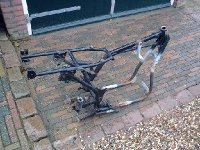

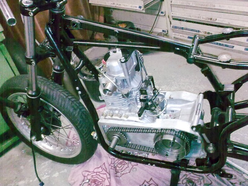

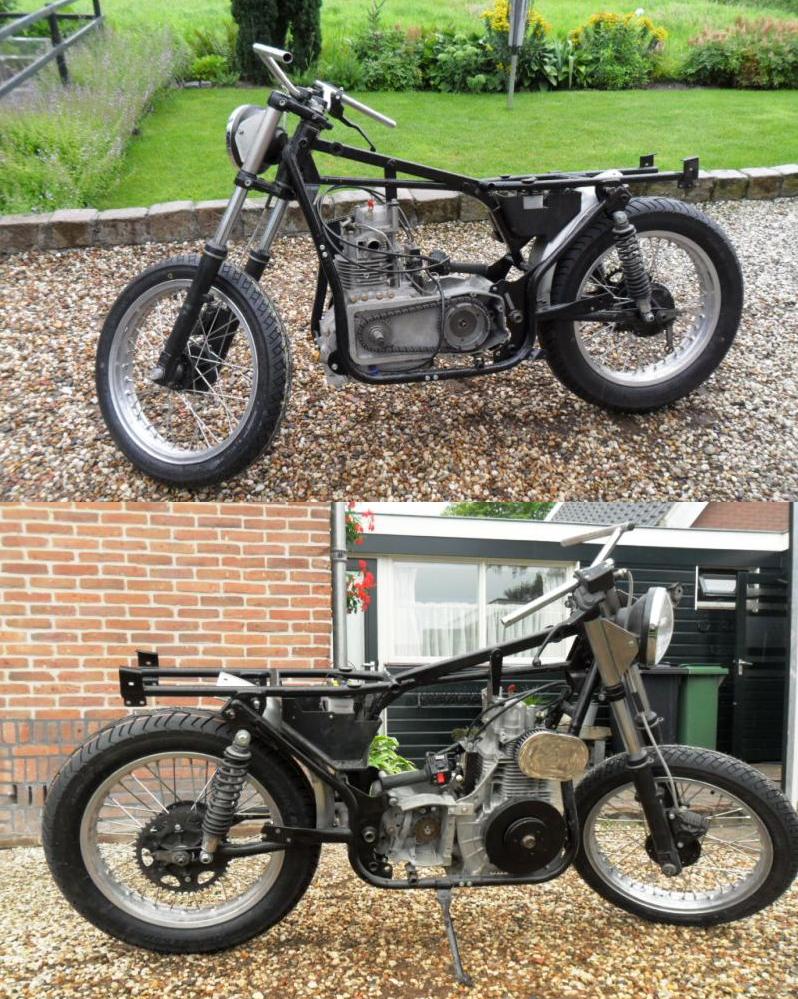

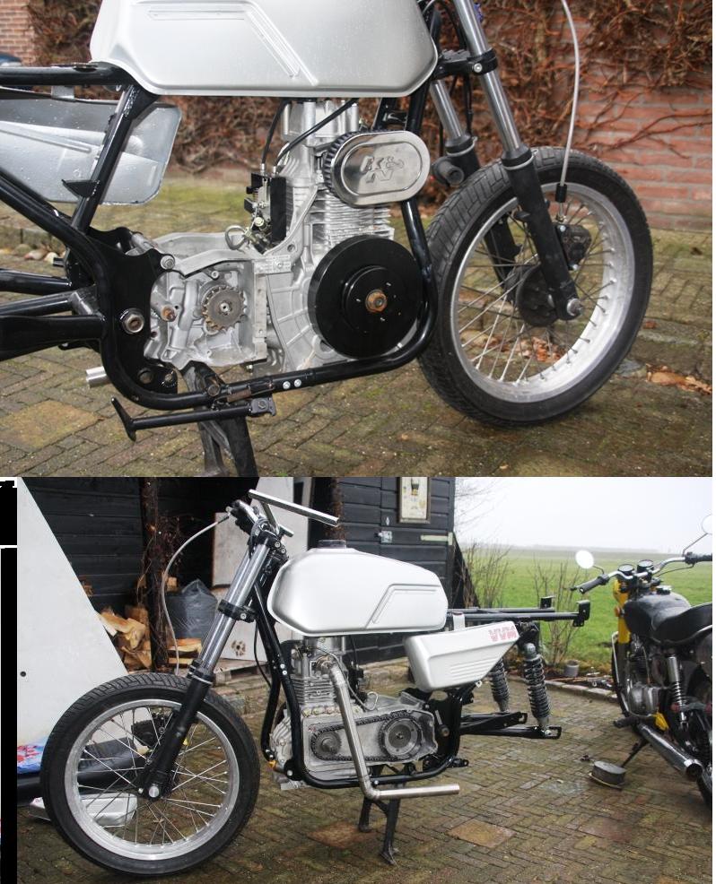

here's the frame before corund blasting/powdercoating; and after, with the new suspension parts fitted;

And as the bike is being built so is Vincent's excitement!
Looks very good!!
Looks very good!!

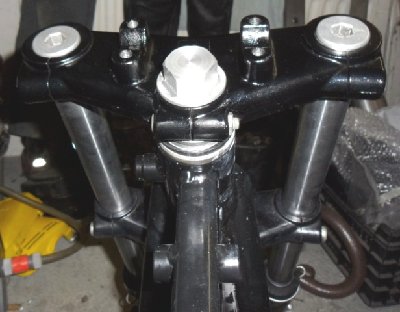

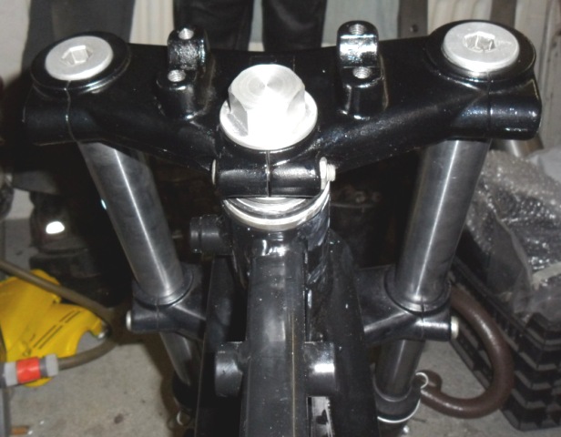

Here's the top nut, custom made by boutje as well as the rod underneath. In order to make the paioli fit to the Jawa frame.

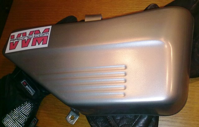

Currently i'm spray painting all the bodywork. Expect some pics soon.
Color will be motip 55330.

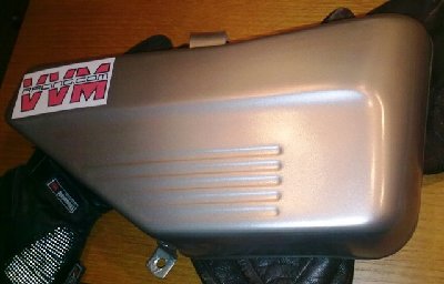

stickered before clear coat.

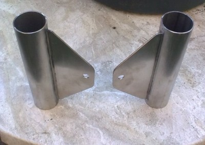

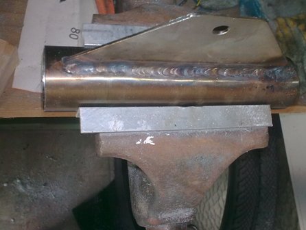

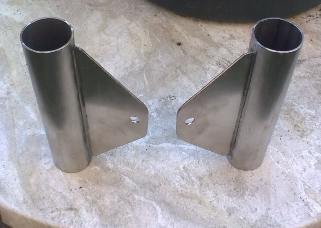

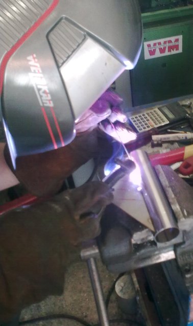

today was -as wel call them- 'headlamp ear' day.
Jeroen doing the welding; pretty nice weld i must say. after some more labour with four kinds of grinders & acid.

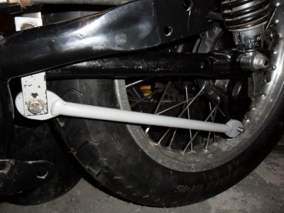

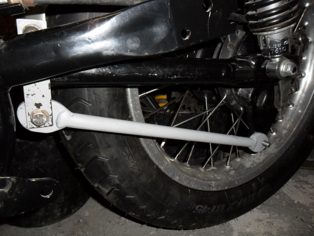

currently we are trying to assemble/machine the original ''brake anker''(?) onto the kawa 250 rearhub.
boutje fitted a ducati 916 hollow rear axle.
the diesel is on its final set of legs. freshly spoked -front- wheel needed extra care, thanks for the wobble haan wheels (er zat een slag in)
New BT45 dual compound tires. Yes, this bike will need to go full throttle always and everywhere (also in the corners).

Here we see the rear brake ''anker'' (rod).
First time uploaded, straight from the VVMracing.com workshop
