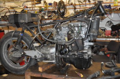

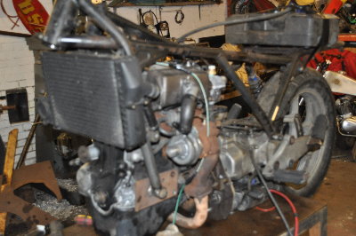

hi been going to build a diesel bike for years,bought a rolling bmw k100 chassis with gearbox,found a engine on ebay,got them both home,then moved into workshop so the wife said.any way got engine ontobox and in frame and running,would like to know if the k100 tank and seat will fit as i dont have these,dont want to buy them and find they dont fit can anyone help

looking good there!!!
having had a standard K100, my guess is that the seat will fit with no problems.... and probably the tank too... I'd like to see the other side before giving a more definate assessment......
But remember, K tanks are ally..so not as bash-able as steel ones!
