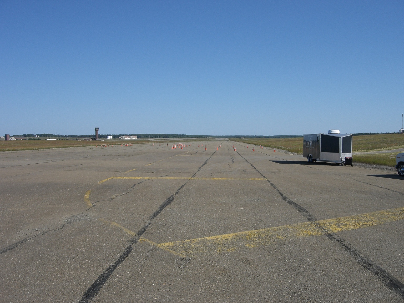

As a side note, I've just come back from the Loring Timing Association in Maine, USA. This bike now holds the speed record for its class (350 cc, alternate fuel). I was able to hit 56.5 mph with a lower gear ratio and a few dozen improvements. I will post images of it as soon as i get them ( was too busy fixing and racing to take photos, my friend who came needs to give me copies)
