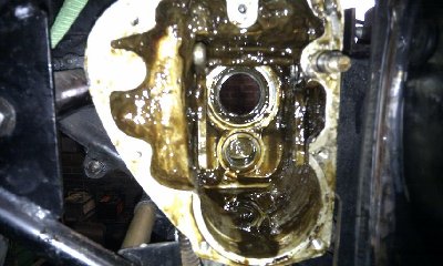

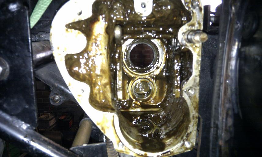

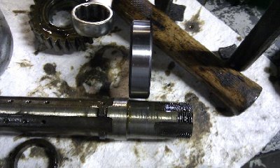

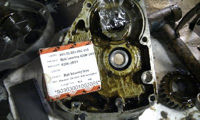

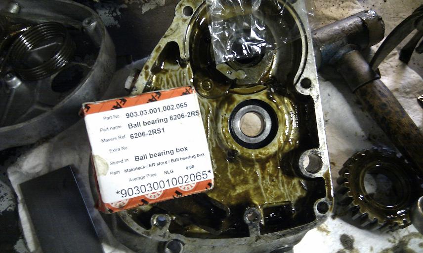

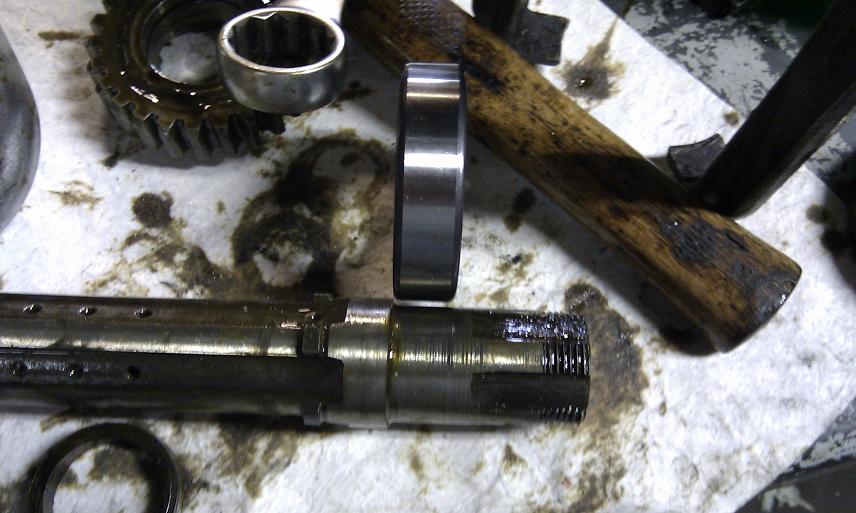

It was time to upgrade the bearings in the gearbox. The stock bearings made faint grinding noises, probably due to metal grit. The replacements are closed bearings. Anyway, pics!
Patient on the table. Gutted...
Gear operator and an oil seal hiding inside, attempting to look innocent. The smell emanating from your monitor is indeed elephant sh*t. :roll:
One bearing in, the other waiting in its box for the "skilled" mechanic to fit it in place of its Indian cousin.
Much to my surprise, my 1992 Bullet was already fitted with an improved main shaft sleeve.
Reassembly tomorrow.

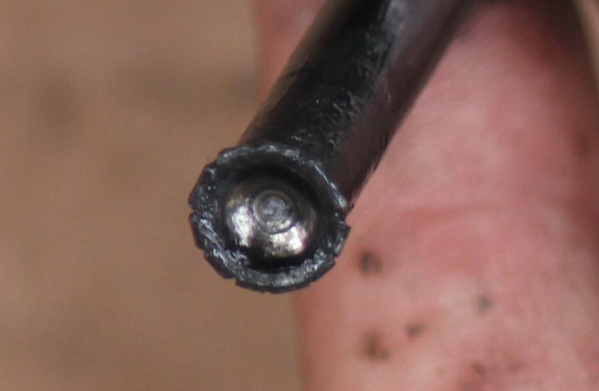

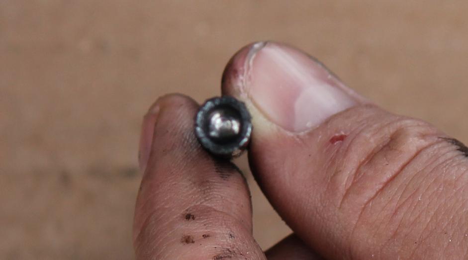

Oh dear :? I needed a new piece of clutch rod on the Ruggerfield (on fitting the new clutch) and luckily found a Pozi drive screwdriver of the right dia. Obviously it was hardened metal and has lasted well. Bit tricky sticking the ball bearing in the end with that hi-temp grease though :D
Re: Hatz Enfield build
Yeah shifting gear has become a bit tricky :D I think I will just try to get some 6mm rod trim it and heat the tips with propane and douse it with water. Hope that works out.

Tip:
Take a piece of silver steel rod.
Is very easy to machine.
And you can also harden it with a flame and cooling down in oil.
Next you heat it up again and let it cooling down slowly.
The outside is very hard (around 60 HRC)
The inside is still a bit flexible , so the rod will not break.
Thanks, Nanko already made sure I wouldn't obtain crap :) I'll give Kokkelink a ring tomorrow to see if they have any. I know I should douse it in oil, but I don't have any left on shelf, next oil change of my car I'll see about keeping it ;)

Water is also ok.
Silver steel is not a exotic material , so getting it will not be problem.
Good luck with the fix. 8)
Welp. I trimmed a piece silver steel to size, then used a file to take of material until the rod fitted. Apparently the rod should portrude 5-7mm, so I started with 10 and kept checking. Once I was satisfied I used the mother of all oven gloves to heat it to bright red on the stove and doused in oil I put in an empty Red Bull can. This is roughly 225ml of oil and in my opinion not enough, especially since you need to cool it twice.
Also, I should inform you that the WAF of this activity is subzero. You will notice noise indicating dismay from the living room. Currently my newly tempered treasure is in the oven at 250 Celsius for an hour because that's what the internet says I should do. We'll see :)

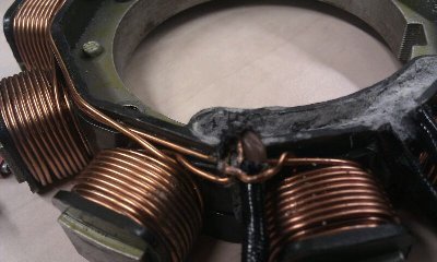

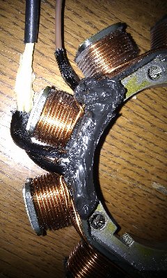

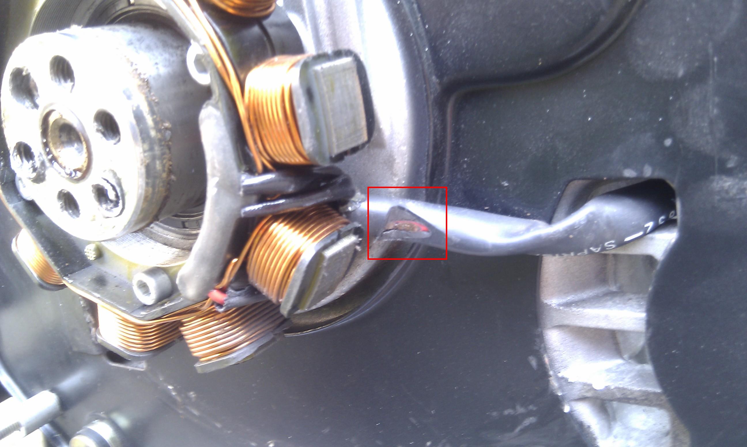

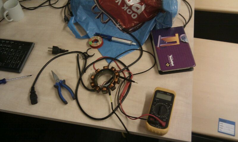

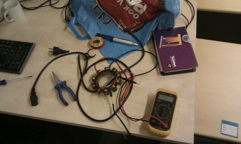

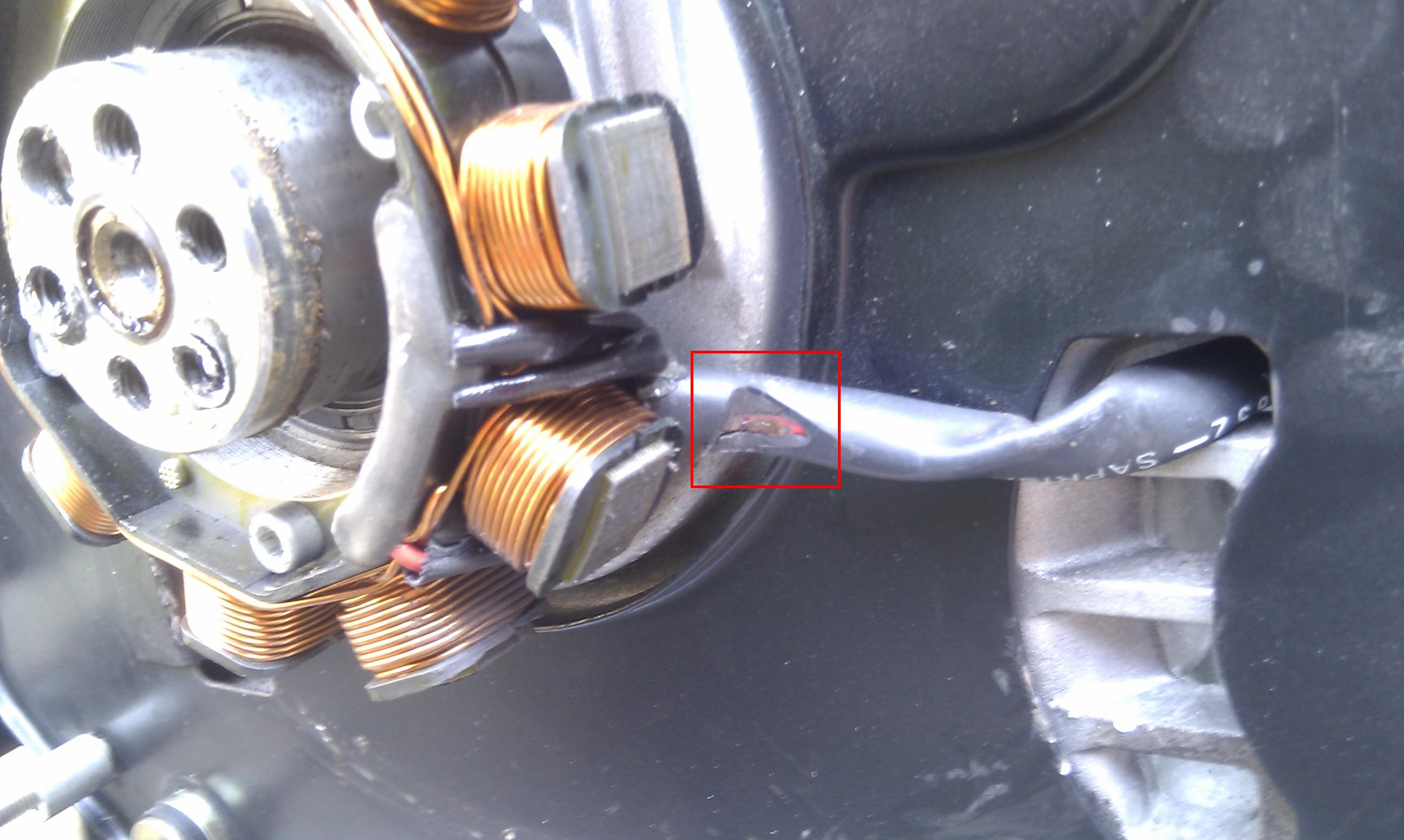

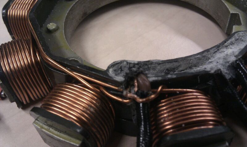

I had a small rattling problem with the Enfield that required removing the flywheel. After I found some loose metal causing mishap I also noticed the stator was stuk between a rotor and a hard place :evil:
Some surgery was required... sorry for the crappy pic.
The finished product, measuring ~1Ohm on the leads. Hope it works!
Just top it off with some goo of Het Gele Merk (it's like Sicaflex)

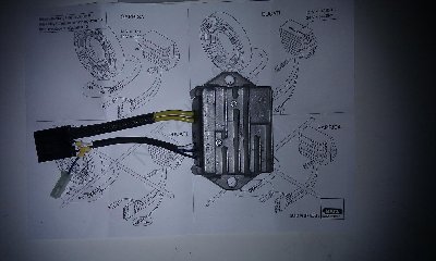

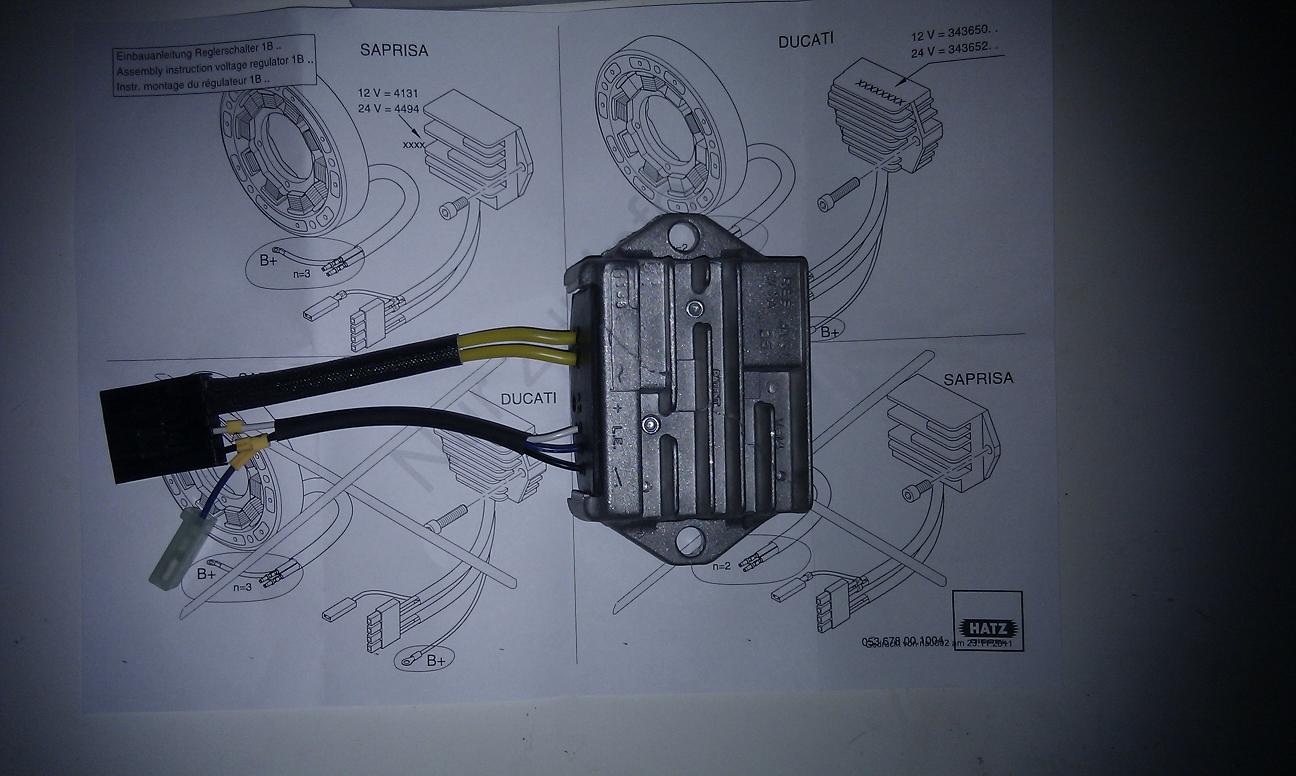

And finally a regulator from Hatz. According to the paper that comes with it they also make a DUCATI version. I suppose that is intended for turbodiesel 1B40s :mrgreen:

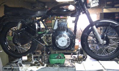

I love the side on pic mate, and congrats on getting through all the red tape and registed :) did the electrics fix turn out ok ?

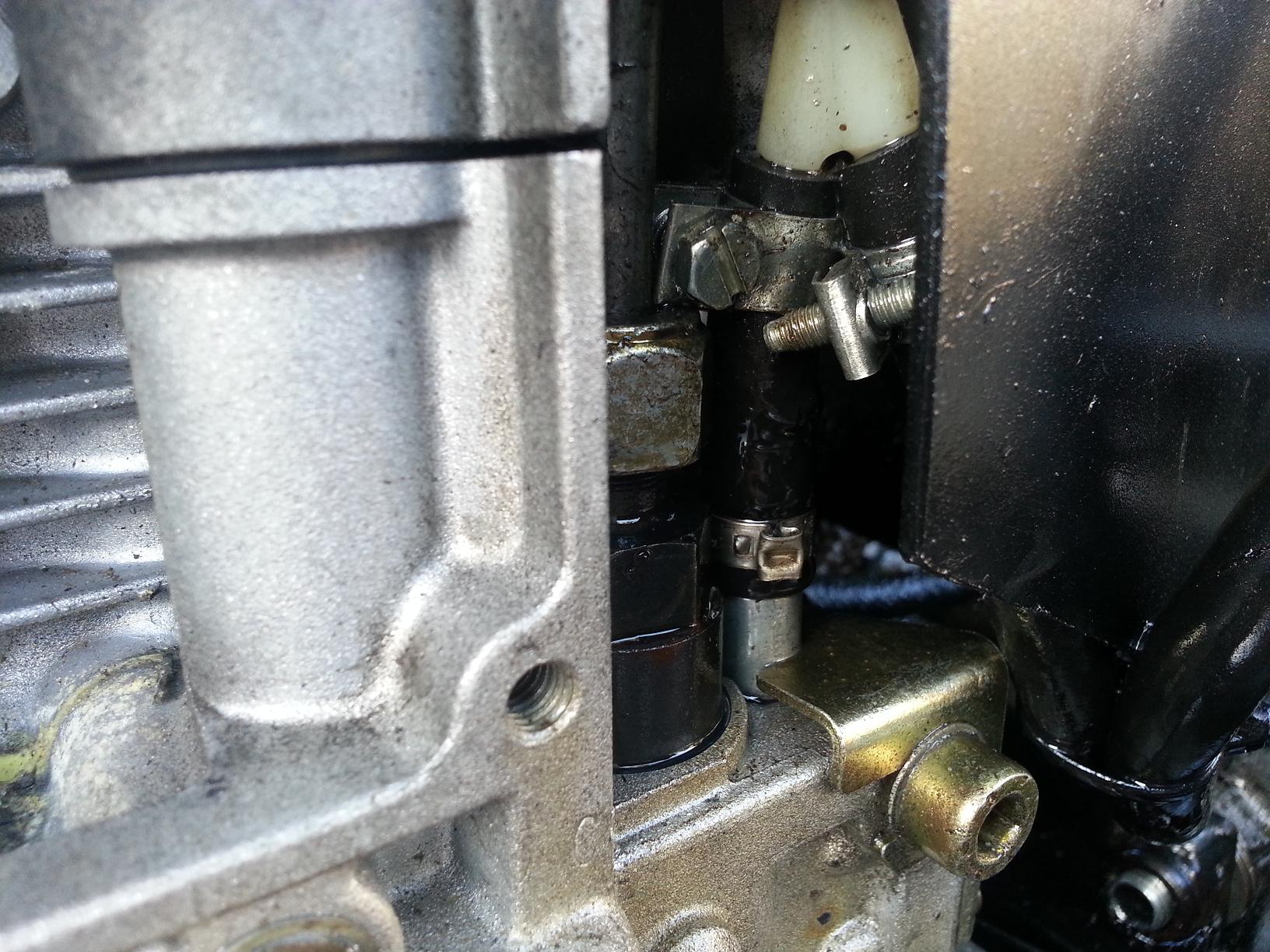

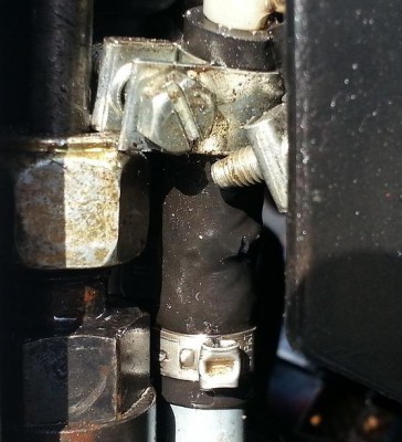

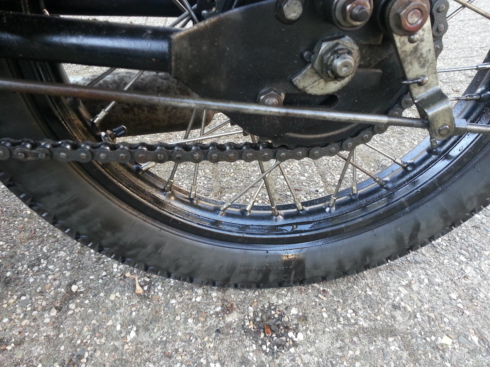

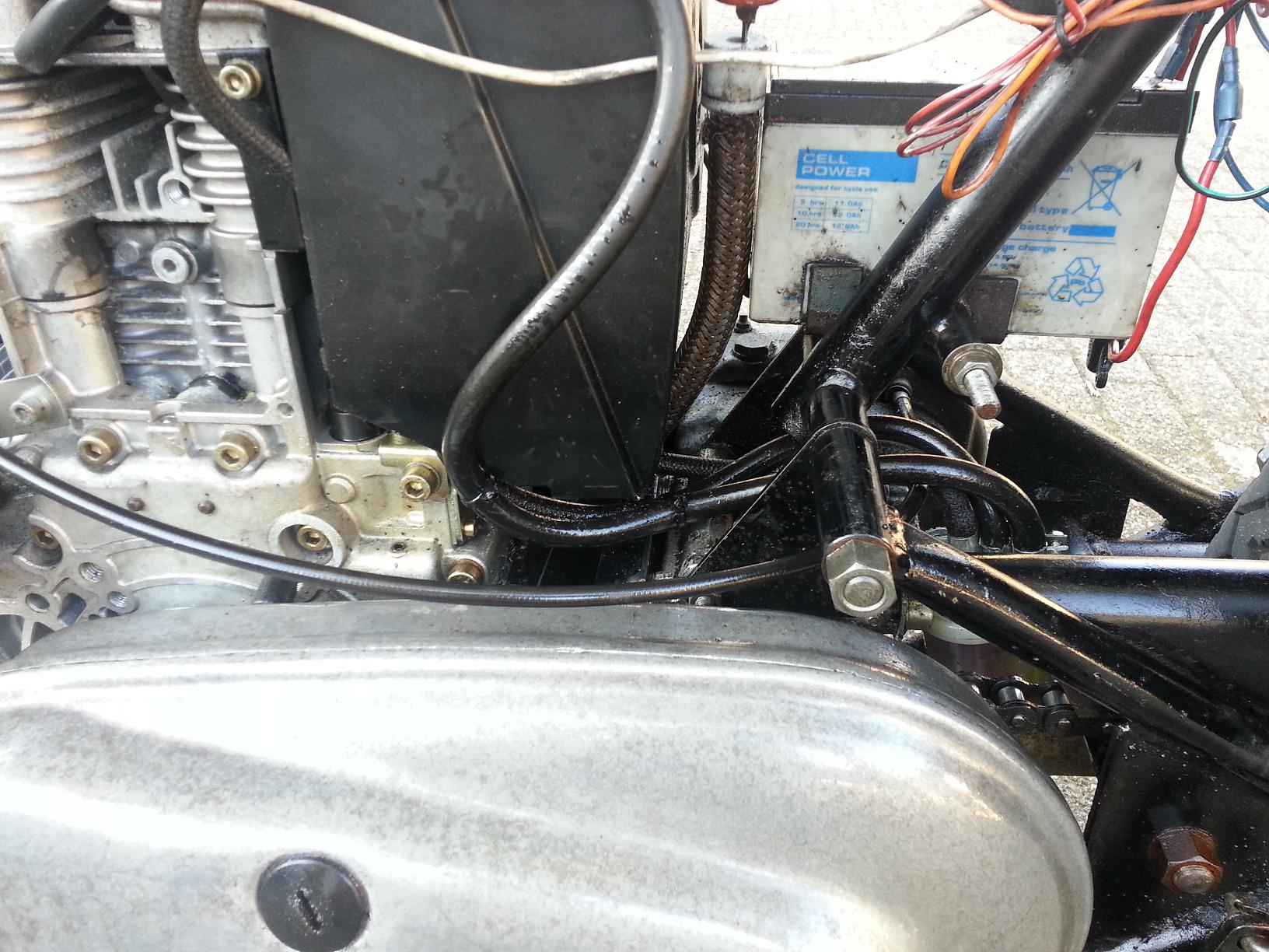

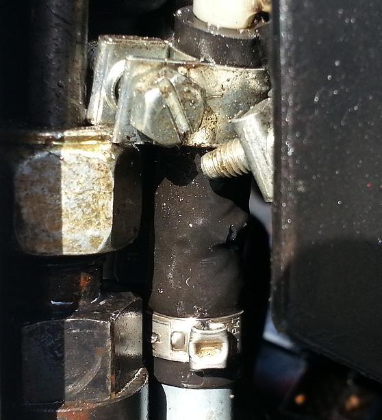

Just stopped at a traffic light close to home and noticed my left foot was slipping off the peg. I feared a primary case leak, but unfortunately there is diesel ALL OVER EVERYTHING. I have taken some pictures, I will upload them shortly, but there is a nice puddle on the rim of the back wheel as well. Blargh. Very bad timing.

Oh dear, that could have been dangerous! Where is the leak from, its hard to tell from the pictures.
I haven't had time to take a peek yet, hopefully this weekend. Preferably a stretch of fuel line, but that would not be in accordance with my luck.
Hopefully its nothing major, doesn't look it.
Healthy dose of brake cleaner will sort that out :)
Welp. No brake cleaner was necessary, it squirts right out really. Unfortunately it is in a piece of Hatz hose and not in a piece of hose I put it. It has an annoying little clamp at the bottom, so I can't replace it atm. I do have some ABA clamps, but they are twice as high (see one in the pic for reference). I suppose I mounted it all under too much strain and in the end it ruptured.
