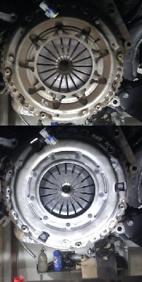

Oh, btw, here's a nice picture of what bearing failure will do for you clutch. Roughly 300000 km clocked. Get it RIGHT the first time Mouse :D
