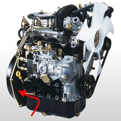

Re: Engine mountings
Plate shown in pic.
If no bellhousing used then plate would need to be significantly thicker to hold weight of engine. With bell housing it would be stronger thus you might could go thinner.

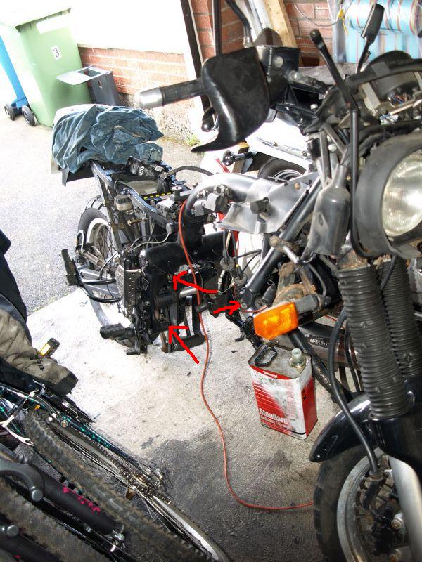

Guess we'll find out what happens this weekend. I just got some spacers made up today although I think the bottom ones are about 2 mm too long. Would appreciate if you have any measurements on the length of the rear lugs on the standard engine. Either they are a bit too long or I need to bash them into place
Ho hum.
Heres a pic of the bike with engine out. Mounts are highlighted and same on the other side.
