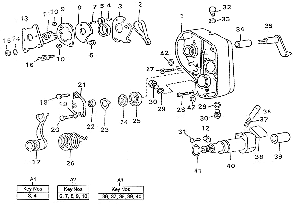

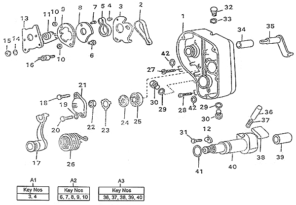

Enfield 4 Speeders - Kickstarter Pawl Replacement
Re: Enfield 4 Speeders - Kickstarter Pawl Replacement
Parts:
36 140332 Plunger, Pawl
38 140333/B Pawl (Sintered)
I will add the other parts as I can make them out. Haven't found pics of tools yet.
http://www.jainenfield.com/cat/gears.html
